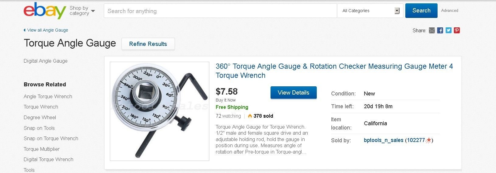

4. Then tighten the bolts again using a Torque Angle Gauge an additional 180 degrees. See video.
