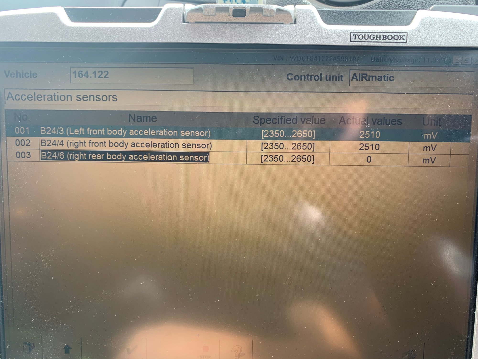

I’ve got some trouble to located rear body acceleration sensor on my 2010 ml350
does anyone has any experience with this sensor
That’s what comes up on my MB C6 SCANNER but I can’t find it
I’ve got this but not much help as behind panels is lots of things n can’t find it
THANK YOU

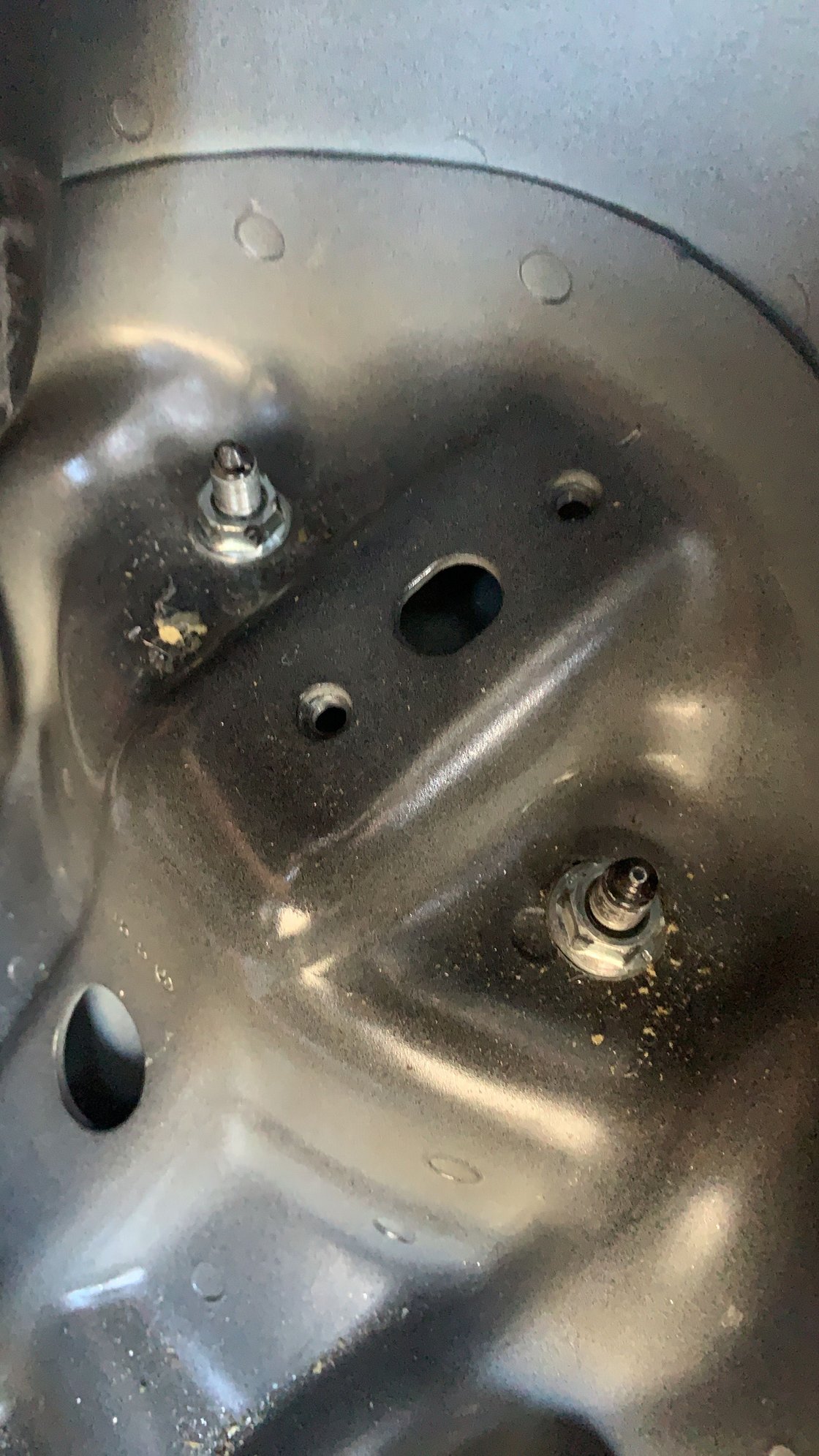

I’ve got a sense but seems like holes doesn’t fit or wrong sensor
anyone has any idea of this?

You bought the front sensor. The highlighted sensor is the one you must order.

I'm just going to throw it out there, your car doesn't have a rear sensor from factory.
No idea what happens if you try to install one.
The thing that confuses me, you have access to xentry/das, so why don't you use the the EPC with your VIN? It will tell you the part number (in your case it'll be greyed out because you don't have one).
