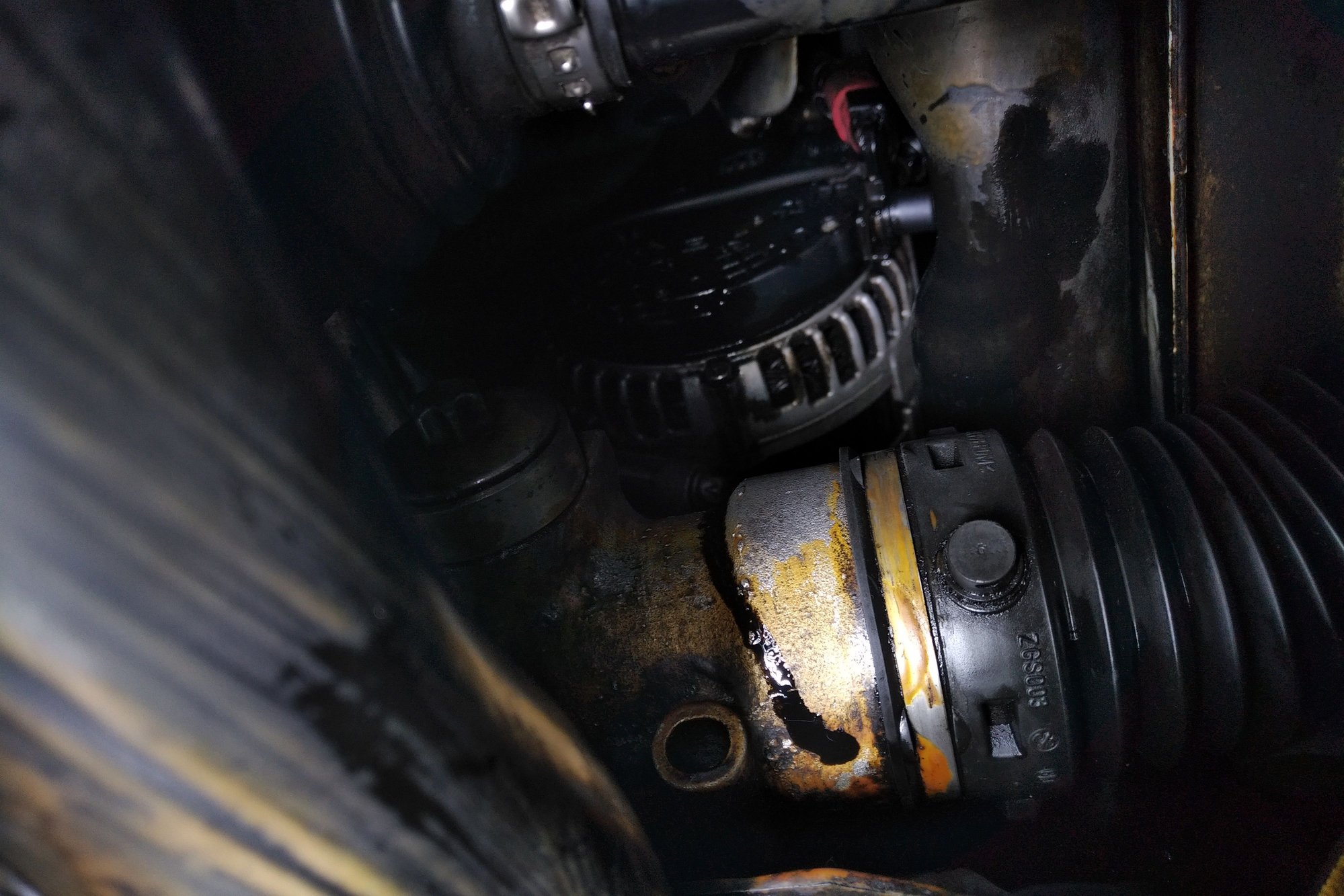

I have looked through quite a few forums and there is alot of great stuff about the dreaded oil cooler. But I'm still confused why the oil has been sprayed around the engine compartment with such vigor in my case. I hope someone can still answer that for me and tell me where I'm leaking from. I now think I have multiple leaks. I cleaned everything down quite thoroughly, topped up with a bit of fresh oil, and went for a drive. There were several spots of leak when I crawled back under which I cleaned up a second time thinking it might have shaken loose from some hiding spots after warming up and vibrating about. But after a second 10-15 minute run about I put it up on stands again and found oil in the same (several) locations.
Pics:
beads of oil appear at the notch about 10 seconds after wiping clean (while running).
What is this black canister piece anyway?
And from above dripping onto and past the alternator.
wtf?

You have found one or some of your leaks, if they are actively seeping/weeping/sweating/leaking.
Do more investigation and cleaning until you positively identify all leaks. Then you can create a game plan to address them.
One option for the game plan should be to sell the vehicle.
