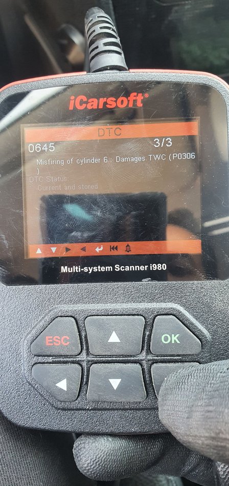

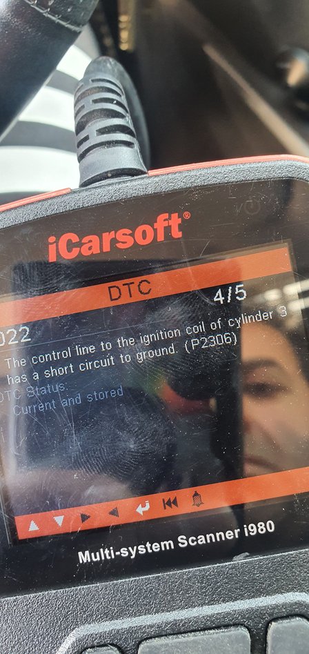

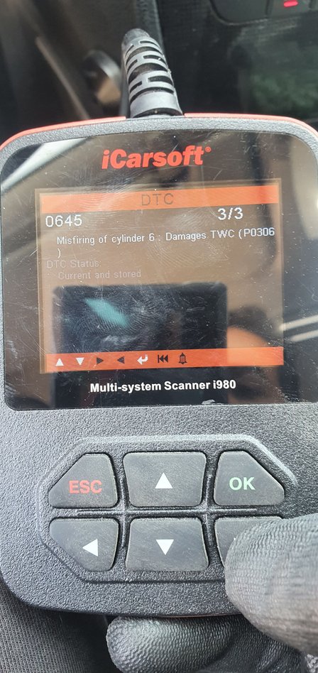

Hi ihave problem Misfiring after kick down
I push my paddle to kick down and my car start rattle and check engine light came,
I riplace coil and riplace sparck plug on 3+6 and the problem Stayed the same help please,

The first code cannot be fully seen XX22.

The mechanic think its engine ecu need to replace, is checked from ecu wire that go to injection 3+6
And its not get Pulses of minus that makes them work,
In the others injector is see pulses minus
What do you think
