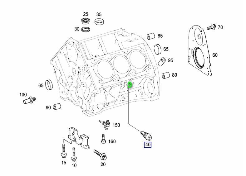

Either stick with the Yellow which is Zerex G-05 or G48 if you want to go with the Blue you would have to drain the entire eng. which also calls for draining both sides of the bottom of the engine block.

Do you have the link on how to replace the thermostat and on how to drain, flush and fill with new engine coolant on this SUV? Hope these are not hard to do. Thank you again.

Here is what I have.
