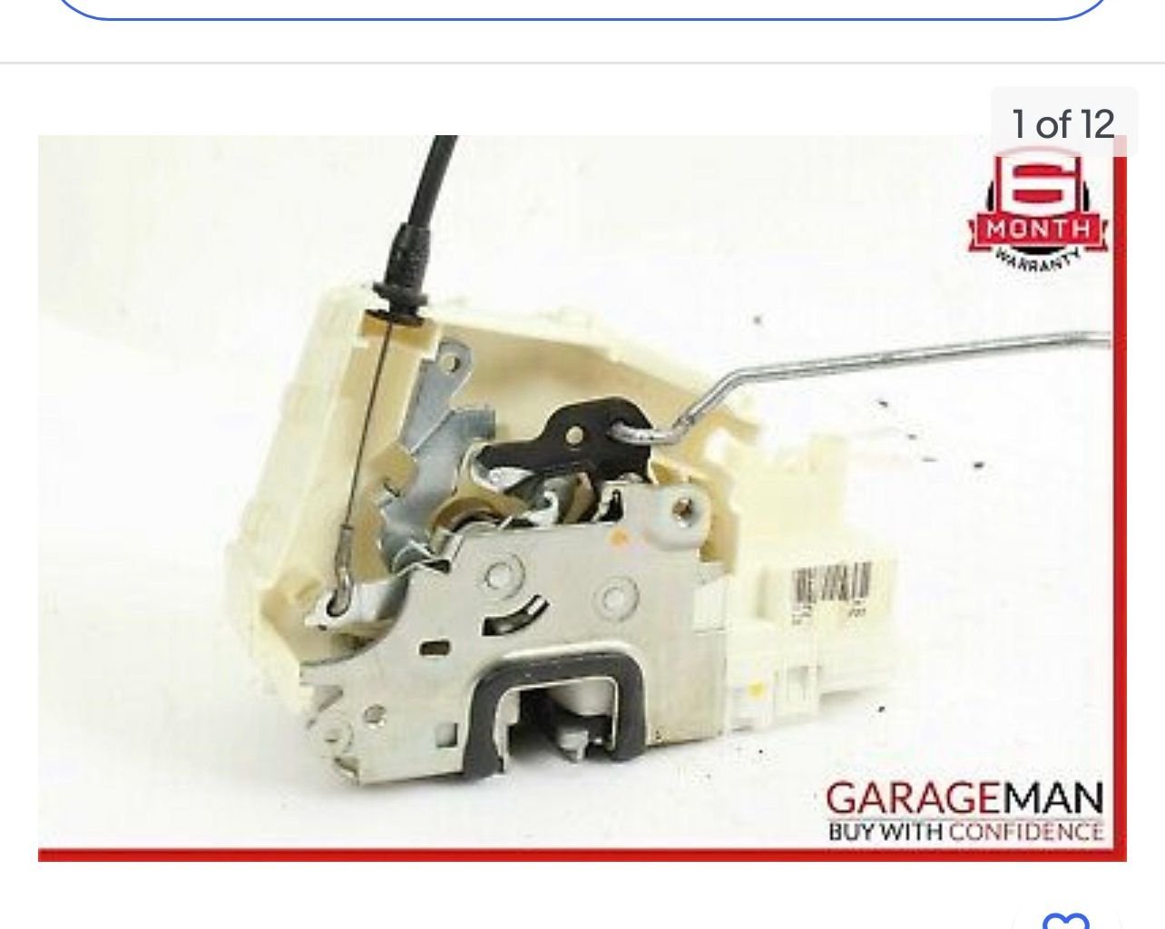

Where does the bottom of the rod attach in the assembly?
Hello, thank you for the procedure instructions. My only remaining question is, where does the rod actually attach in the assembly? Is this picture correct? Thank you for your help!

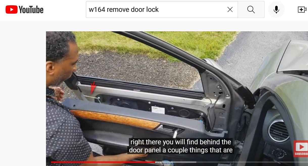

I'm not too sure, but I would say it is attached horizontally as in the the photo.
Youtube video.
Yes it is horizontal.
