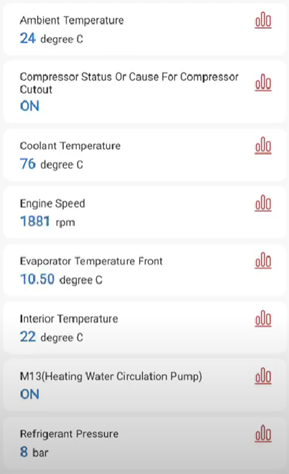

Car Started . A/C closed. Ref. pressure 8.5bar. Evap temp 23degree

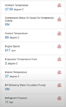

60sec after a/c on. Evaporator temprature is 2degree and its really cold. Ref. Pressure 11bar

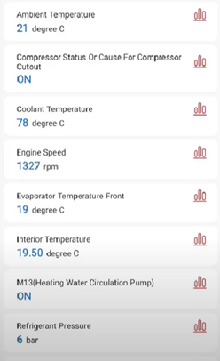

Driving car pressure will down / temprature will hotter still gives cold air but not as idle.
driving. pressure will down 6bar. no more cold air.

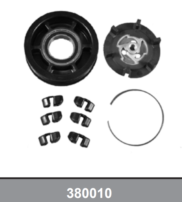

I think I found the problem, the air conditioner did not work at all for the last 2 days and yesterday, while driving on the road, there was a cracking noise from the engine.
I opened the hood and there were pieces on the crankcase protector. When I paid attention, I realized that the part was the air conditioner clutch.When I searched the internet, I was sure it was the part.
I'm going to buy a new A/C clutch. However, I couldn't find any clear information about the replace.
Can the clutch be changed while the compressor is on the vehicle?
Do i need to evacuate the air conditioner freon r134?
Do i need special assembly experience?
New Clutch set - NRF380010

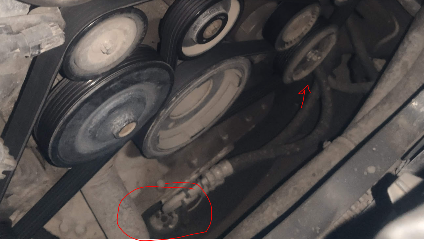

Today, I went to the repair shop to replace the steering hose and I saw that the air conditioner power line was a single cable and was slightly damaged. There was no electrician in the repair shop.
is it normal that there is only one cable entering the air conditioner? Maybe that's why the problem is.
