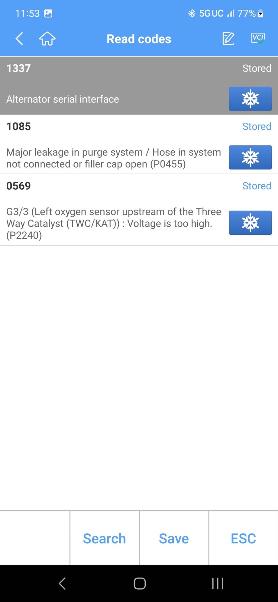

Got the scanner. Lot of codes stored, but not current. most due to low battery voltage.
Cleared the codes and only rear lift gate code remained.
These are the stored engine codes, no transmission codes.
