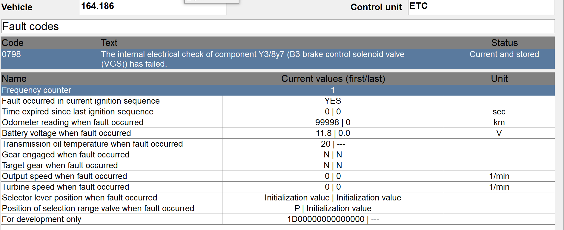

I have a w164 2006 ml350 4matic with the 722.9. About a week ago, I got a check engine light and the code using xentry showed that it was "0798 - The internal electrical check of component Y3/8y7 (B3 Brake Solenoid (VGS) has failed."
At which point the car slams into reverse and drive from park and stays in limp mode.
I did drop the pan, swap out the solenoid and cleared the transmission codes using iCarSoft v3.0. However, every time I cycle the keys, the code comes back so I imagine it's doing the check when the key goes from off to on.
