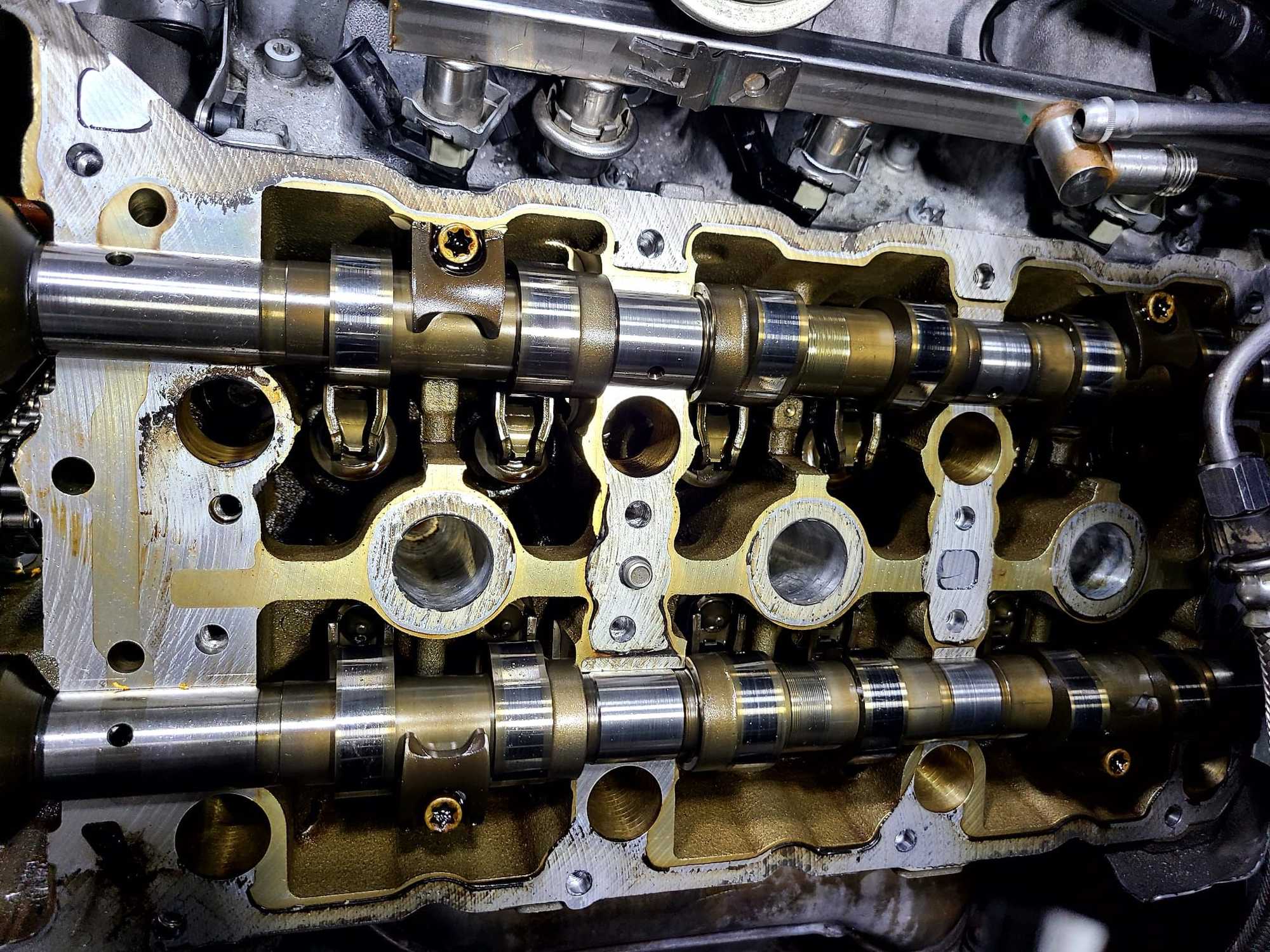

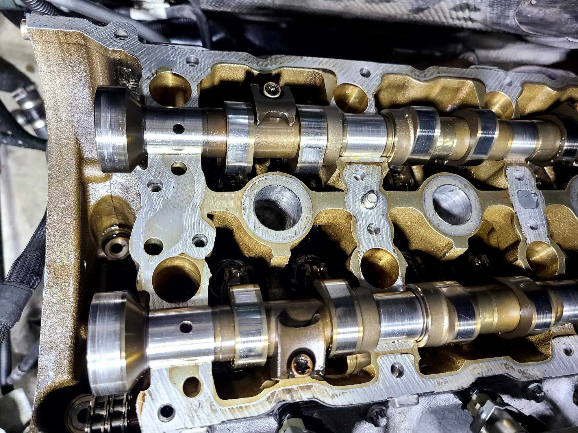

@vesiadog I have a question if you can help: I just placed the cams on the engine, is there a specific postion to place them? Any markings.
I've added a couple of pics to show you

I would watch as many videos about timing and timing chains . Hopefully you can turn the cams with enough leverage to get them in the proper timing sequence to install the chains?
Biggest question I have is How did the gear teeth look? That is what has killed many 350 engines? good luck
You align the cam gears to the crankshaft 40 degrees ATDC period. No other measurement is used. You must align the cam gears to each other and the machined surfaces of the cylinder head where the cylinder head covers bolt down. Make sure the cam gears aren't turned 180 degrees off since the top timing marks can fade. There are pulse wheels on each cam gear that align 270 degrees ATDC. There are 4 cam sensors, not the magnetic solenoids, that pull out of the front covers with one torx bolt each. When the crank is at 270 ATDC, the pulse wheel circles should align with the holes where the cam sensors were. Let me know if you have anymore questions, I have done plenty of balance shafts and helped plenty of people that have repaired them incorrectly.”
copied from a site !!!
