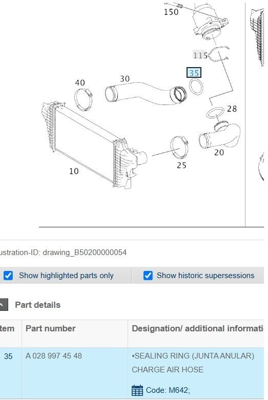

But the orange one doesn't seem orange in your picture. And orange is usually for hot air parts like turbo, PVC, EGR circuit and black is for oily environments.

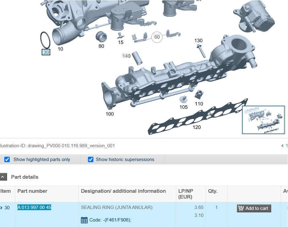

The kit arrived but the green o rings are way too small (I have the same size o rings in my big kit I bought), even though these are from a German company (made in Germany) and claim to fit my vehicle, sigh.
That black o ring from Mercedes is $13 (robbery no doubt) and the EGR seal is $15 (ouch) but he couldn't tell me if what they stock was orange or black.
The EGR is in stock but not the o ring so they have to order it.
A local shop has a nitrile o ring kit in stock so I might take that ring and see if they have the same size.
400 piece kit for $20 or 1 for $13....no brainer.

No brainer at MB means very expensive, I can explain but is somehow obvious, will bring a lot of expenses.
Usually MB has the same prices all over the world only taxes are different.
​​My advice is to use VIN number and reference numbers for placing the order at the dealership. Too much work for 15$ difference.

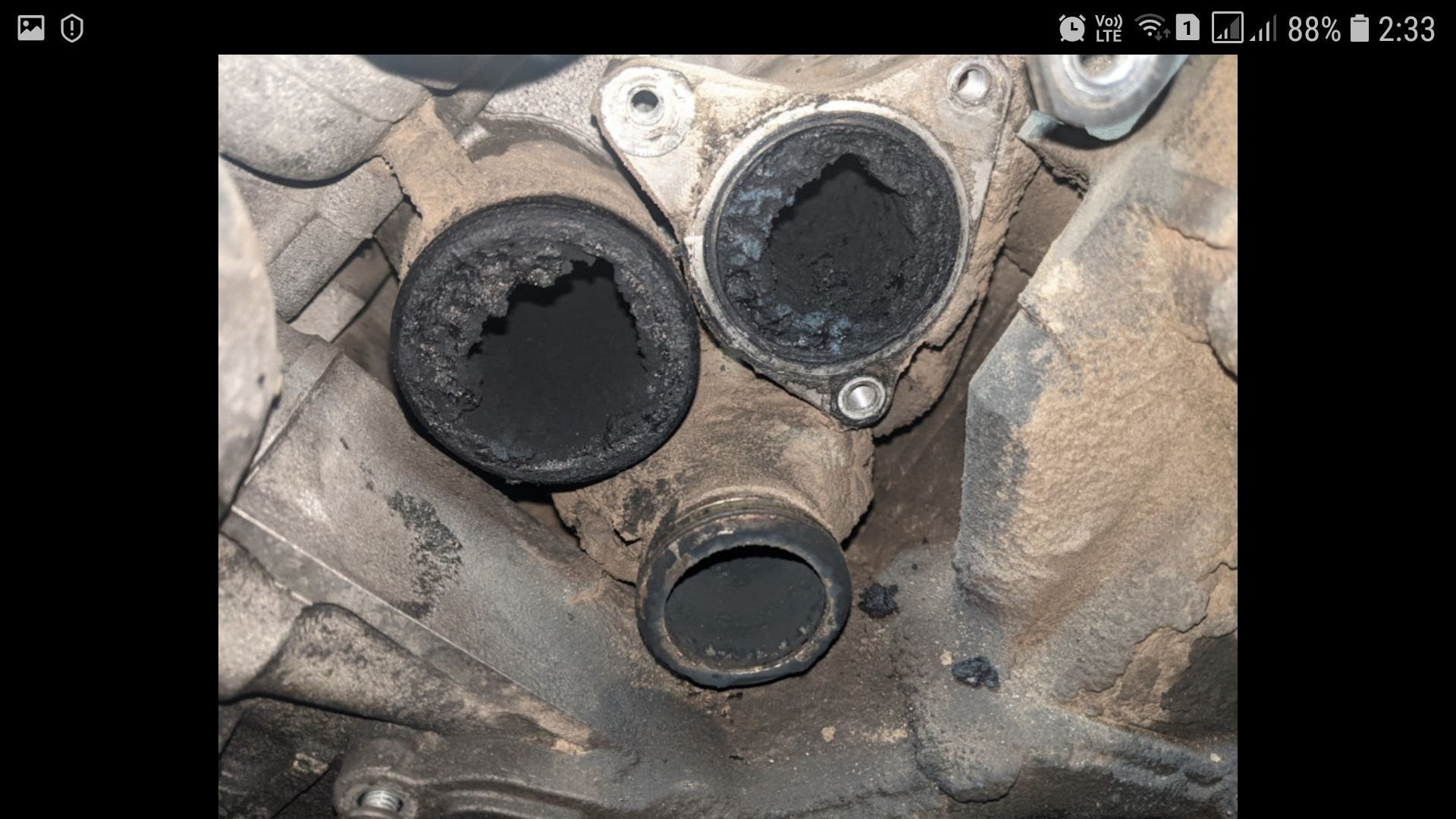

One hypothesis besides many other available is that your EGR valve is stuck in open position, so the engine is flooded with exhaust gases on idle when it supposed to use only fresh air.
Before cleaning the metalic pipe, the volume of the exhaust gases ( burned air - without oxygen) was much smaller because the pipe was clogged. So before all cleaning the EGR stuck open with the pipe clogged assured more fresh air to maintain engine running.
Normally this can be easily tested with a decent diagnosis system actuating the EGR valve On and Off to monitor the fresh air intake over the Air Mass Flow sensors. Also, taking out the EGR valve for a visual inspection could be a solution if your diag can't activate the valve and display the Air flow in the same time, especially if you let the EGR valve connected to the harness - Ignition On and Off should trigger the movement of the valve
Unfortunately the EGR can be very hard to be taken out from the Intake manifold.

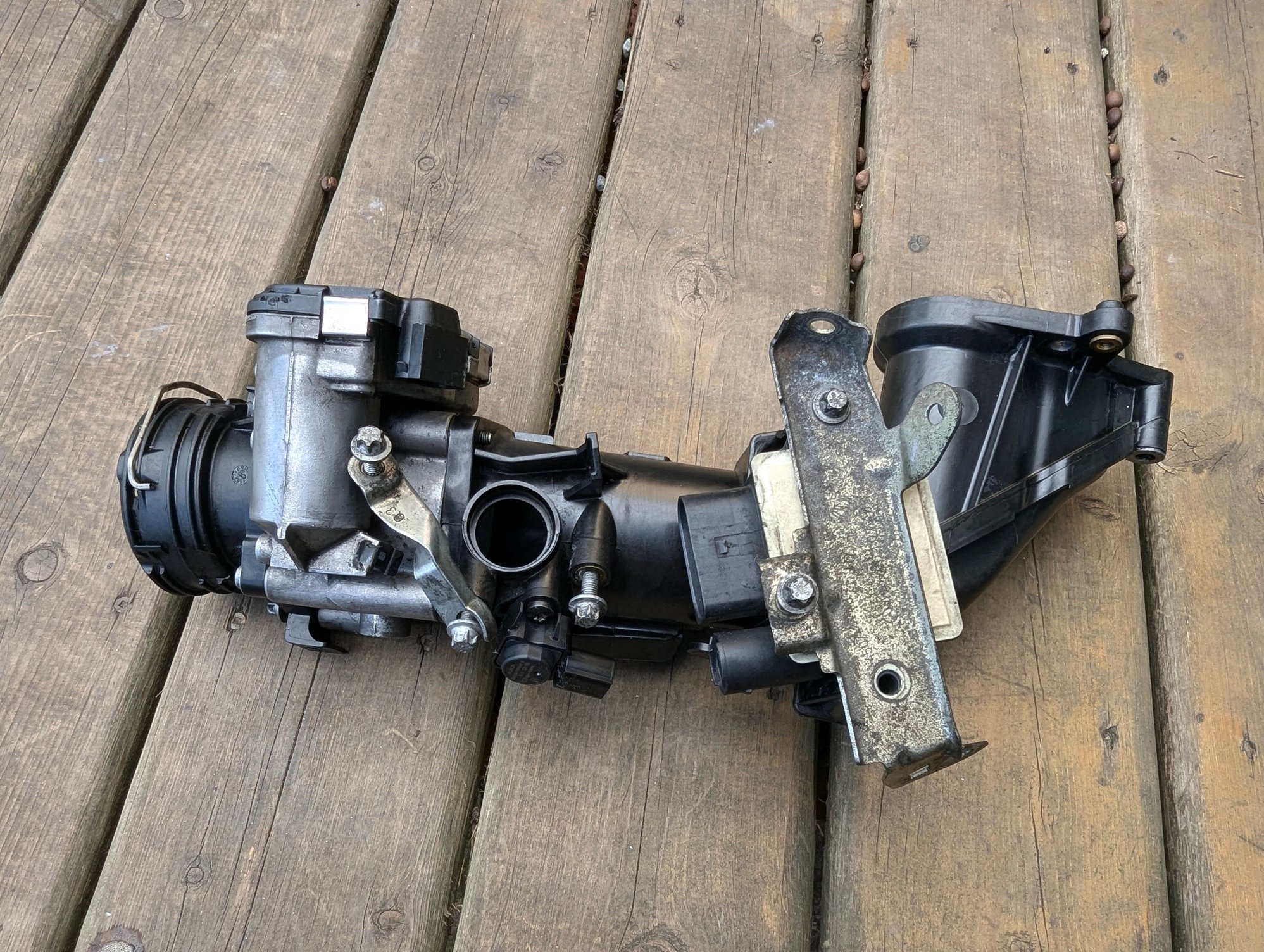

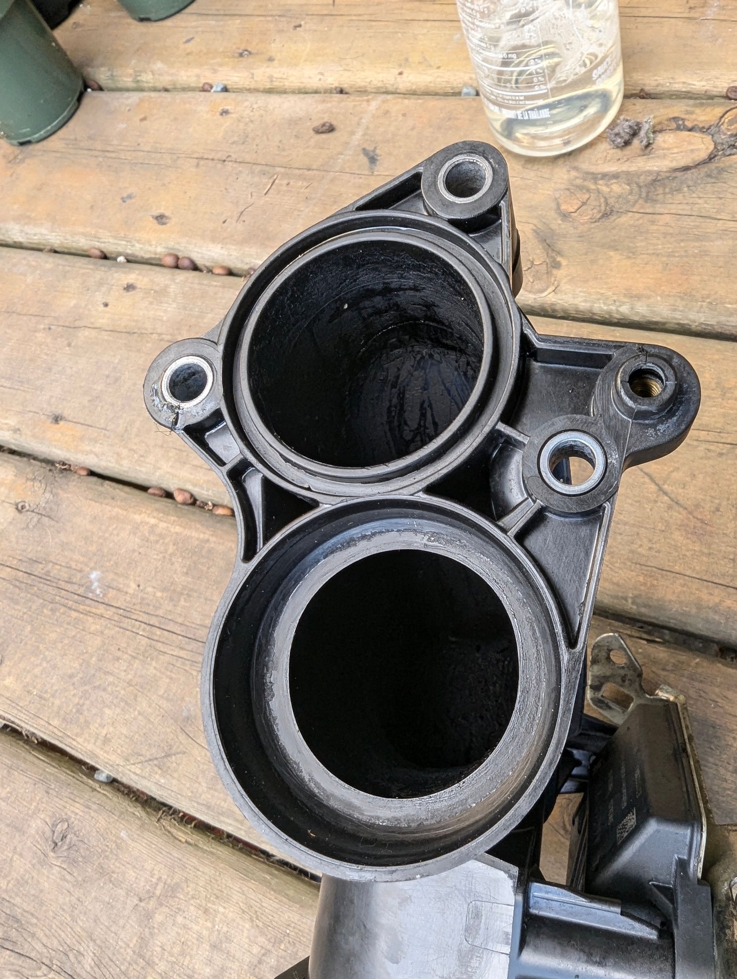

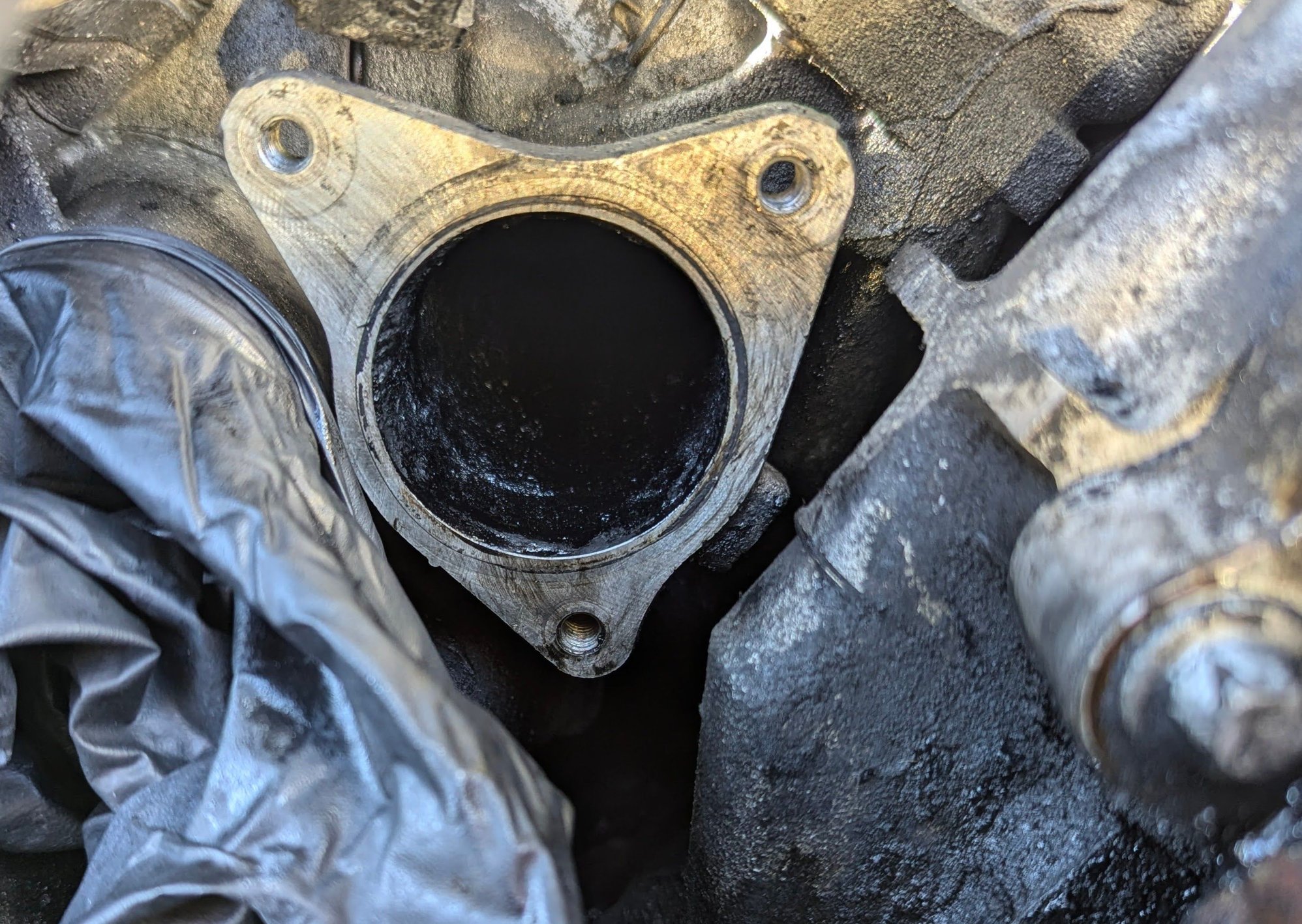

Decided to take thie throttle body/EGR return mixer off and give it a good cleaning.
Surprisingly the throttle body was very clean little, to no buildup at all on it, however the ports connecting to the manifolds were a little gummed, up surprisingly not too bad either.
Here are some before shots:
And here are some after cleaning shots.
That little temperature or air sensor probe that you see in front of the throttle body was completely caked with soot and oil, I used some sensor cleaner and lightly scrubbed it to get it back to good shape. Maybe that will make some difference who knows?
I thoroughly soaked the engine and cleaned off some of the gunked on oil since I had a lot of room in to do so. Of course I sealed up all the ports with rubber gloves so that nothing would get in them.
I'm tempted since I have this unit off to spray some cleaner into the intake manifolds as well as the EGR, what do you think?

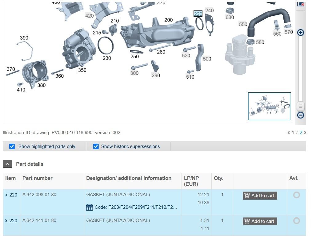

I don't have your VIN, so I can be wrong...
Can you possibly shoot me the STAR info for the gaskets I need on the EGR?
That first image shows the ones I need, appreciate it.
Old Sep 30, 2024 | 04:41 PM
  #63
trigital's Avatar
Joined: Dec 2011
Posts: 1,692
Likes: 488
From: Spain UTC/GMT +2 hours
W213 All-terrain

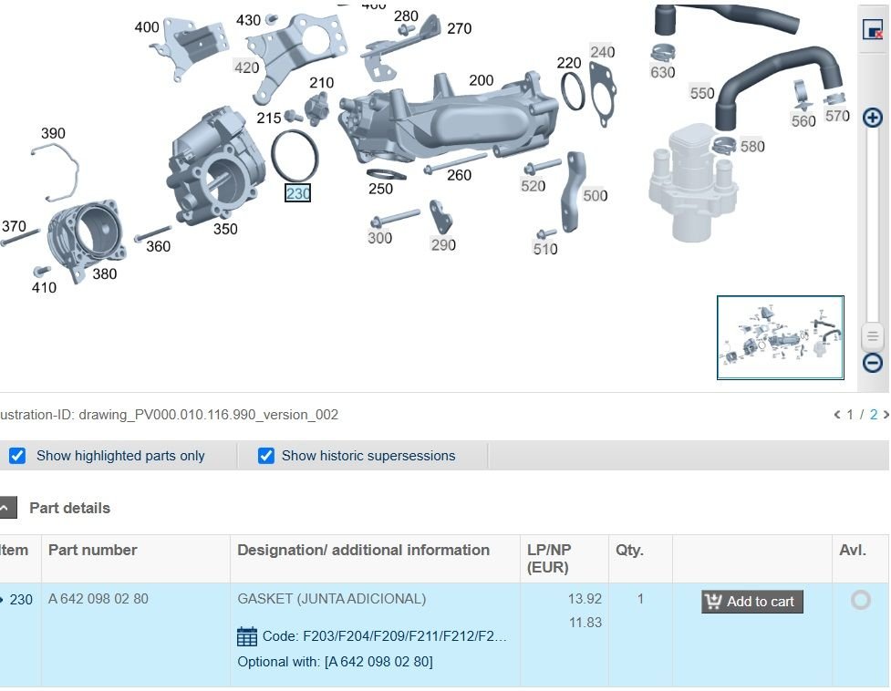

I still do not have your VIN or I lost it...
So, from my first picture you will need the reference numbers for part:
220
230 x2
460
Yes?
The EGR is not here...

230 x 2 is off as the ring that goes into 380 is a different thicker & taller black rubber ring vs the 230 orange on the plastic return mixer.
I have a new 460.

No info about 380....sorry, 220 has 2 variants...I really don't know why....here all that is very cheap and we kindly don't care about not using all....
Did you check here? If like this...then a new Intakes will be needed...
