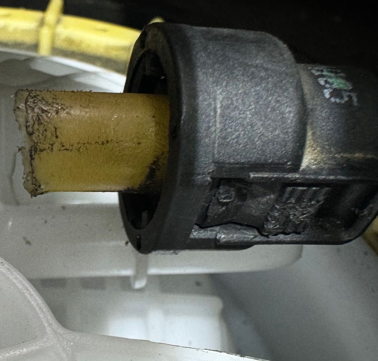

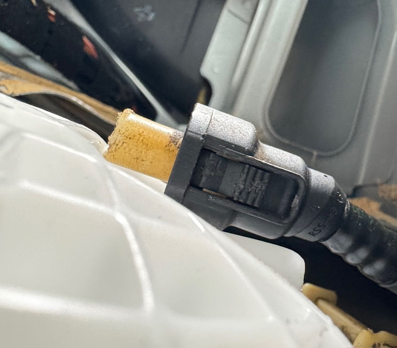

I'm having an issue with disconnecting the fuel line connector from the fuel filter. There are two buttons on the fuel line connector locking it to the fuel filter. I accidently cracked the old fuel filter, which is stuck in the fuel line connector. There are multiple pictures below showing the fuel line connector. I tried multiple ways to disconnect and also bought the fuel line pliers below with no success. Any suggestions and/or a video stating how to do would be greatly appreciated! Thanks.

I was able to remove the Fuel Filter connector with a 3/8" fuel line connector tool.
