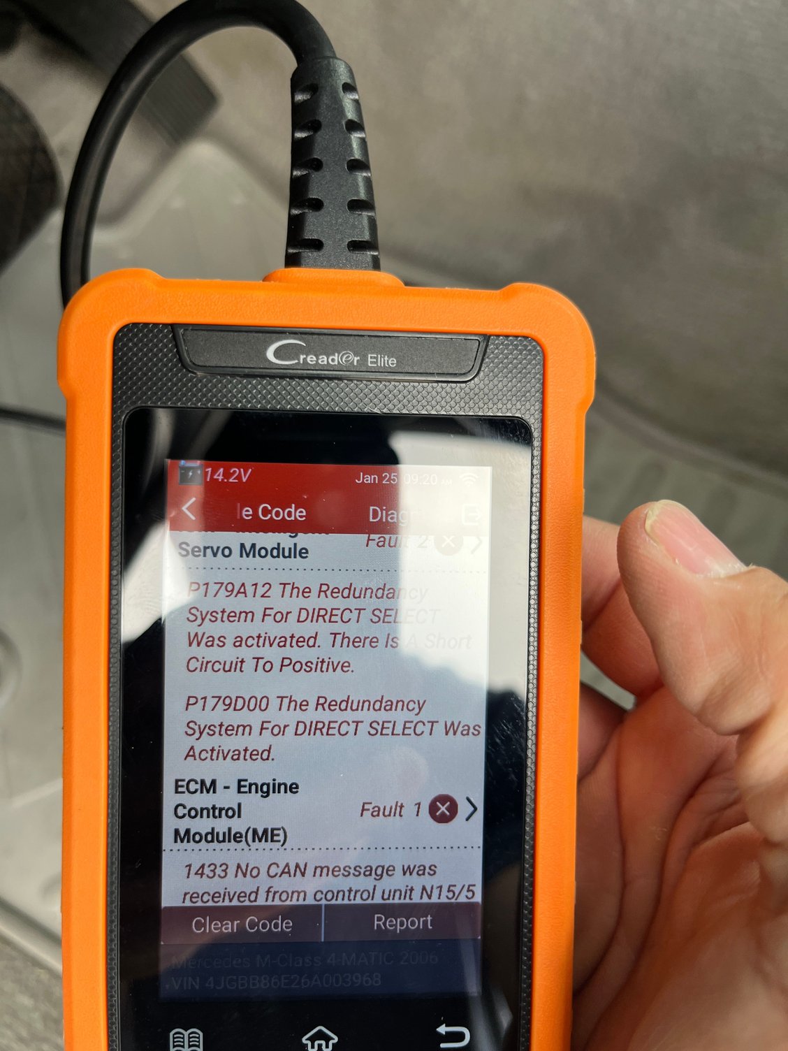

I have a 2006 Ml350
It is having electrical issues
randomly has the red flashing drive to workshop warning and won’t shift
I have removed and replaced auxiliary battery
removed rear Sam and cleaned motherboard
I can clear codes from obd and car is then drivable again
also does machine gun lock on rear driver door, I thought it was a bad actuator so I replaced it and it still randomly does it

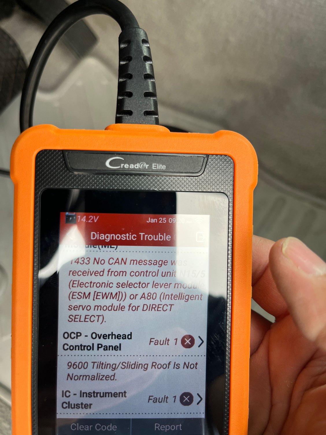

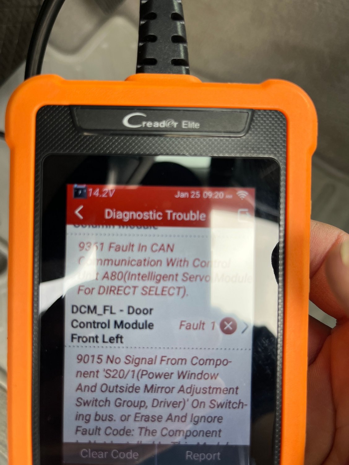

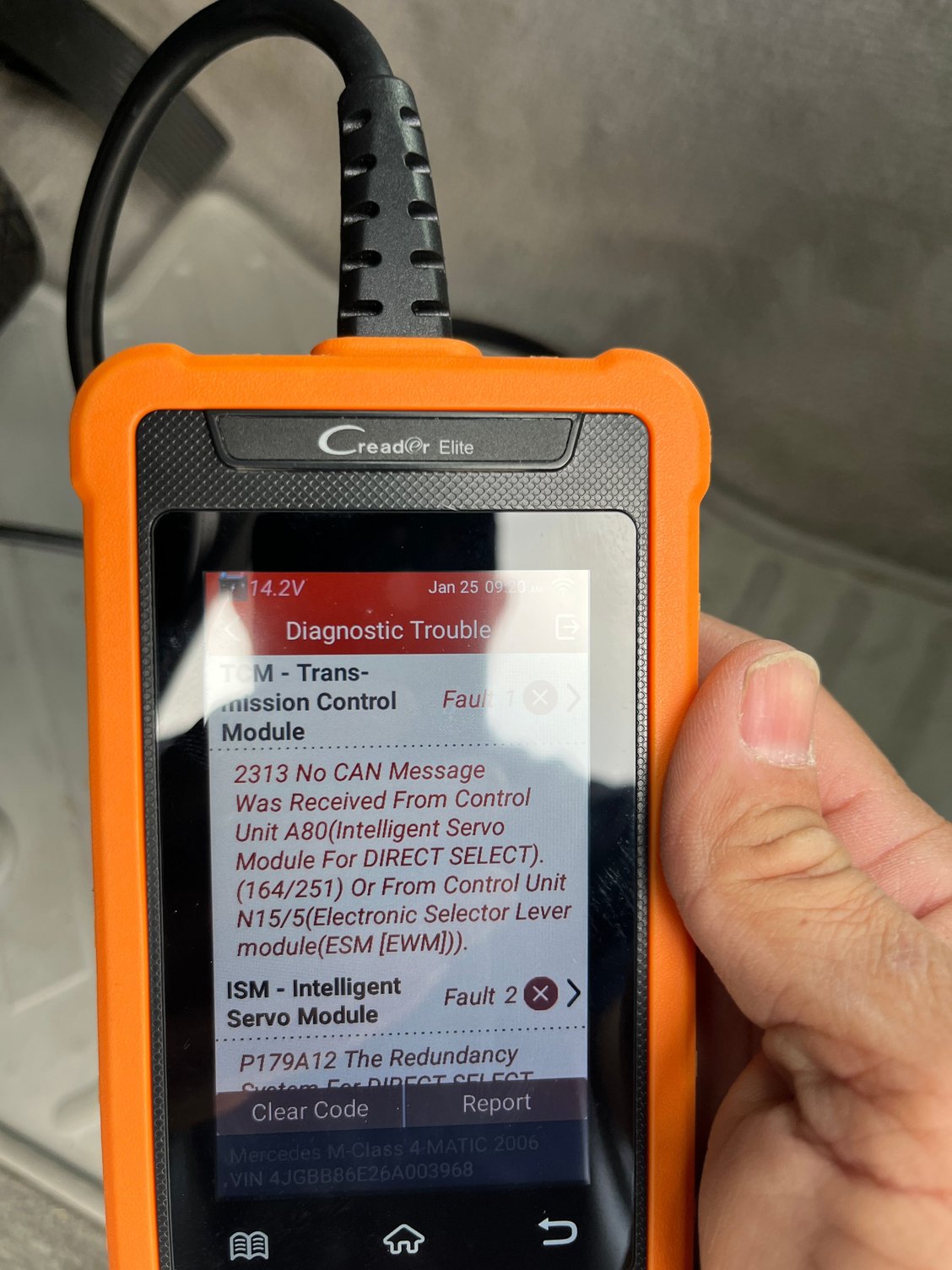

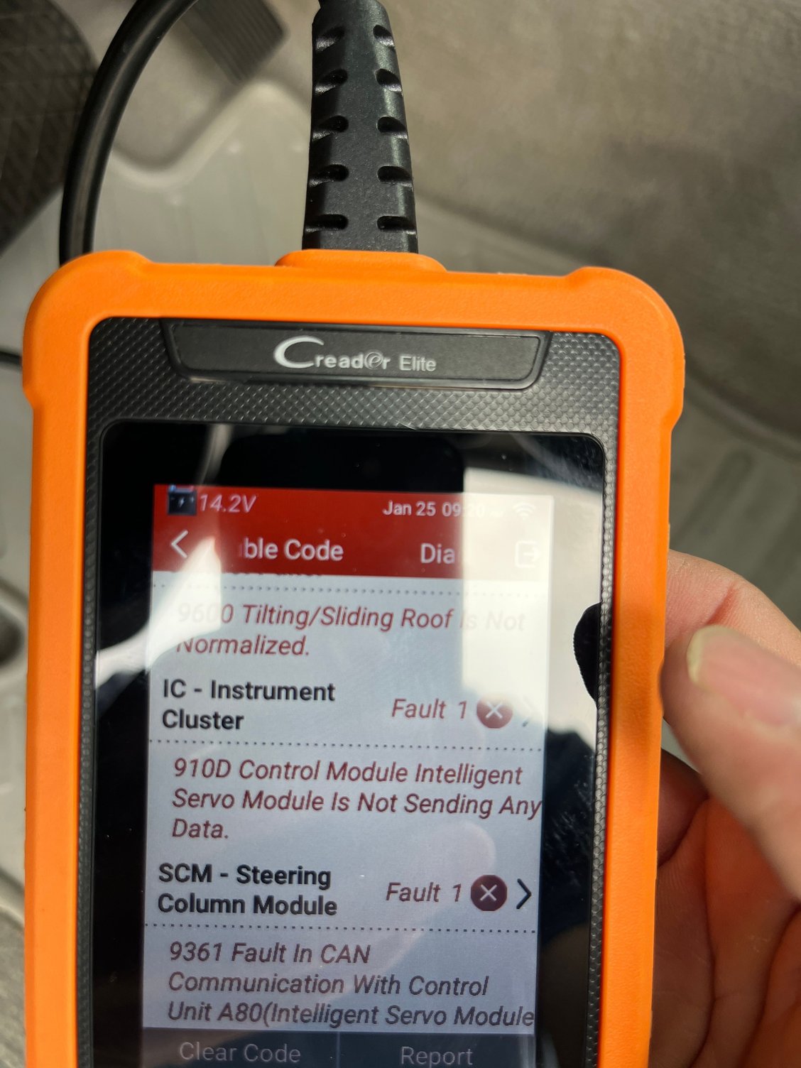

below is the last set of codes I had before clearing
I appreciate if anyone can help or has suggestions to try
I’m kind of at a loss right now.
