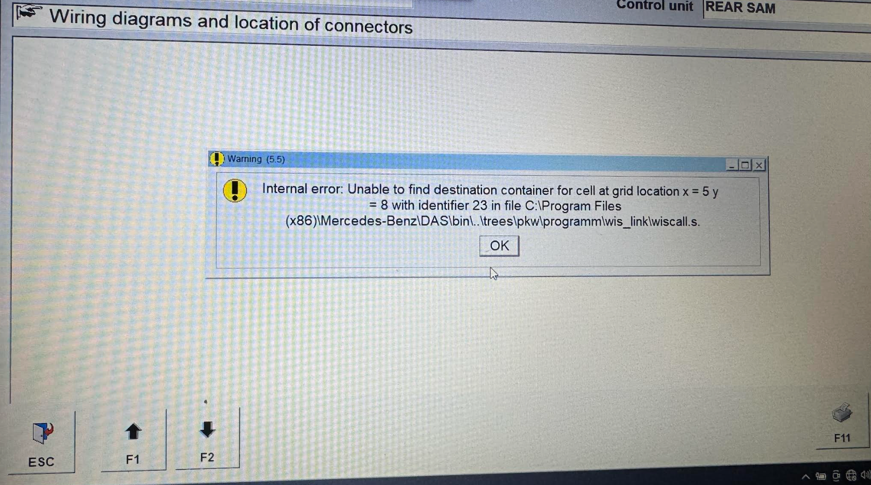

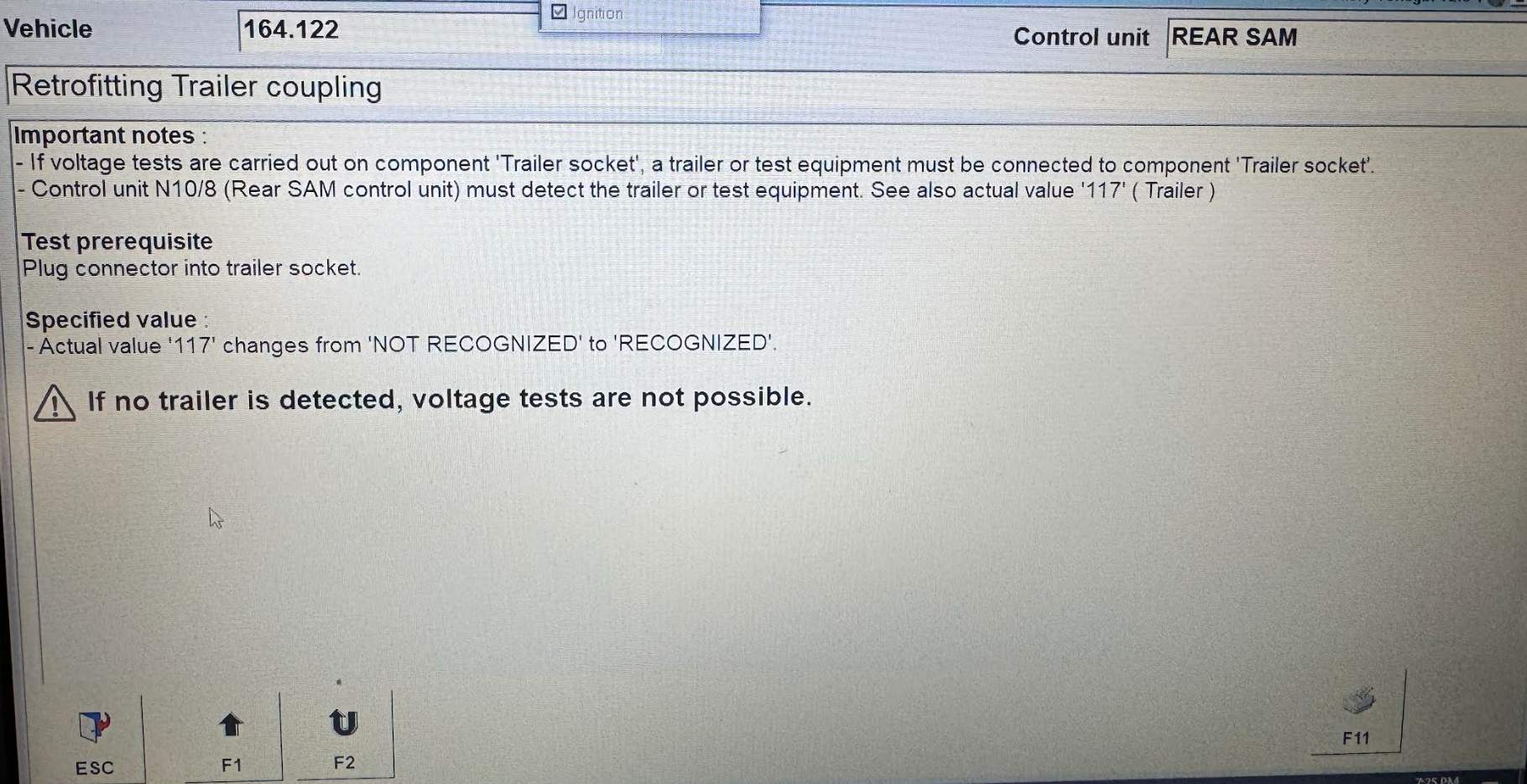

Hi, I am getting a weird error where the dash shows "Left Trailer turn signal lamp faulty" and using the left blinker causes the blinker sound like it's going twice as fast. The odd part is that all the lights on the car are operating and are blinking at normal speed, including if I attach a trailer. Checking the trailer hitch connection, all voltages are normal, and nothing seems to be shorted to ground. The rear sam area seems dry, and there is no corrosion on the connector or lights. Not sure what to check or due next at this point. Clearing the code makes it come back instantly.
On a side note, unable to access the wiring diagram through Xentry because of an error attached.

Anyone has a method of how to troubleshoot or locate the fault? Not sure which connector the error references to.
