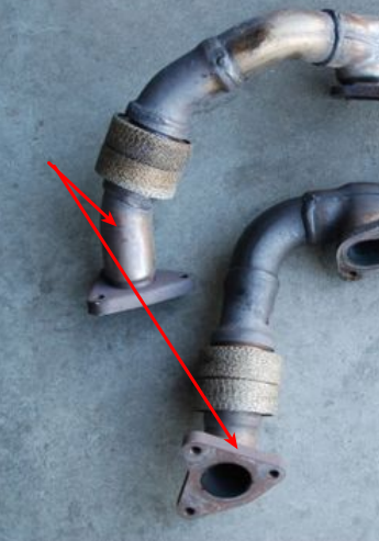

I have a question. Is it normal for exhaust manifold heads to have a little play? I've attached the references (A6421400161 and A6421420102) and a photo of where it moves a little.

There said me yes in Mercedes... And I saw videos where there talk about deformations and where they say this articulation is necessary.
