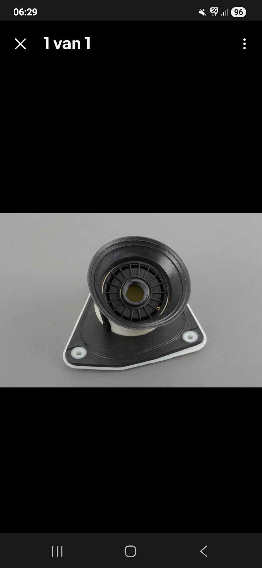

Well sorry for the late response. I ended up not using it and my wife would use it to go to the market here and there.
I went to investigate and to my surprise it was where the rack and pinion connects to the chassis, apperrently the rubber that holds it in place was completely gone on the drivers side. i noticed there was oil around the area. Popped the hood open and oil all on the front of the engine and made it's way back there. That's why i ussally do it but was pressed for time and needed to go to cali. Needless to say i will never go back. the cap that holds the filter was loose to the point i could hand turn it twice then got the wrench and tightened it. went to power wash it, but is it possible the oil ate the Rubber? It is completely gone.
I made a temp shimmy to slide in but it made it worse because now it would force it to move up and down instead of side ways. which after removeing i could tell even the inner rubber around the screw was completely gone.
well i figure let me see how much room i can make to slide one in. the bolt head is on the firewall side and the nut is on the radiator side. the bolt can not come out because it hits the differential Case. the other way around would have made more sense.
not sure what to do at this point. it only knocks at a stand still when driving even a 3 or 4 mph i dont hear or feel ant thing other than fustration.
I saw a video on how to remove the rack and pinion and they had to remove the differential.

So I ended up ordering the Steering rack Mount bushings and decided to take on the project. Took about a hour and a half being my first time and all. I saw that the leak was coming from the area, that has the 2 red plugs. I've looked through countless pictures but can't seem to figure out the name of what connects there or if it is a gasket or O-rings that go there. Any help would be greatly appreciated.
