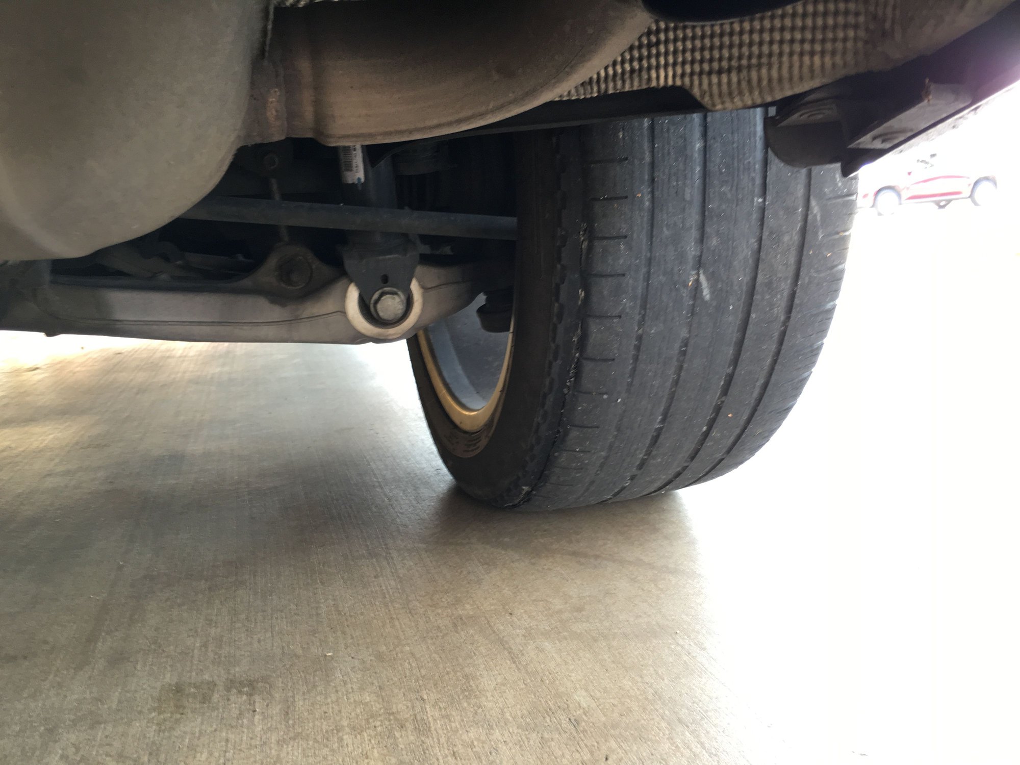

Just returned from a 4k mi road trip - had two run flat tires fall apart on my ML550 between Memphis and Little Rock. They were OEM Pirelli Scorpions with 20k and about 8 months old (rotated every 5k mi). Was planning to replace them when I returned home since I noticed the wear bars exposed halfway through the trip...apparently that was not the wise thing to do.
So...never buying those again. Tread life is way too short.
Anyways, I had the ML towed 78mi to Little Rock to the ONLY store in Memphis and Little Rock that had any type of 265/45/20 tires in stock (well, MB Little Rock had non-run flat tires, but they were $1805 for a set of 4...not that desperate).
Turns out the only available tires were Nexen N'fera RU5 tires - which I've never heard of. Korean tire company with a 65k mi warranty on a set of non-run flat all seasons. $621 out the door.
I was intending to replace the tires with the Pirelli Scorpion Plus version (non run-flat) at around $970, but I'm going to see how these turn out.
Just thought I'd share. Will follow up after about 10 or 20k mi.
Run-flats on these MLs are...not recommended...

I shared this as a way to let others know how the Nexens work out. Both run flat tires failed in between Little Rock and Memphis requiring an immediate tow - these tires were the only option without stranding me in Little Rock for 4 days to ship in proper tires. Trust me, I checked every place within towing distance in Memphis and Little Rock on a Saturday. I did not have time to wait with family in the car.
I called every single tire dealer in a 200mi span - the Auto Tire Distributor Warehouse (supplies Firestone, Discount Tire and a few others) was the only place with matching tire sizes and weight rating to get me safely back to Arizona besides the MB dealership. And it was these Nexens - $600 for a quick fix was a no-brainer. MB Little Rock told me frankly the Nexens were the better option in my situation. These were a quick fix.
After about 10k miles these will be taken off and replaced with a new 255/45/19 wheel and tire set with Pirelli Scorpion Verde All Season Plus tires when I place the order...which is what I intended anyways.
Thought I would share feedback on some cheap tires with the forum. You may be right, or you may be wrong. Either way, it is free (and friendly) feedback.

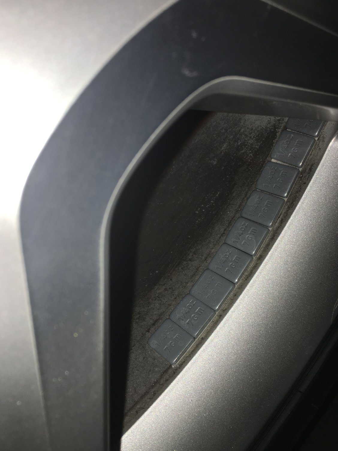

Just crossed over the 1k mile mark on the drive back home on the Nexens. I checked the tires - they are made in Korea, not China.
The Good:
- Quieter on rough asphalt and very quiet on smooth highway sections
- They absorb small road imperfections better than the run-flats (unfair comparison though)
- Stopping distances have not changed, though I'm a pretty conservative driver.
- Cornering is just okay - Pirellis encouraged more speed through a corner and didn't really roll. With Active Curve, the sidewall roll is noticeable on the Nexens.
The Bad / Questionable:
- 3 of the 4 tires required more weights than the Pirellis to balance out and they still have a slightly noticeable throw between between 60-65; however, I have not checked the round on my wheels to rule out a bent wheel.
- Sidewall roll is pronounced which leads me to think a hard hit on a pothole might actually damage the tire, though I have yet to hit a big pothole.
- Had to stuff a space-saver spare in the back...B&O precludes using the spare well
Overall: Not bad. With very little wear, I have little to complain about. Though any new tire will be improvement over a worn out set of run-flats. The number of weights to balance the tires does make me question the consistency in manufacturing. More useful feedback will actually be at the 10k mile point when they've worn in.
Caveats:
1 - I live in AZ: Dry, flat roads, and temps in the 60s-70s; potholes are not common, though sharp linear cracks and bigger heaves are common
2 - My priorities: quiet, comfortable, predictable (don't need the best grip, but enough to be predictable and safe), and at least 30k miles of safe use
3 - I'm not a spirited driver - I drive for comfort; mostly 2-3hr highway runs at 80mph

You said the old tires "fell apart"... did you ever completely lose air pressure in any of them? If yes, then you could have bent a rim fairly easily. If you didn't and the old tires have always been properly inflated, I highly doubt that you've bent one of the OEM MB 20" rims unless you've hit a massive pothole (which would have cut the tire sidewall in the process). Those are pretty solid and with the 20s there's enough sidewall height (air) beteween the metal and the pavement.
Unless your tires are quite under-inflated, the lack of lateral rigidity is due to the absence of additional reinforcing belts that are present on all of the MO tires. Yes, the extra wheel weights and vibration at speed could be due to quality issues (again assuming that you haven't bent a rim), however it can often be corrected by road-force balancing. Having them road-force balanced at a shop that has the equipment will likely cost you an extra $80-100 in labour though, but you may want to try it. They can also visually check the wheels for run-off (see if they're bent) at the same time while they're being spun. Good luck - and please let us know how things work out.

Final Verdict - Avoid Nexen Tires - manufacturing just isn't up to snuff.
Details:
After 4 spin balances and 1 road force balance it turns out 2 of the tires have a 'hop' between 62-68; had them spin the tire on the wheel with the road force machine and re-balance, but the two tires won't balance out. Tested the run out on the wheels to rule out a bent wheel.
So, after 7k miles, these Nexens are coming off and the Pirelli Scorpion Verde Plus tires are going on.
Main problem was vibration - both from flat spotting overnight and the tire hop mentioned above. These are just not up to snuff - problems point to manufacturing inconsistency and an inadequate compound that can't deal with the weight of an ML.
No cupping or any other safety related problems I could see, but I can't stand a shaky ride in a Merc. I drive too many highway miles for that.
