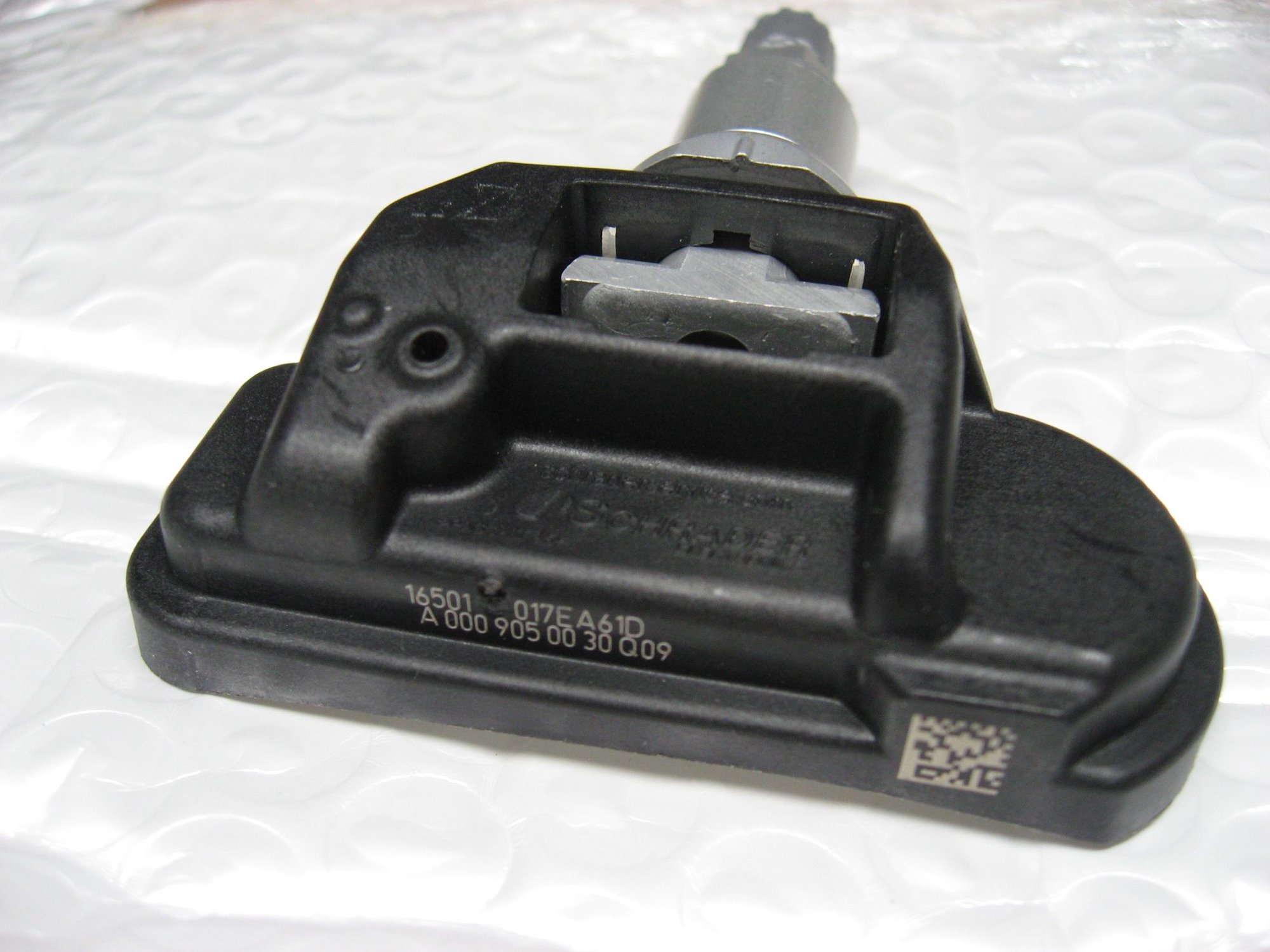

Update #2: As I've stated previously, I have an Autel tablet (without the TPMS sensor RF/wireless diagnostic reader capability) and periodically perform a full scan of all of the car's modules (I last pulled down the Benz updates for MaxiSys in late 2022, when my subscription was still active) and perform periodic engine live data monitoring. The only code it found came up a little over two months ago and is from the TPMS module:
C159916 (The battery of the tire pressure sensor has a malfunction. The limit value for electrical voltage has not been attained.).
Tire pressure monitoring seems to be working fine right now (and I'm not getting any error messages in the car's cluster), but one of the TPMS sensors seems to have a battery that is getting weak, I presume. Is that correct? I don't know if they had ever been replaced under the previous owner when the tires were replaced. I assume that the Schrader OEM TPMS sensors are perfectly fine as replacements over the Genuine Mercedes ones, which cost 3x as much, right?

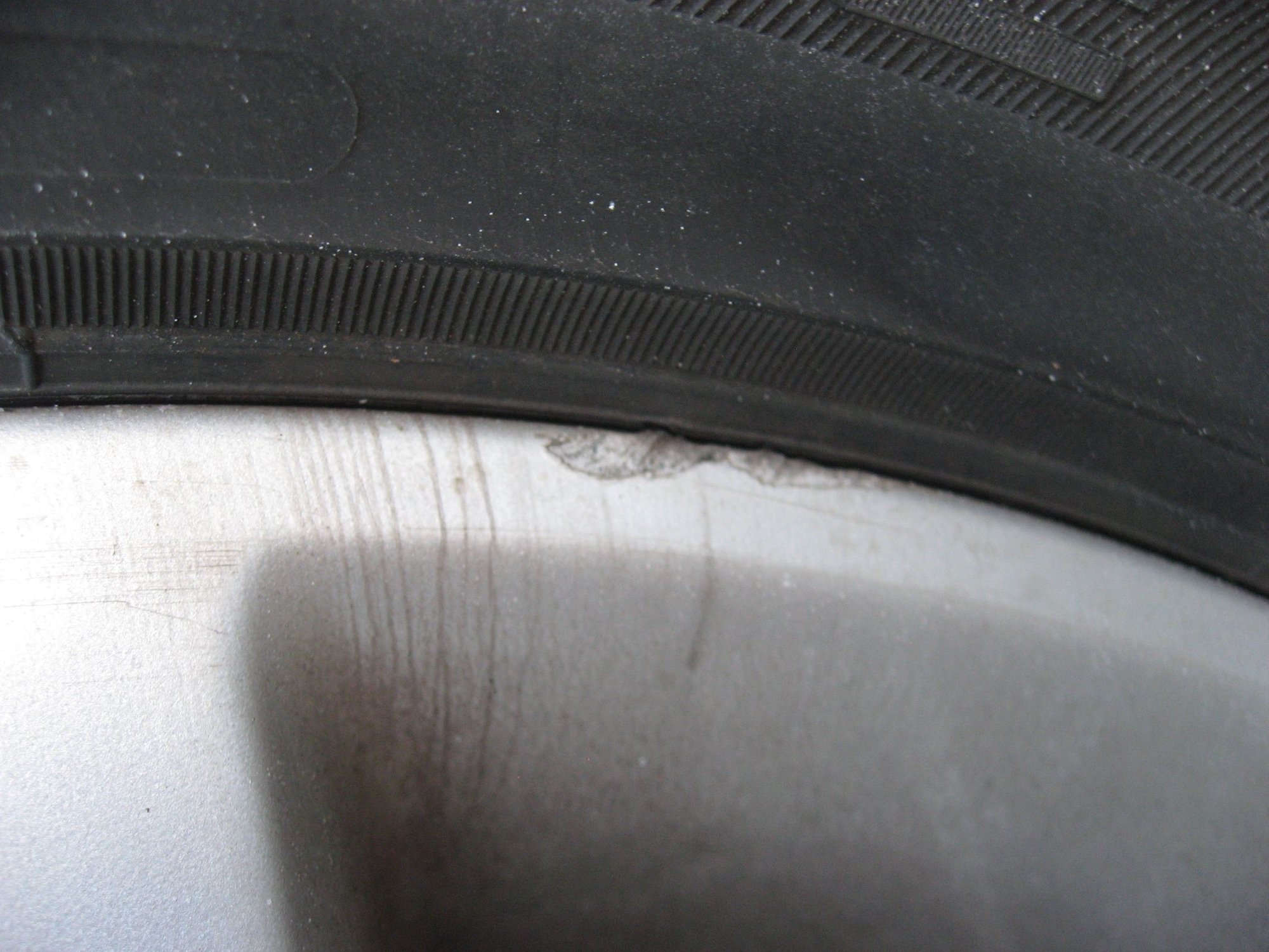

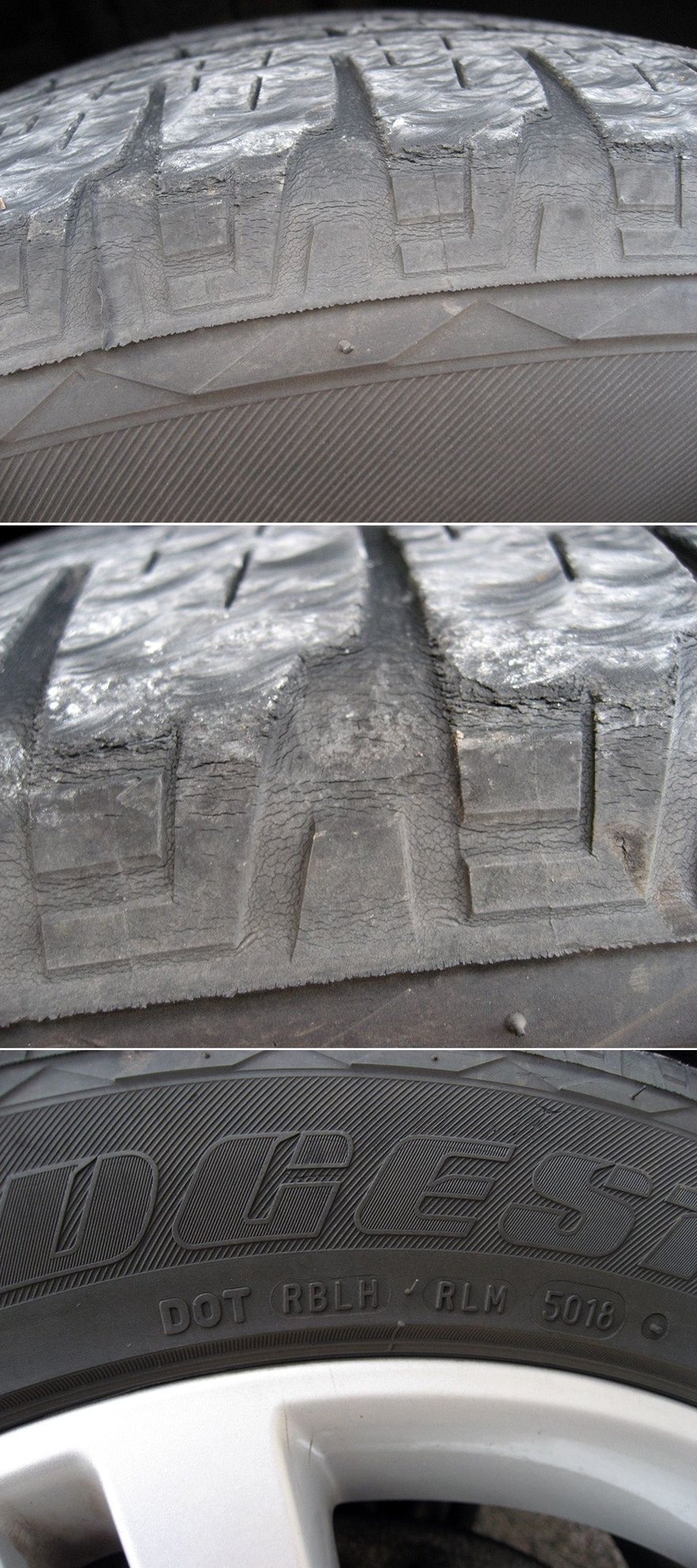

Then, I had my annual maintenance service this past winter when the SUV had a little over 95,000 miles on the odometer. Tire Rack had their end of year deal on Pirelli Scorpion Weatheractive tires into early January, so I had picked up a set of them to replace the Bridgestone Dueler H/L Alenza Plus tires installed at the dealership by the previous owner. Each of these old tires had a different date code (early 2018, late 2018, early 2019, and one from late 2020, which had been installed months prior to our purchase of the vehicle). The three oldest tires were already experiencing significant dry rot. As an example, this was the tire with the late 2018 date code:
The tire with the late 2020 date code did not exhibit any serious dry rot yet, and it still had a bit of tread left, so I decided to keep it as a full-size spare together with the rim, as it was also the only rim to have any curb rash:

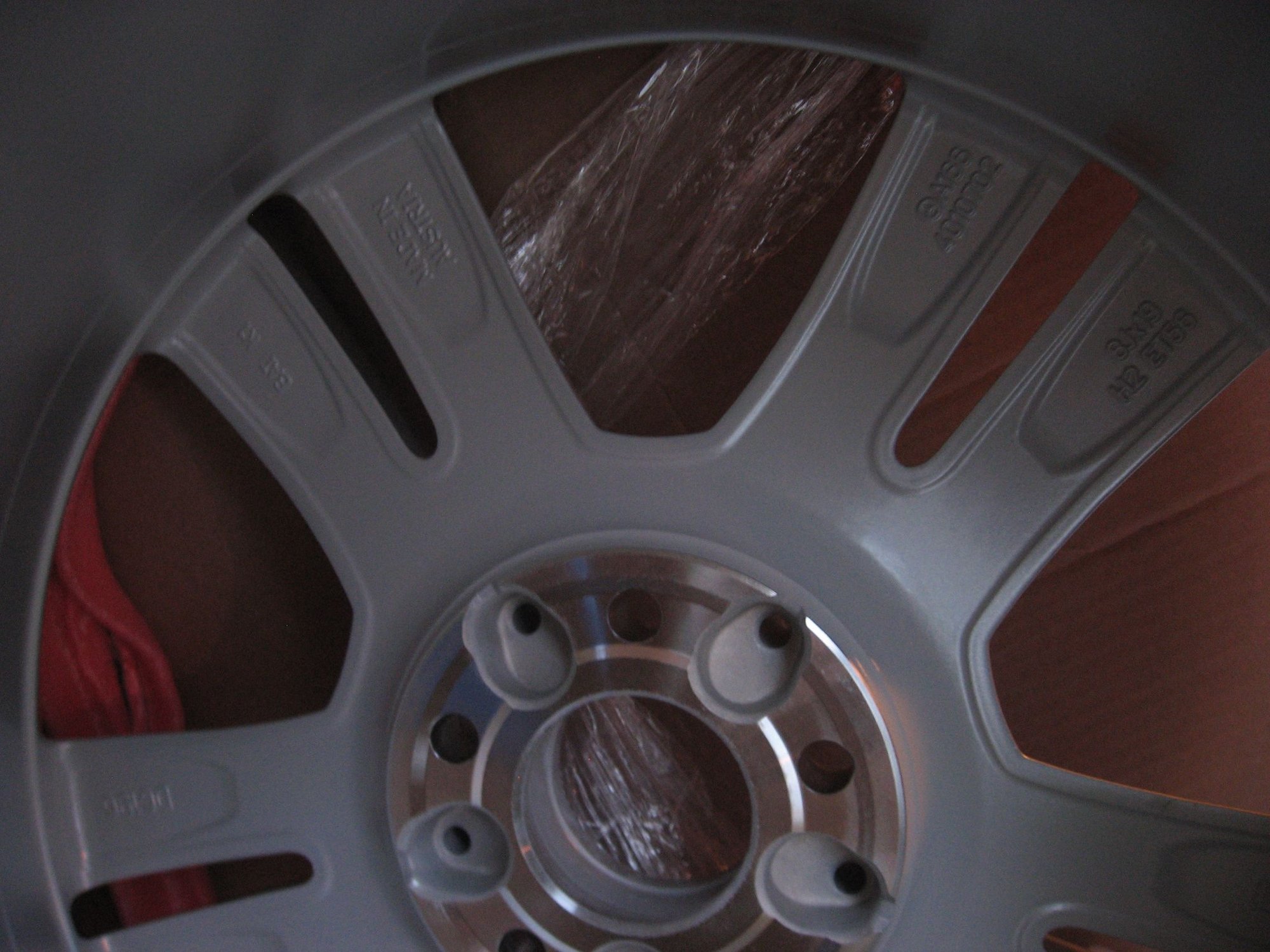

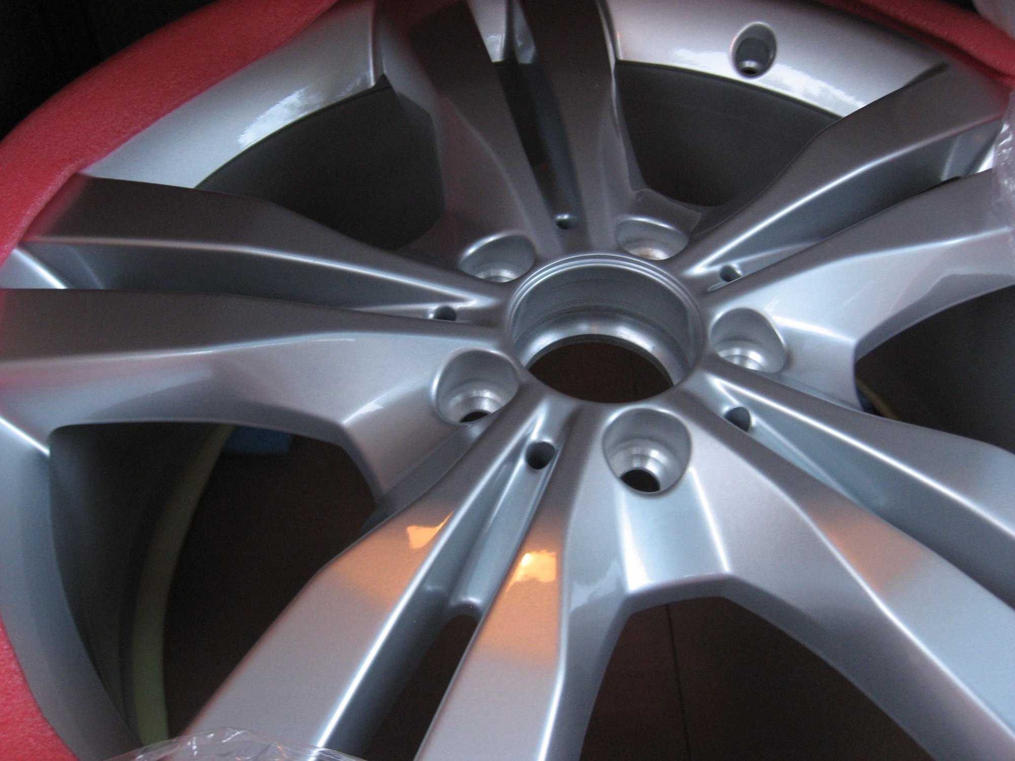

I was able to find a brand-new replacement rim from the wheel business run out of the Auto Adriatique Garage center in Montreal. Total cost about 265 USD (and they threw in for free a set of 4 brand-new OE TPMS sensors, which matched the old ones installed by Mercedes under the SUV's previous ownership but a newer revision, of course):
The old TPMS sensors:
The new TPMS sensors:
One of the new Pirelli tires mounted and installed:
As for the TPMS code C159916 (i.e., "The battery of the tire pressure sensor has a malfunction. The limit value for electrical voltage has not been attained.") that I have been experiencing since last year, I cleared the stored code, and it didn't come back after the new TPMS sensors had been installed. It was just a battery/batteries getting low in one or more of the old TPMS sensors. There are also no new codes reported after performing a full scan of all of the SUV's modules.

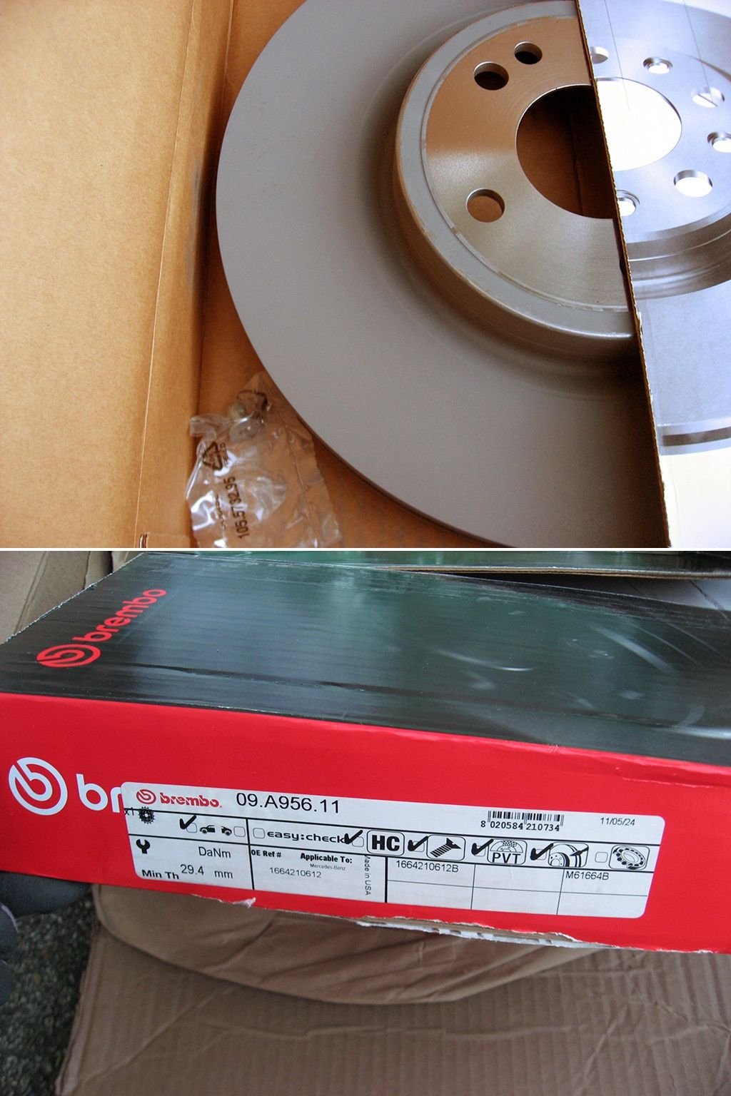

The coating on the Genuine Mercedes rotors that came with the vehicle had held up well in our salty environment, and we were OK with their braking performance, so I decided to just get the coated rotors from Brembo, the OE manufacturer for the Genuine Mercedes rotors (both manufactured in the U.S.).
The Genuine Mercedes front rotors.
I purchased the Brembo coated front rotors, which are the OE equivalent.

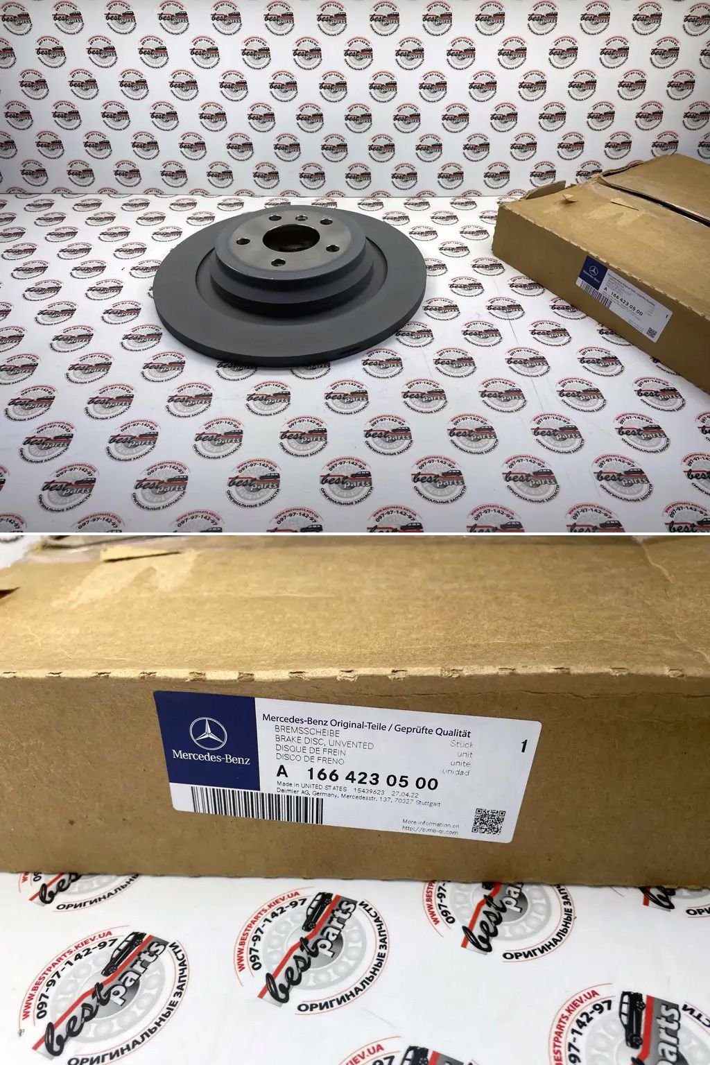

The Genuine Mercedes rear rotors.
I purchased the Brembo coated rear rotors, which are the OE equivalent.
