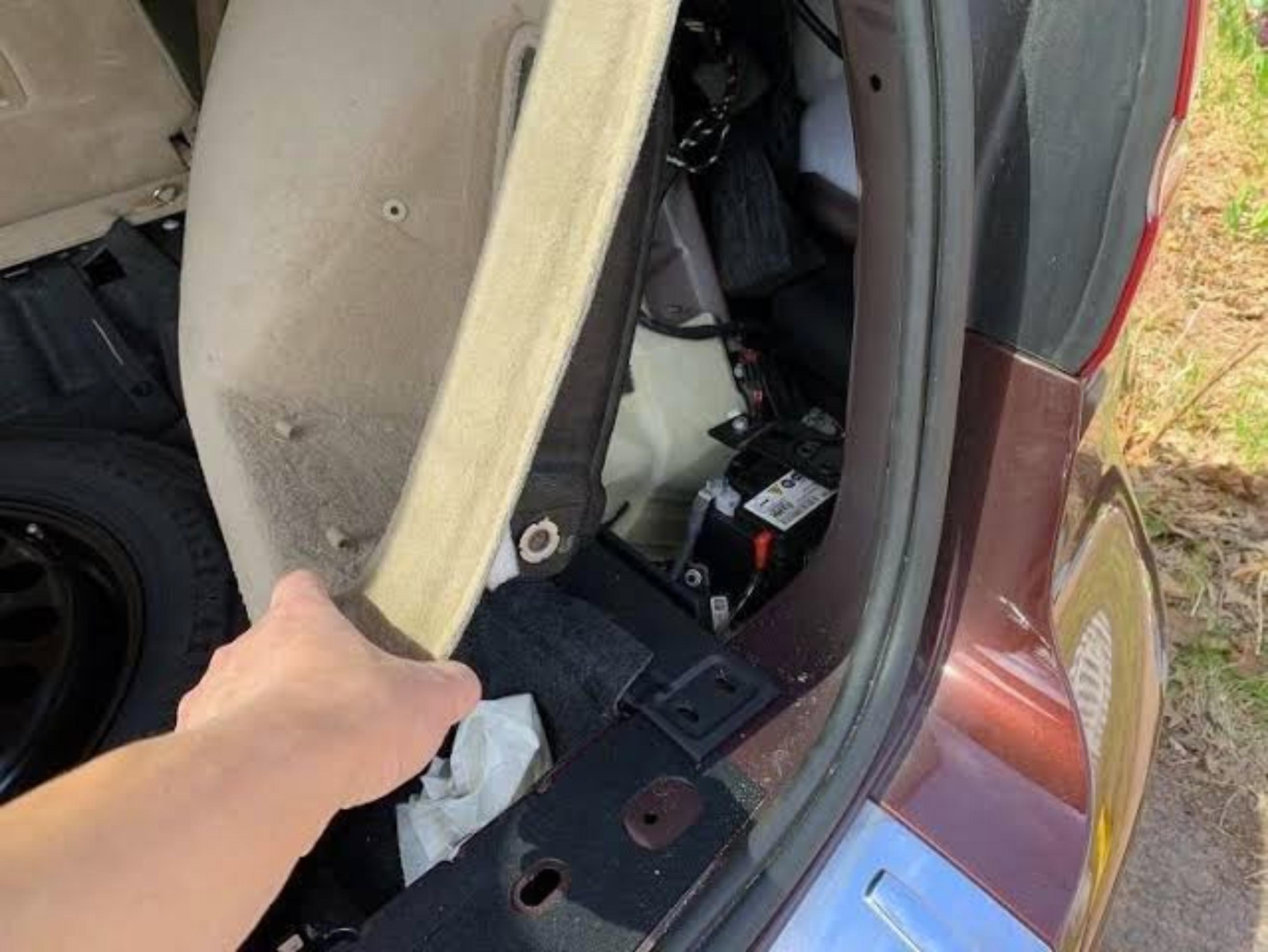

Just my luck: I bought the small battery and my vehicle has the large one; anyone have that part number?
Its just a 12v battery. Measure it and buy one that fits.

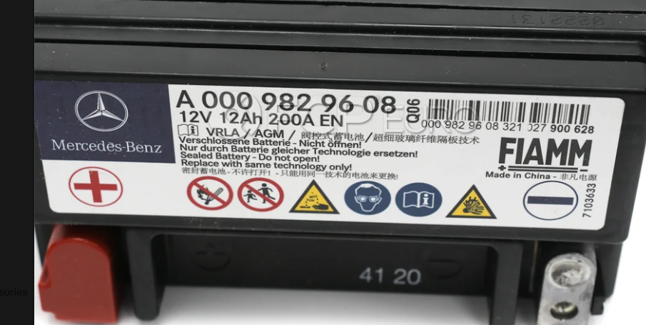

I assume you already looked in the back/trunk.
The "medium size" battery is a AUX14 AGM 12V 12Ah 200CCA vented battery.
For example, https://www.fcpeuro.com/products/mer...mer-0009829308
Any reputable brand will do if the minimum specs above are satisfied. You may find 14Ah, that will be fine as well.

Originally Posted by eddieo45
the answer to your question is right there in my post; 12v=12v so why not make my life easier??
If you think that two batteries have the same functionality because 12V = 12V, you have not evaluated the two batteries closely.
The little battery is rated at 1.2Ah, and the medium-sized battery is rated at 12Ah. That is a factor of 10. Additionally, I have not explored the CCA of each battery type either.
Also, the MB vehicles are very sensitive to voltage levels and available power (juice). A low voltage battery can trigger all kind of errors. Some technicians start chasing the error messages instead of checking the batteries, charge/replace them and money is thrown away for no reason.
The cherry on the cake is transmission control modules corrupted because of a low voltage during the computer module's booting/shutdown process. It happens to laptop/desktop as well with corrupted BIOS. Some technician replace TCM, plus coding plus $$$. The MB "hackers out there" reflash the TCM, and problem solved with minimal cost but only a few know how to do it (defintely not me). Summary: keep your batteries charged and healthy
