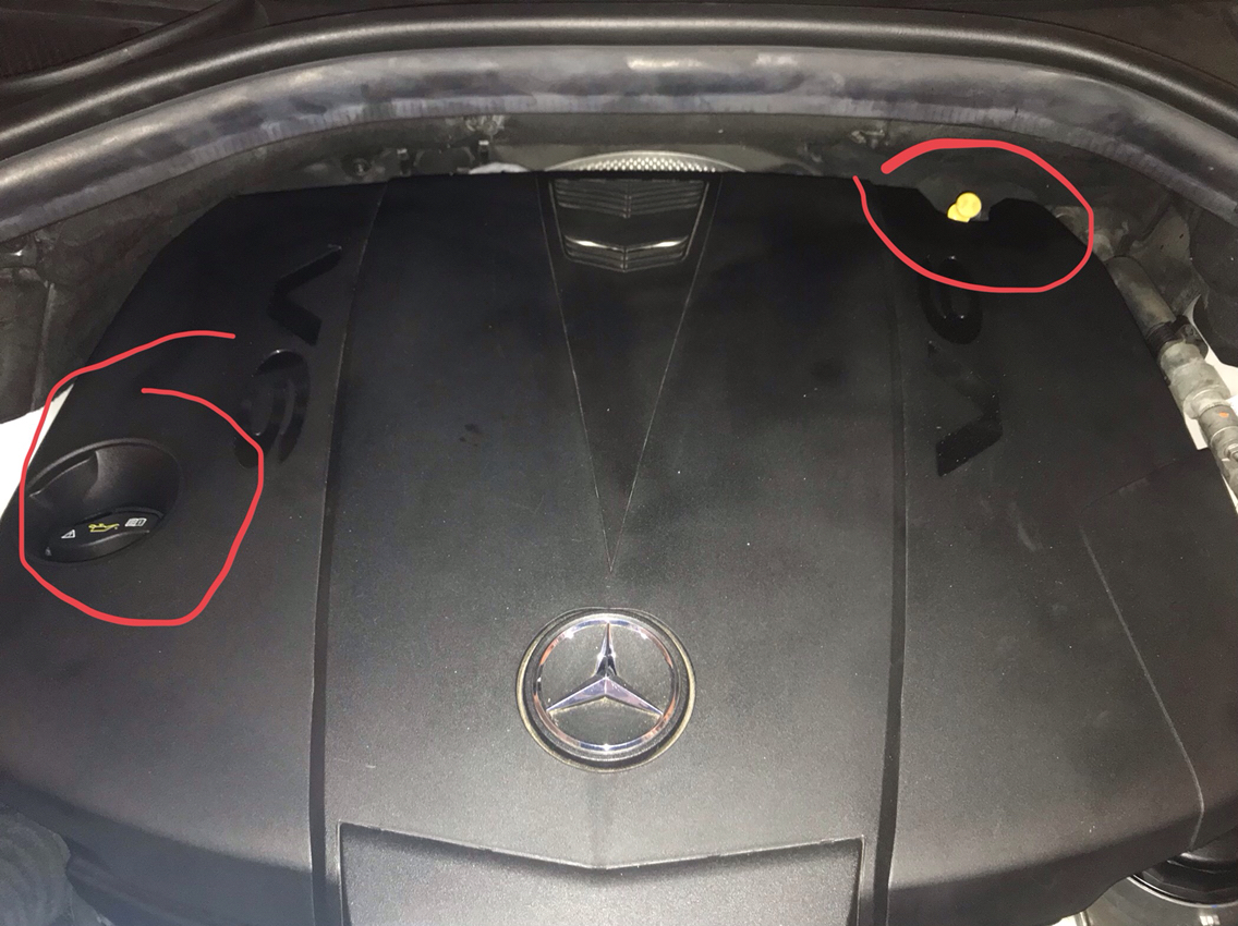

Hi All,
2014ML blutec 85K on it. Developed some leak pics attached. Taking it to a indi shop for evaluation. But more likely will join the famous club with membership around $3K.

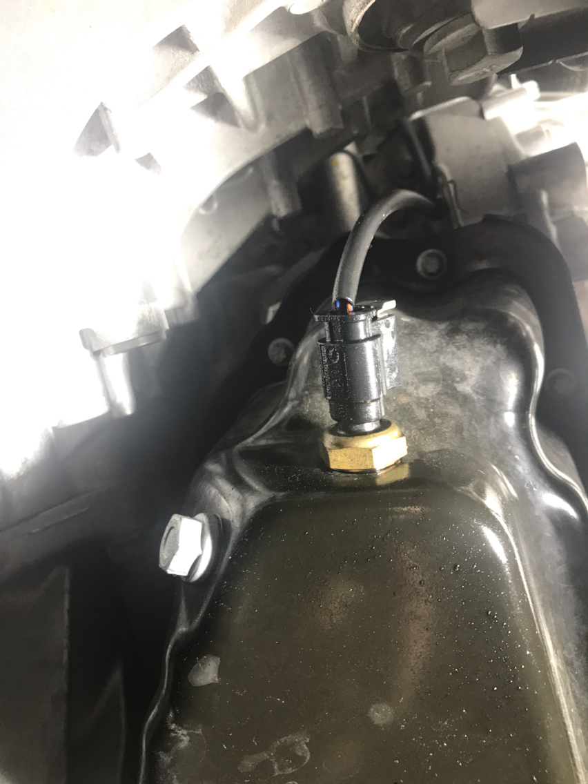

Some updates, indy shop can't take it till the 26Th. And as Peter mention it should leak towards the back of the engine and trany.
That gave me hope, so I got under the truck.
There was a lot of oil, most of it on the passenger side.
The oil pan looked strange, oil all the bolts
But also around sensor.
At this point I was thinking I need new oil pan gasket and maybe sensor.
Because its so confusing, and it is the lowest point I decided to clean it all and drive.

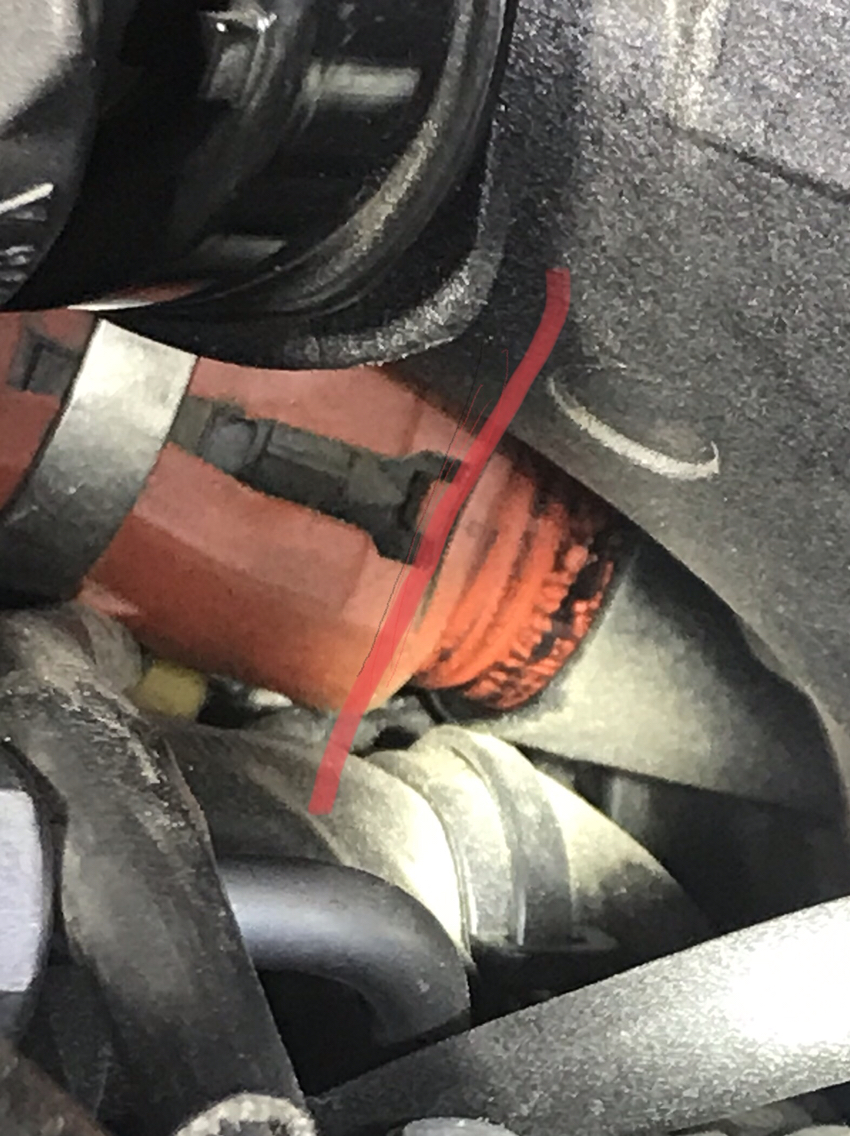

When I got to the left side, I notice the front of the car has oil all over, so cleaned that, than it was oil on alternator.
Alternator is right above the oil cap, there is a rubber around it, took it off and it has some oil.
At this point I was wow, maybe its just oil can gasket simple as that.
Than I notice oil wet spots on engine cover,

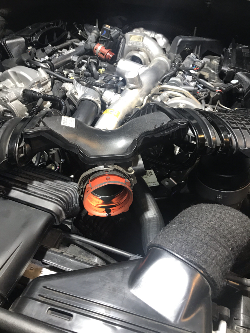

Its definitely signs for excessive pressure, so I had to take air intake off.
It was way more oil that it was last time 15K ago when I took it off to get to the fuel filter.
After cleaning installed the air intake back without connecting bent tube. Started the engine and air does comes from the vent tube so thats ok. Could be faulty valve but because the air with some smog coming out it looks like ok.

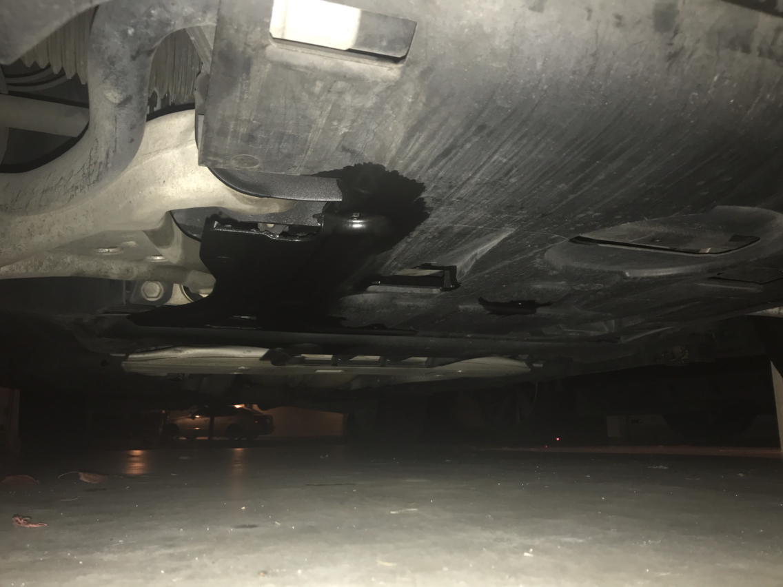

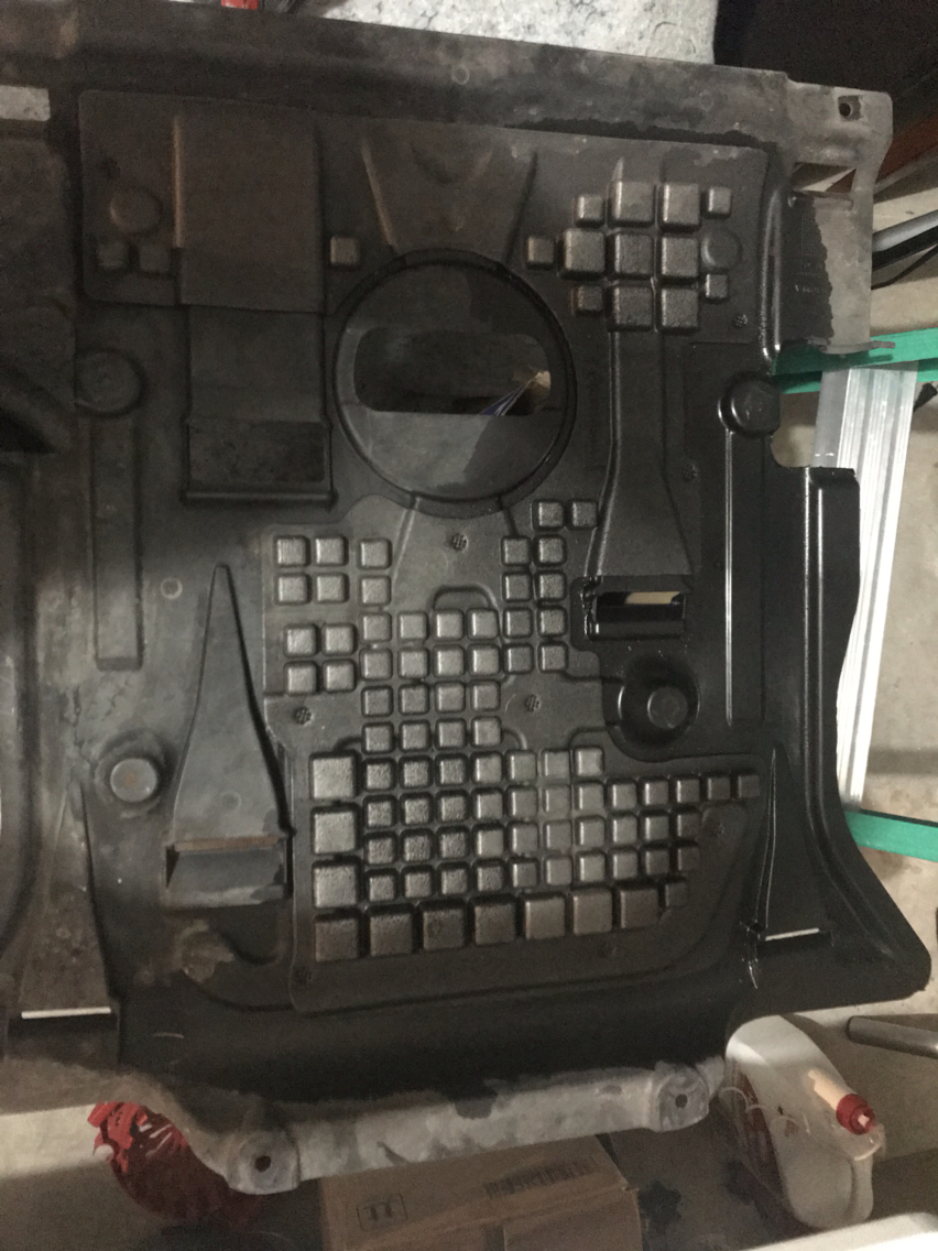

I thing I will pass this time joining the club. After cleaning and replacing a few seals, two days not even one drop.
Still unknown where originally oil came from. Because it was on alternator I assumed it came from oil cup.
Bottom engine cover show kind of a lot of it
For now, Im still happy owner of ML.

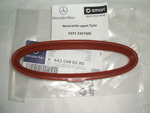

do you have the PN of the Breather seal and turbo seal? That doesn’t look like the one I purchased.
And thank you for your help.

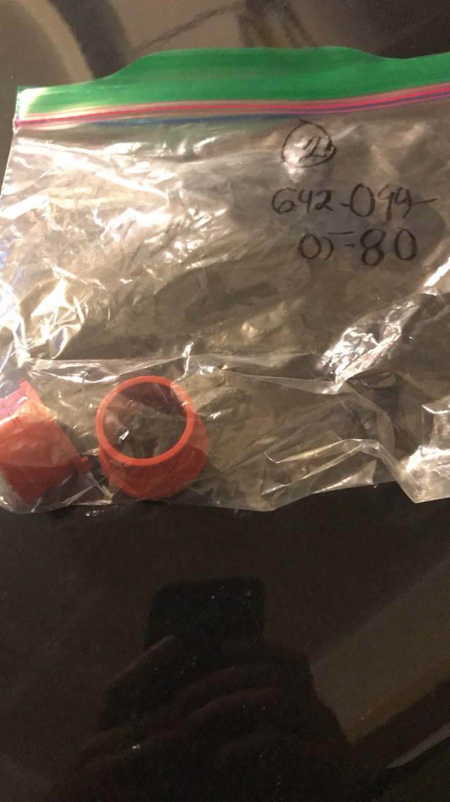

This is breather seal, if you have original as mine, cut it by the edge.
Turbo seal
Attachment 418664
Turbo seal
Attachment 418663
thank you sir! Looks like I got the same stuff. What do you mean cut it by the edge?
Old Nov 22, 2018 | 09:03 PM
DanD.'s Avatar
Joined: Apr 2016
Posts: 1,124
Likes: 205
From: NW
2018 GLC 4MATIC
Right this way,

the orange turbo inlet seal should be replaced with oil changes they only about $25 and easy to do.
but if u got oil leak at the bottom it may be oil cooler
