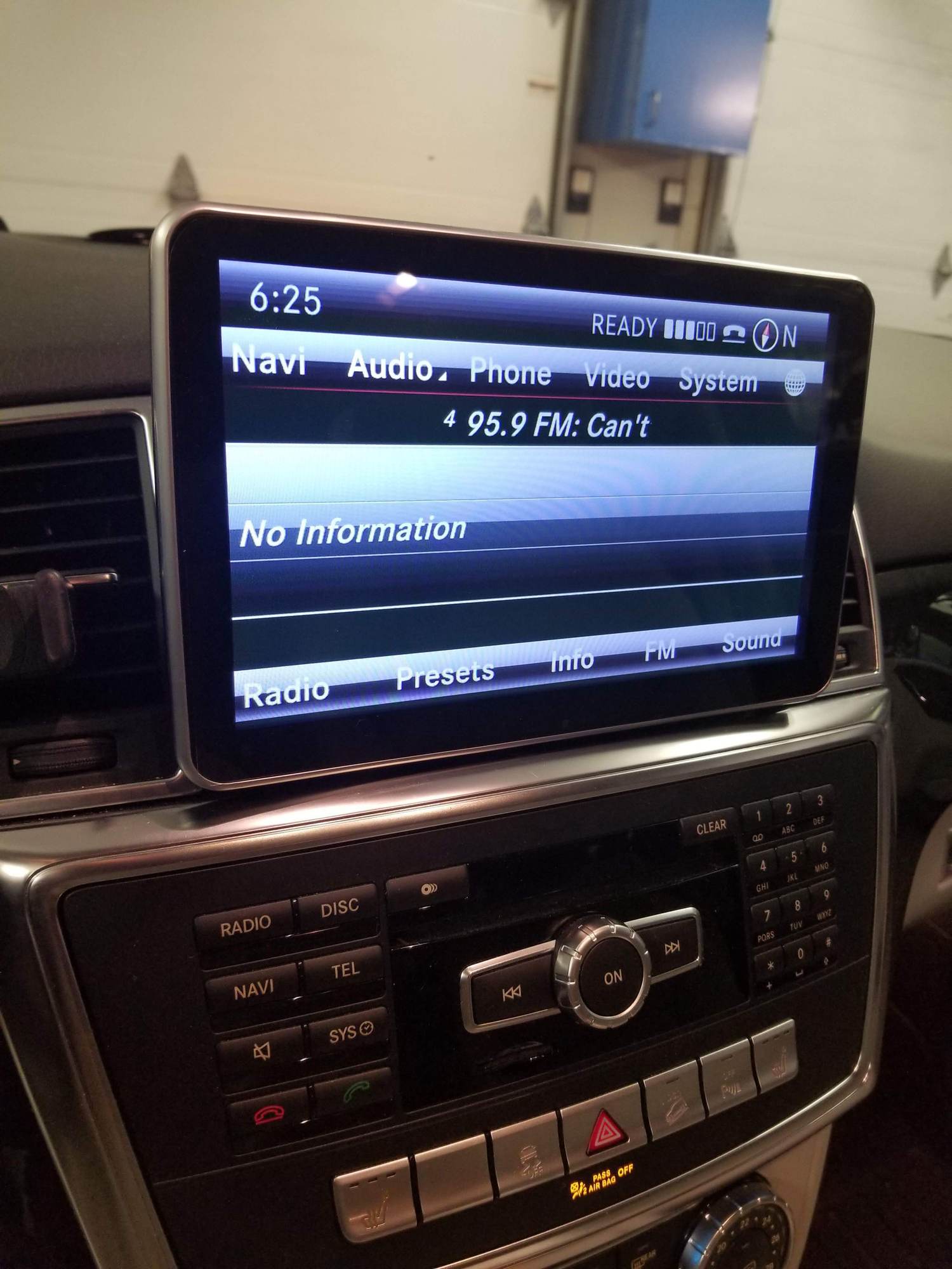

Good on you for tracking down the sources of the noise(s). We initially had a very slight rattling behind the dash around the nav screen, but I swapped the screen out for a 9" version and everything is packed so tight in there, the noise somehow went away.

Glad your rattle got fixed. Tracking down the rattles was not that hard. This car is pretty easy to work on as well and not overly complex. Poor dealership service is not a brand issue its a dealer by dealer issue. I have owned cars from Ford, Hyundai, Dodge, GMC, Mercedes, Tesla, Porsche, Maserati, Ferrari, Nissan, Dodge, Honda, Lexus, Infiniti. There are good and bad dealers/service centers for each one. My issue is that where my ML is located (Capital Region NY) we only have 1 MB dealer and since my ML has a warranty I would use them until out of warranty then use my indi shop. The nearest MB dealer is many hours away so I am stuck with this one and it is not that good. Post pics of your 9'' I am curious to see it.

Nothing to see, really. I doubt that anyone would realize that it isn't an OEM set-up. I just wanted a bigger screen like on the newer GL's. And since I'd wrapped the truck and not reinstalled the rear badging except for the Star, the only way to really tell that this truck is actually an ML and a Bluetec is by the rear valance (no tailpipes).
