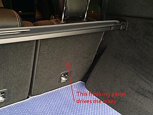

I have spent several weeks trying to get to the bottom of a rattle coming from the rear. I think I was finally able to isolate it to the vibrating back panel on the rear seats (see attachment). If I punch it lightly with a finger, it elastically bends back and forth in a very short span, but that’s enough to make a rattling noise. It appears that this panel is not glued properly, or otherwise affixed to the surface.
I would be grateful to you, W166 owners, if you could perform a quick test with your rear seats and advise me on whether or not this panel makes any noise (or vibrates/bounces) when you flick it somewhere around the middle. This would greatly help have a meaningful conversation with a service advisor.
Many thanks.

tried on mine and didnt get it to do any noise. I have 2 baby seats with top tethers tied to the hooks so maybe that holds it better in place?

No sound from mine. Does not seem to flex.

No noise in mine from the seatback..
However, on occasion the cargo cover will rattle if it's left open and in a position in which the stops on the cover make contact with the metal bar that the cover rolls up into. I hope this makes sense.. I first noticed this about a year ago and it drove me nuts, at first I also thought it was a panel..
Anyway, could it be this??

Yes there is an outer and inner panel it seems at very near proximity..with slight tapping they can be made to hit each other and cause a mild clicking noise...I've never noticed nor heard any noise from mine but now will be listening for any so thanks for that..
j/k mine is quiet..drive a screw into it

It could be the retracted rear seatbelt is rattling against the "C" pillar. There's a small clip on the "C"pillar used to secure the seatbelt so the belt doesn't get caught when you fold and then raise the seat back.

I have double-checked – it is definitely not the rear seatbelt. The clip in question holds it well. The cargo cover also makes no noise or rattle.

I can reasonably assume the source of the noise you're hearing although I don't get that rattle from mine..did you try to see if it goes away with the seatback folded forward ? If you prefer not to offer the opportunity of repair to the dealer I'd suggest maybe applying some heat via a heatgun to that panel and by possibly moderately altering the physical characteristic will stop if from rattling..just a thought

A little off topic but I remember one of my LX570 unit's made a noise at the rear seat and I stopped it by reclining it into a different position. The noise after months never returned.

That's a very good point! I will definitely try that.

I do indeed want to perform some assessment before allowing anybody to touch my car. Your ideas help provide options that I can try - and much appreciated!

I heard the rattling from the rear seats again... My suspicion is the pillar on the floor behind the rear seats ... theres a white trim plastic clip that goes into a black plastic looking box by the top of the spare tire and the clip appears to not fit correctly in the plastic box (causing unnecessary play) I changed the clip to a bigger one and now it sits more tight. Hopefully this was it.
