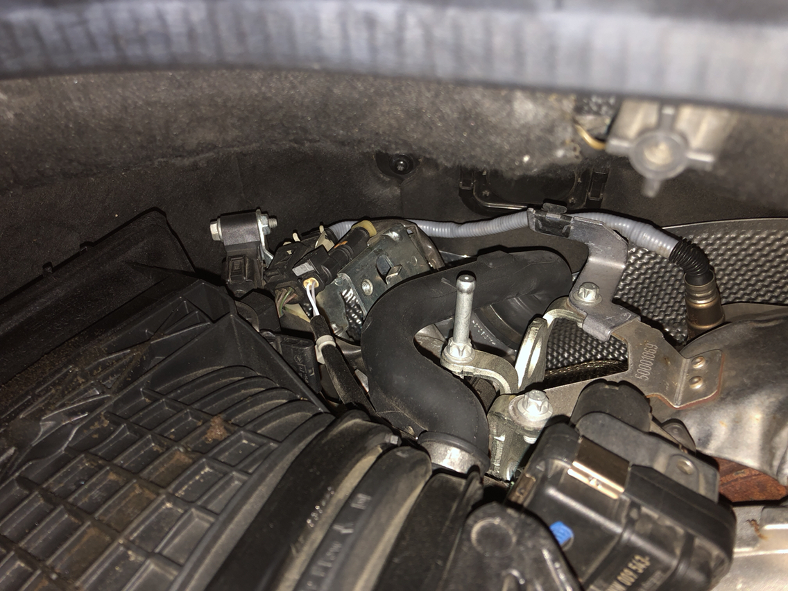

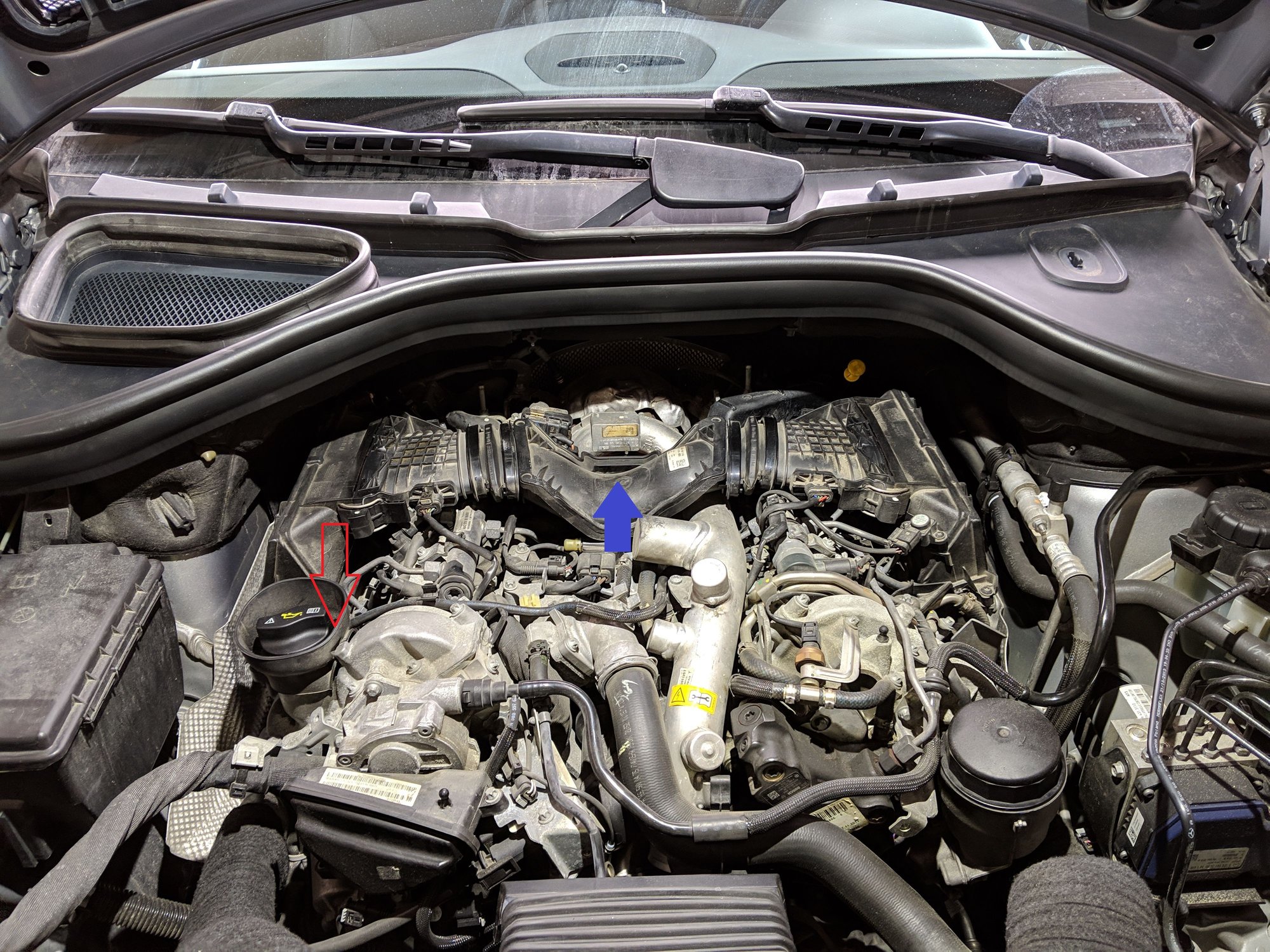

hey all,
been doing quite a bit of work and tinkering on the car lately, trying to fix/patch up any problem areas. Found 2 spots with some oil/oil gunk and wondering if it is at all normal due to regular heat and oil vapor from under the hood, or if i have some parts to look at and replace to seal things off. Some of the work that has been done recently on the car: oil change + oil filter, new engine air filters, new cabin and dust filters. This past weekend i put in a new fuel filter and also replaced some o rings and gaskets for parts that needed to be removed to put in the fuel filter. I put in the engine air filters about 500 km's ago, and when i did that i also cleaned up a bunch of old oil gunk on the engine, turbo, and connector tube from a past turbo oil leak, so this past weekend when i saw some oil i knew it was fairly new.
1st spot, right around the oil fill hole and cap (1st pic red arrow). That rubber boot around the oil fill cap, on the right side of the boot there was a tiny bit of oil gunk that when wiped with a clean rag came off indicating either some oil splashed up out of the oil fill hole, or some vapor had escaped from the oil fill hole and caused the gunk build up.
Should the oil fill cap have an airtight seal on there and have 0 vapor/seepage? or is a little vapor escaping and causing some gunk on the rubber boot normal?
2nd spot, connector tube and turbo inlet (1st pic blue arrow). i had gunk/oil here before, this car had a turbo oil leak in its history, but i cleaned it all up when installing the engine air filters 500km's ago. No oil was leaking anywhere as all the gaskets were doing their job properly, but when i removed everything there was a very small pool of oil on the turbo inlet, there was also some oil vapor/condensation in the connector tube that i could easily wipe away with a rag, and there was oil on the pcv gasket sides (2nd pic yellow scribbles). I had gaskets and o rings and replaced a bunch of stuff when changing the fuel filter, turbo air tube o rings were replaced, pcv gasket replaced, engine air filter gaskets replaced, and turbo inlet/connector tube gasket replaced also.
Now i know those gaskets will help prevent the oil from leaking, but what im wondering is if there should be any oil in those spots at all?
I've heard of pcv issues and needing to replace/clean them, but is some oil in these spots normal for even a properly functioning pcv, or if the pcv was properly working would there be 0 oil?
I'm just not sure if i should be looking into possibly replacing the pcv, or maybe looking into fashioning an oil catch can if some oil getting past the pcv is normal, thoughts?

just wanted to post an update.
i purchased a new engine oil cap and that fixed the small leak of vapor on the rubber boot. looking at my old cap and the new cap, the part numbers are different for the caps.
for the other part, i tried to get back to the PCV bolts with a wrench or a socket, but it doesn't seem like i can get in there as space is very tight. i also have been unable to find any youtube or online resources indicating how to remove that PCV housing.
on my most recent check there was again some oil in the turbo inlet and some in the turbo gasket, but it was all being contained by the gasket and wasn't leaking anywhere. i'm going to leave it for now and check on it once in a while to make sure nothing is leaking or turning into a problem.

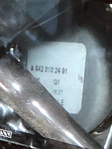

Intresting, not sire about your car year but mine is 2014 and when I asked mbdirectparts
They told me the part number is
642-010-37-07 BLEEDER V 500 0 1 X 162.14
https://www.mbdirectparts.com/oem-pa...lve-6420103707
Its on order and Im planning to replace it as soon as it gets here, the reason is because there are some oil residuals around oil cap and dipstick.
This is funny:
Here is what they think part number should be
mbdirectparts - 642-010-37-07
Two local dealers - 642-010-17-91

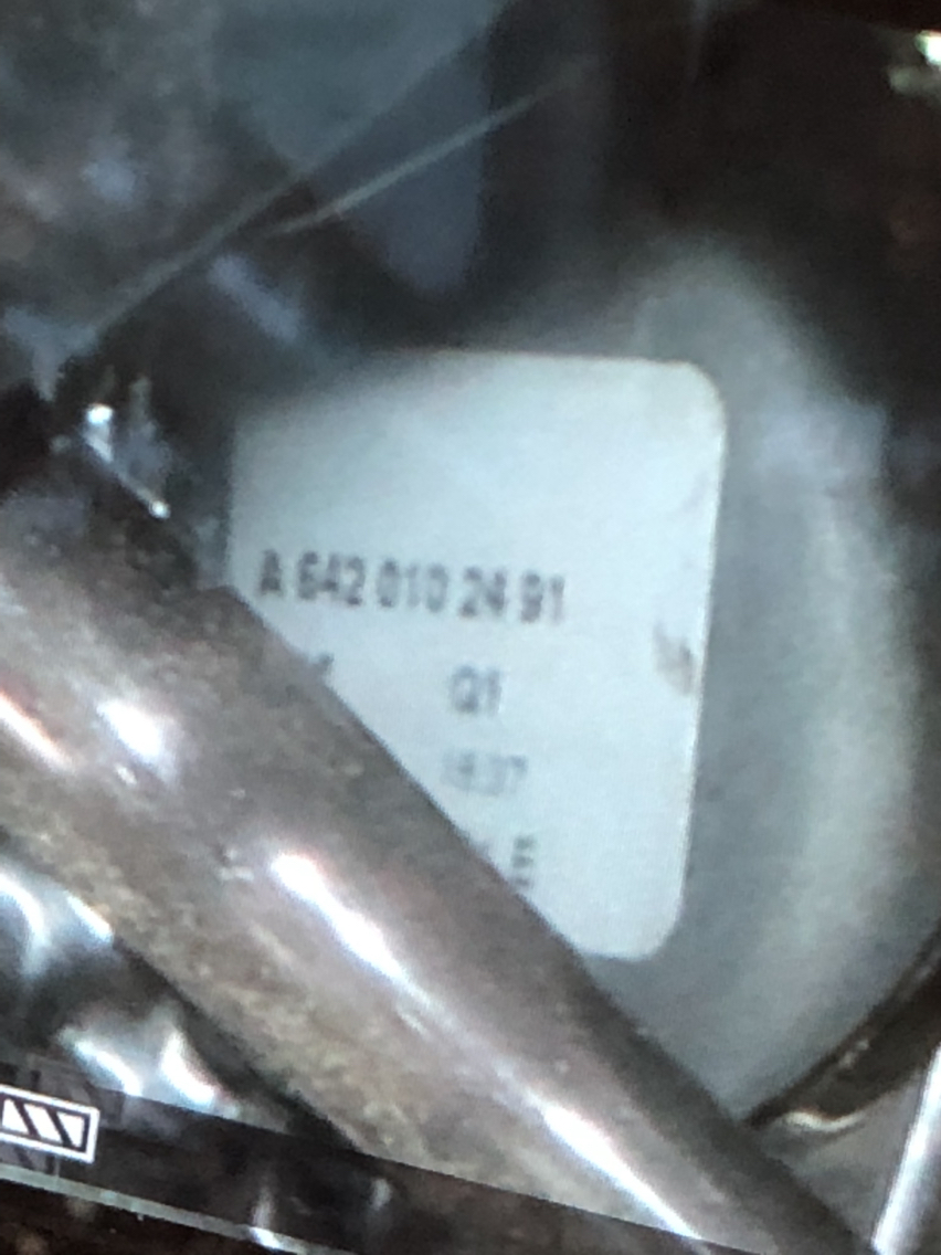

So I took a little mirror and start looking, original part on the car is 642-010-24-91
So Im leaning towards 642-010-17-91

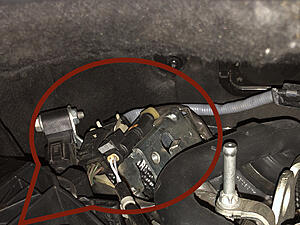

ive seen that video, unfortunately, the car is different. my valve doesn't look like that, and it is also not that easy to get to. its been a while since I've been on the forums, I've just left things as they are since I haven't been having problems.
Dan, any updates? did you end up getting the part and replacing it?
Yes, the engine is not the same as we have, its just an idea.
Yes, i have bleeder replaced, yes its real PITA. Especially I was dumb enough and let bleeder bold dropped twice, so I had to jack the car and remove cover to find bolt under heat shield.
Anyway, you need to take some parts off, air filter, air intake off the turbo, and all plastic pars on the left side.
Loose this, don't disconnect, when its lose it will give you enough room to move around.
After it was changed I still have some wet spot on engine cover near dipstick but much less.

Originally Posted by Babukb2
when you say loosen this, what in the picture are you referring to?
what tool did you use? socket or wrench and what size?
and did you come at it directly from the front/over top, or did you get at it from the left side where you removed the air filter?
I was referencing to this, its attached to block with 3 bolts.
I have used socket and short very small driver, because of space limitation. Sorry don't remember the size. Small mirror will help too.
I got to it from both sides, from passenger side, remove all plastic covers the same way as you do when replacing dust filter.
One side not, when I pull both bolts out, bleeder was still crazy tight to the block, had to use a lot of power to turn it after that was very easy.
Try not to drop bolts when you put them back, PITA to get them, they dot fall all the way to belly , there is a heat sheet and it gies right behind it, very hard to find and retrieve.

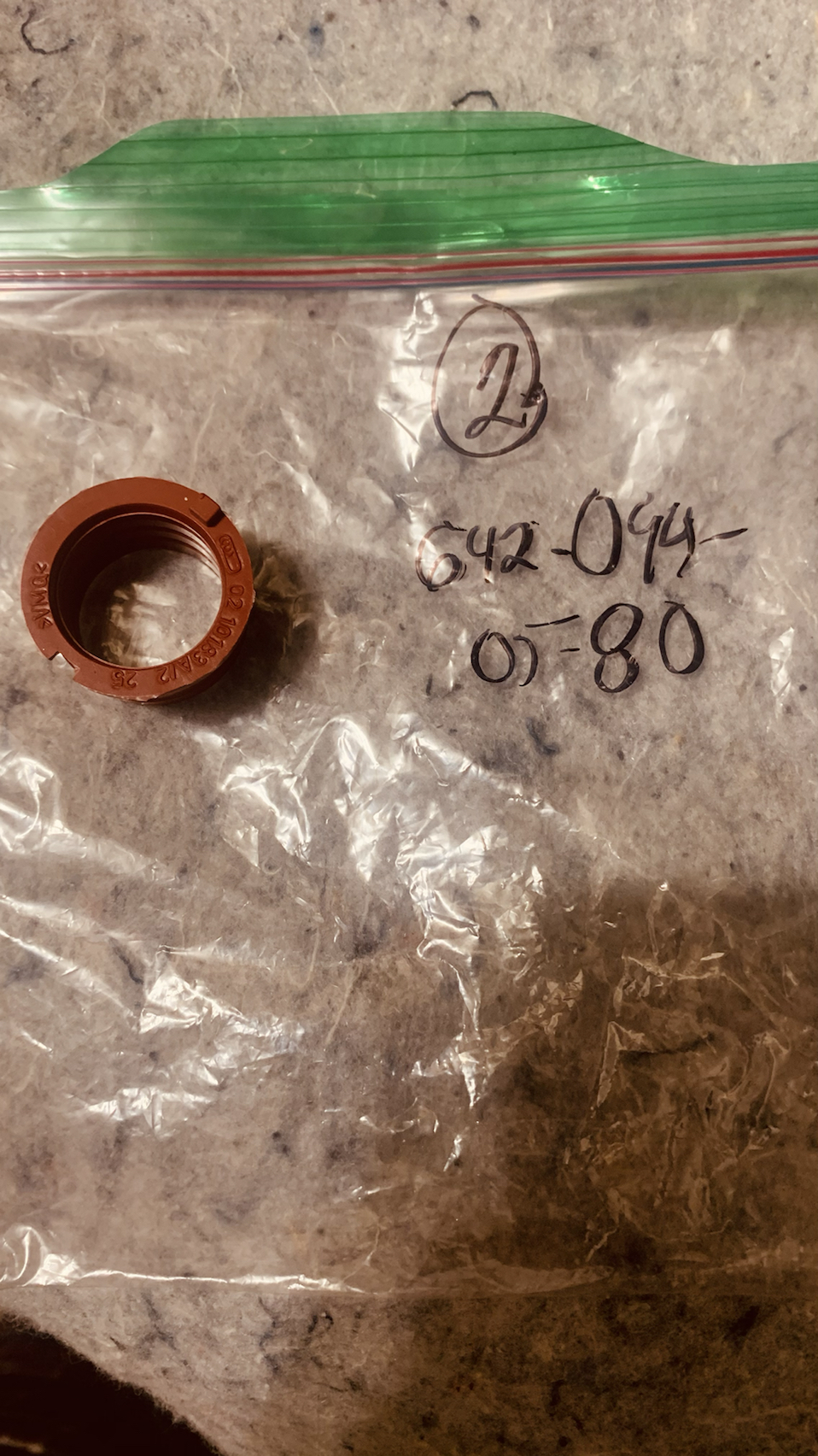

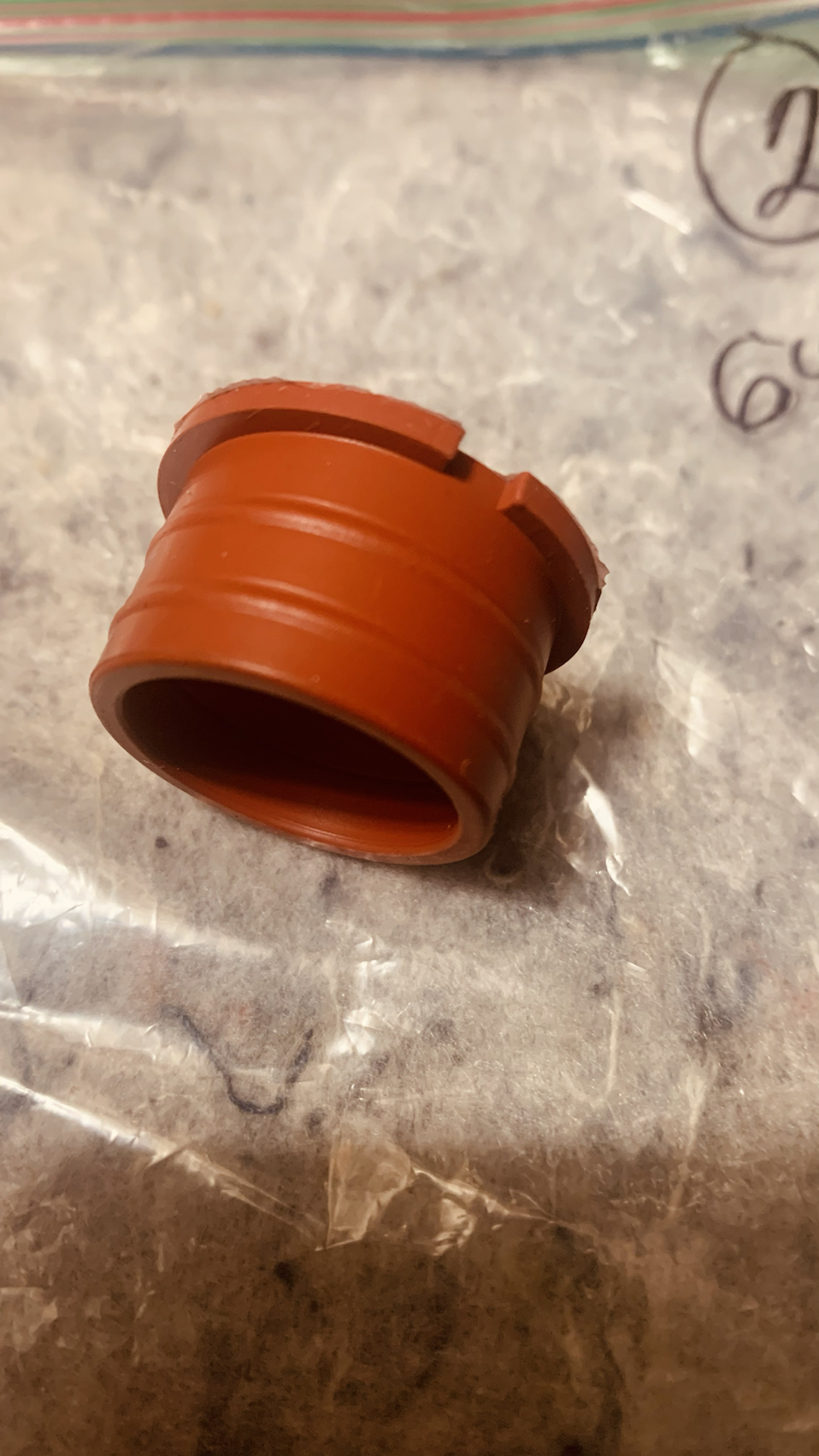

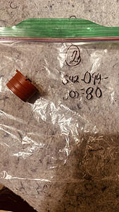

Originally Posted by excal
Yeah, here I think: https://mbworld.org/forums/diesel-fo...ml#post7896392
I'm skeptical about using the old style gasket though, given the wraparound style is supposed to be the new & improved design. Did you get the same part 642-010-17-91, and was yours missing the gasket as well?
I had gasket. And new part looks like this.
You need to cut the old gasket, if its there.
