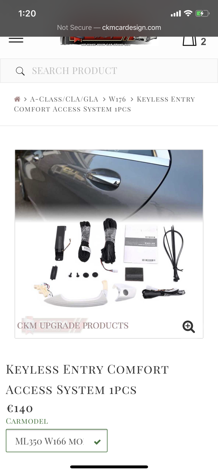

Well, i found this offer for one handle, it is not too expensive but i’m still considering if it worth the money !

your browsing the store of a user that used to post here, Make sure its for the ML because that door handle you are seeing are for the redone Doorhandles that MB did.

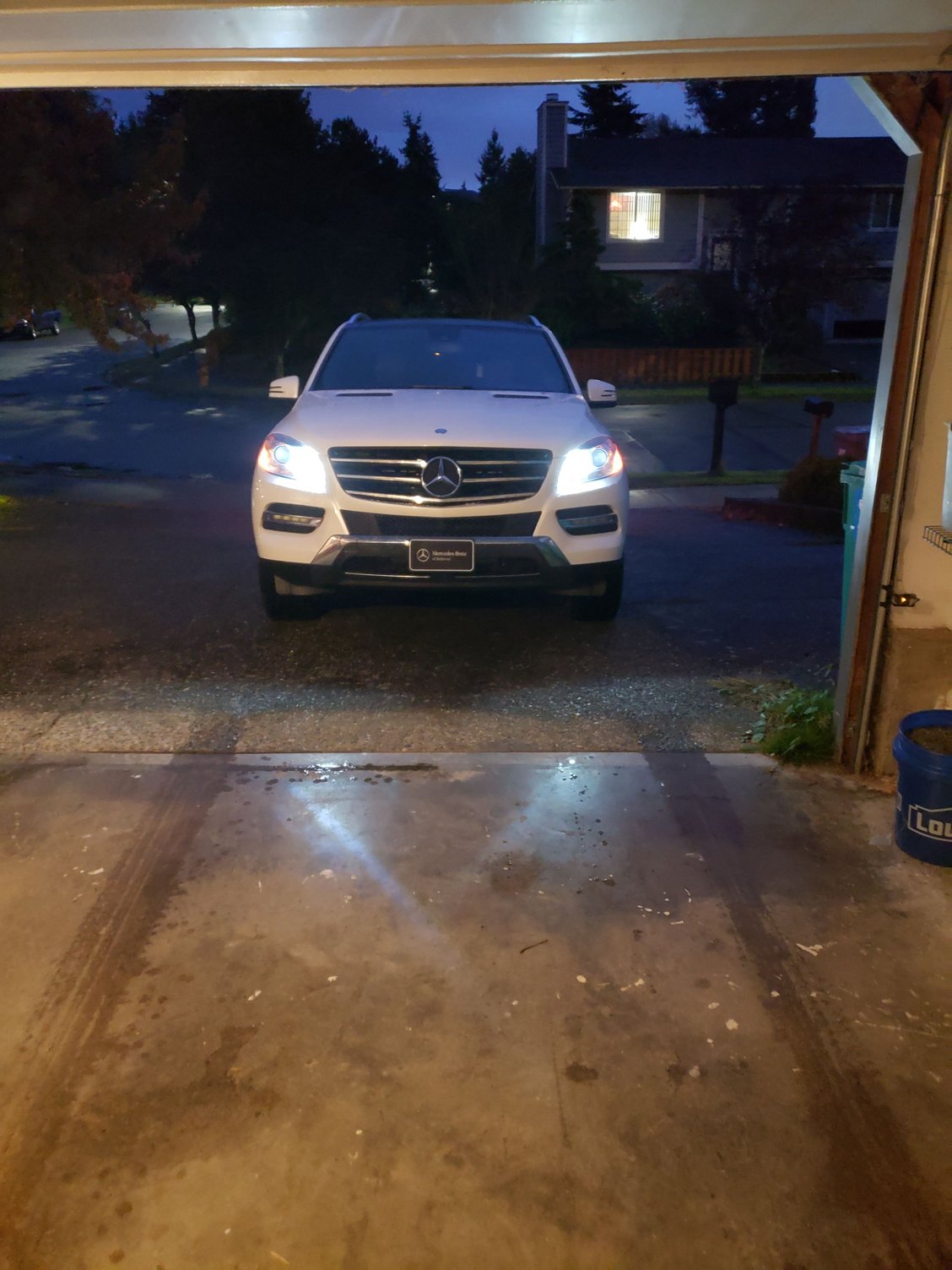

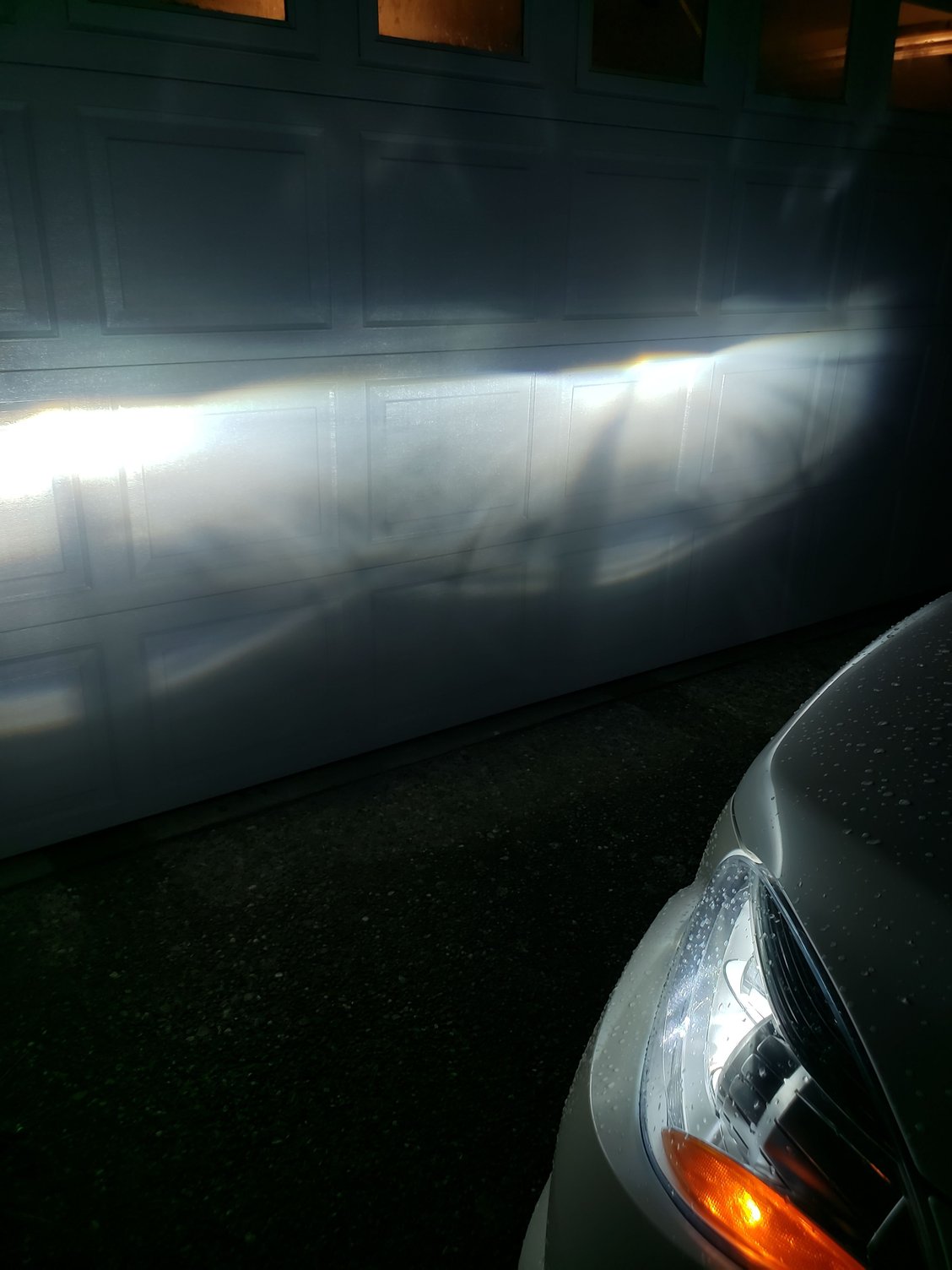

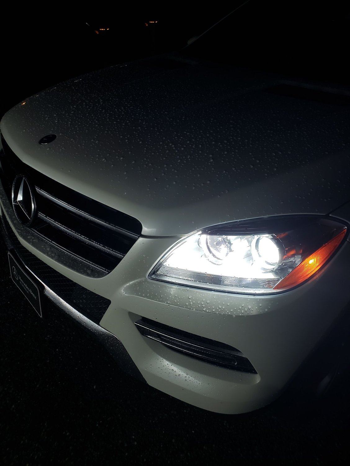

AZN Optics Installed
Pix of AZN Optics HID Conversion and their Parking LEDs installed.

Looks great!

Thank you and thank you for the amazing service! Couldn't be happier with the lights!
