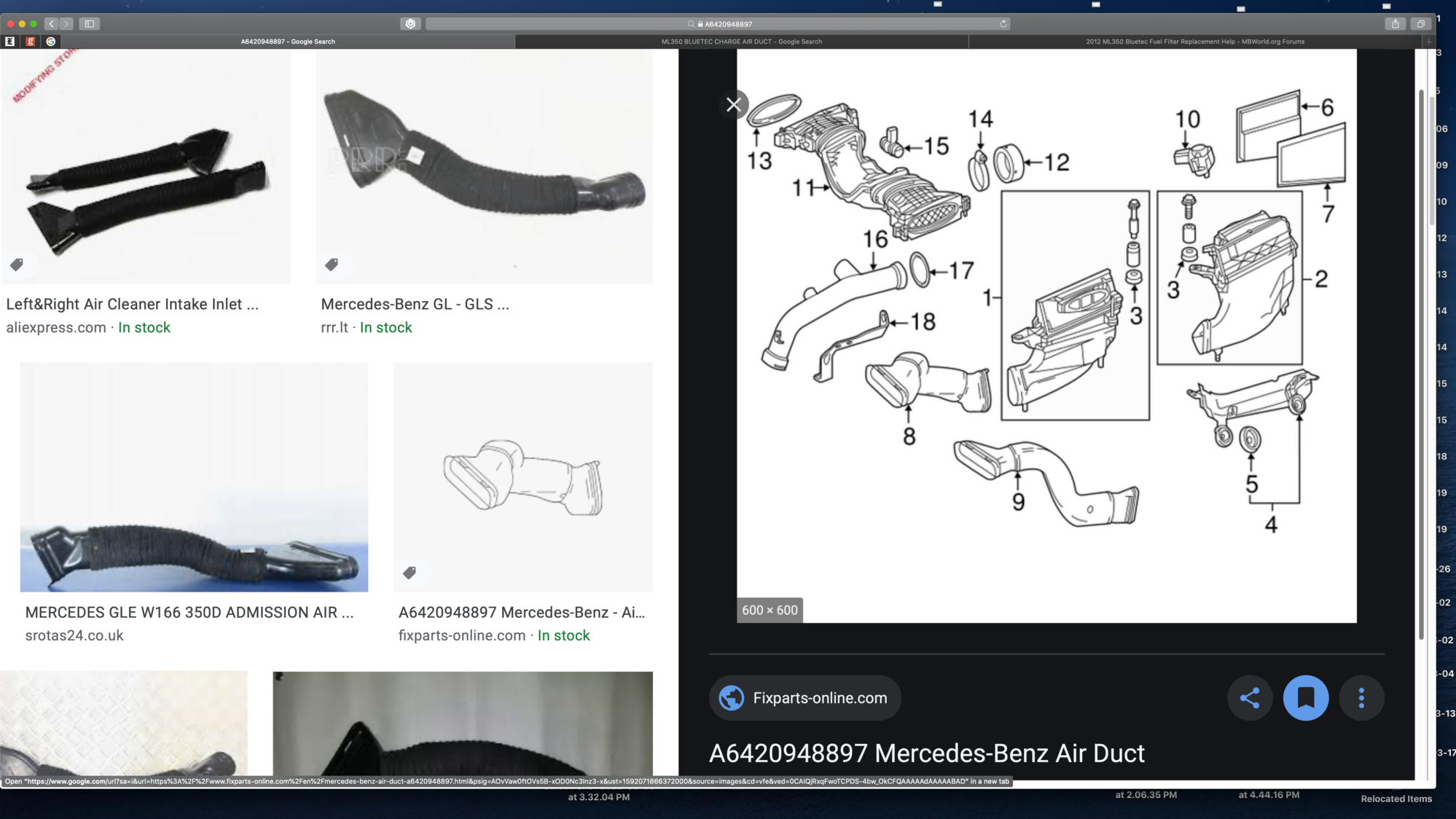

Item 15 in the attachment
Just what is number 15 in the attached diagram, please?

Heater to heat the air that is being drawn from the crankcase as it flows into your intake. It should be replaced periodically as the rubber does deteriorate and leaks oil.
