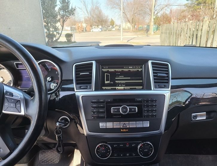

Here's my before and after

I have no sound from the unit because I have AUX issue but it had nothing to do with the unit, I made a post asking for help. https://mbworld.org/forums/m-class-w...-no-sound.html
So far here's my review, the unit boot up in less then 20 second, I even change the boot up logo.
Android Car (Carplay) work great once you have it setup.
Original NTG fully accessible, 360 backup camera work but it's less bright for some reason.
4G SIM and hotspot for the kids work flawlessly. I put the antenna under the dashboard just behind the screen and always have full bars
GPS works also, I have the antenna on the dash on the corner of the driver side, pass the cord along the edges, in dash by the side panel all the way to the unit.
I have a GPS splitter coming because at first I wanted to use the OEM antenna but I don't know anymore since it's working fine. will see in future.
I also bought a DVR camera for ADAS that should arrive within a week, I ran the USB 1 of the unit over the glove compartment in the dashboard up to the side panel where the fuse box is. will use it for the DVR camera. USB 2 I put in the glove compartment.
I ran AUX out under the center console coming out from under the central compartment.
Very happy with the Unit and fairly easy to install after viewing a few videos and I'm no mechanic.
My only CON, it's that there's no instructions at all, not for installation and not for settings configuration.
Thx to the help of the community there's some great videos for the installation.
For the configuration, so many options in the setting that I have no clue what they are for and if I should use them.
