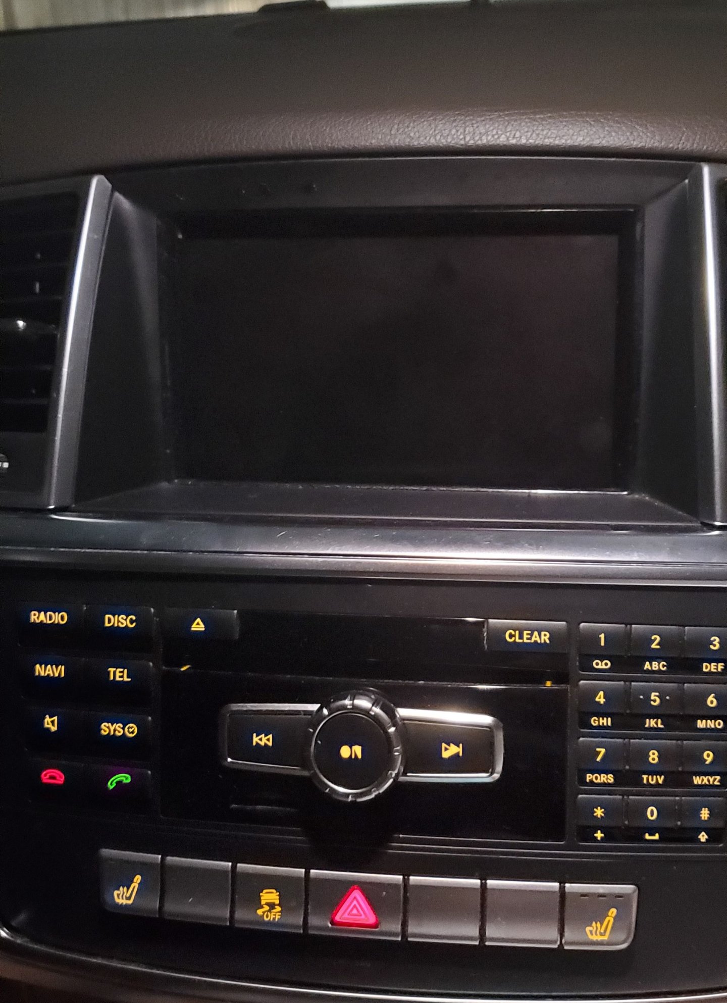

Hey all 👋. Anyone know how to reset the Comand screen? My radio unit works fine but the screen will not come on at all. I tried holding down the eject button and also the power button. Anything I'm missing? I'm trying to avoid the dealer if possible. Thanks
There should be a button on next to the clickwheel, send me a picture of the clickwheel with the buttons next to it, i'll tell you. (3 years since ive been in a ML)
See attached

Try the bottom right or bottom left buttons.
I just picked up a ‘13 ML and those two buttons turned the screen on and off.
See attached
Press CLR that should turn on the screen
nah that didn't work 😒
nothing happened. I just heard my navigation kick on😒

SOLVED!
I removed the fuse #100 and #21 let the car sit for about 20 mins, replaced the fuses and the screen came back on.
See attached
Clean your clear....Nasty
