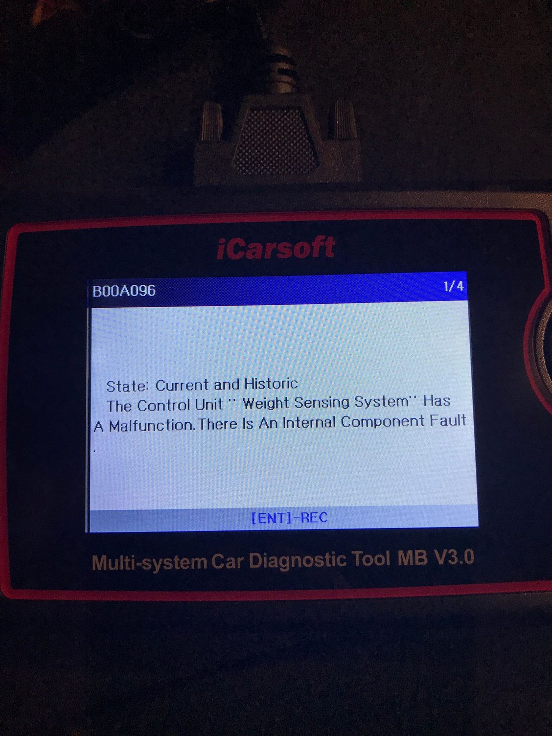

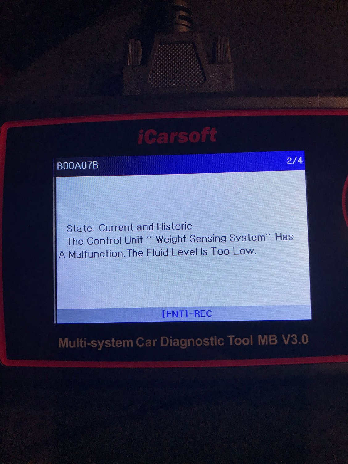

So I recently addressed my intermittent passenger SRS light by scanning it with the Icarsoft MB V3. What came up was kind of confusing. Does anyone know what could be the problem?

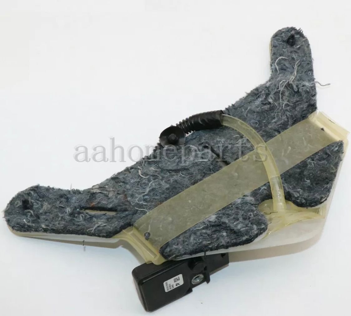

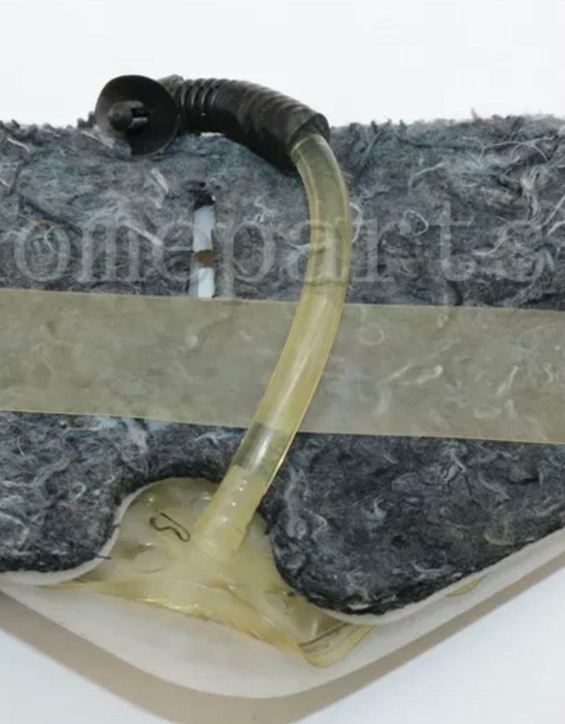

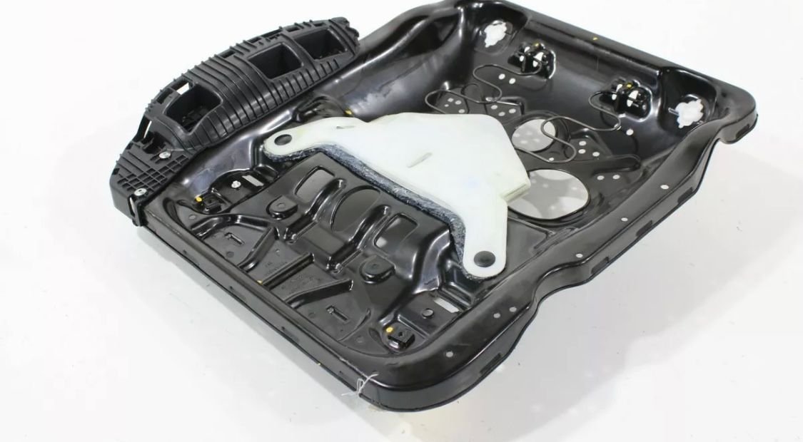

so apparently there is some kind of fluid in the weight sensing system. Anyone ever change one of these out? Will there need to be calibration?
