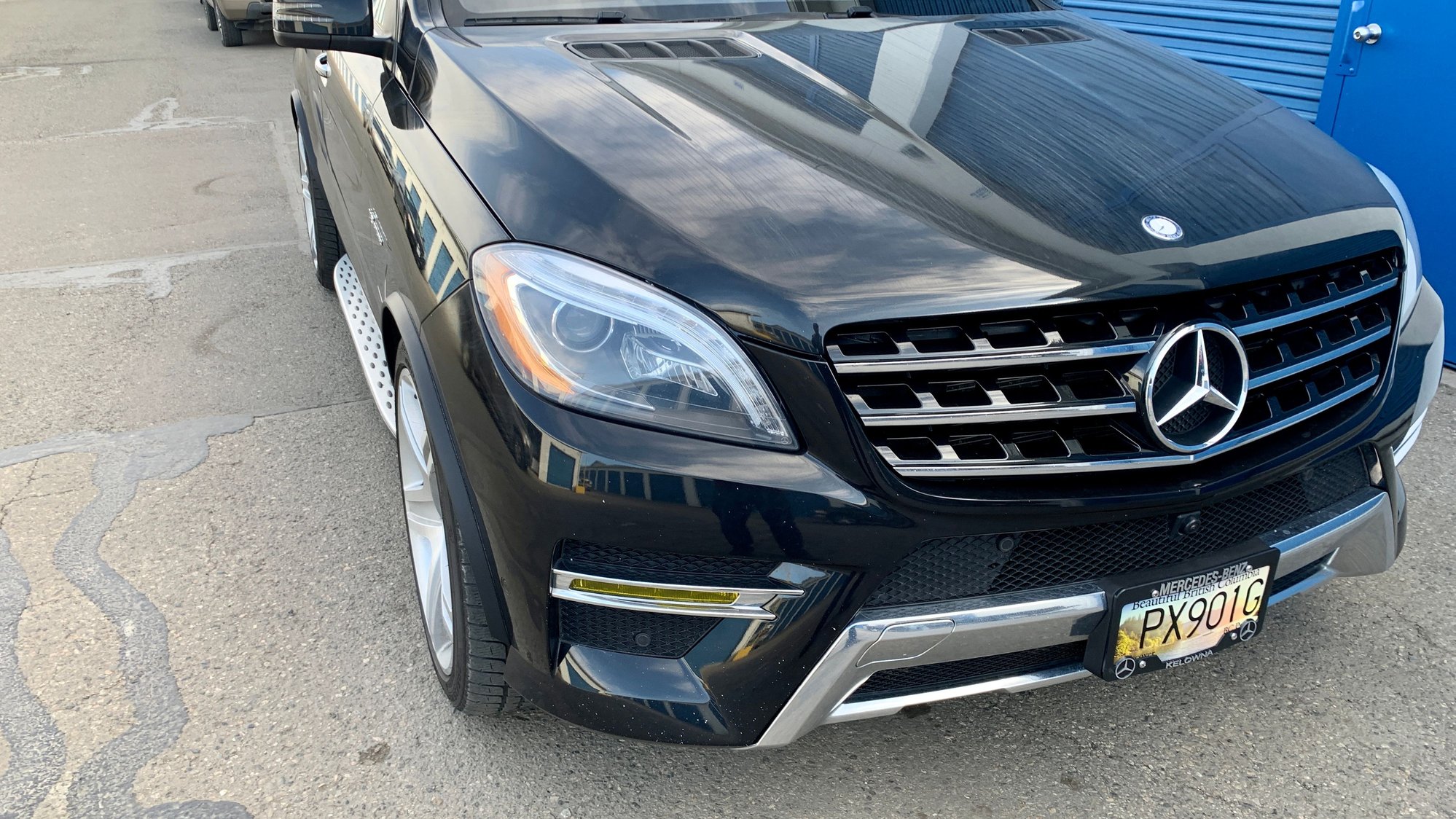

Changed the DRL’s to yellow. Vivid deep yellow headlight tint film. Sure stands out a lot. I don’t think it’s legal but it looks cool. And it seems twice as bright as the white color. I was at the Mercedes dealership today and they were all very confused by it haha. And everyone there needed to know how I did it.

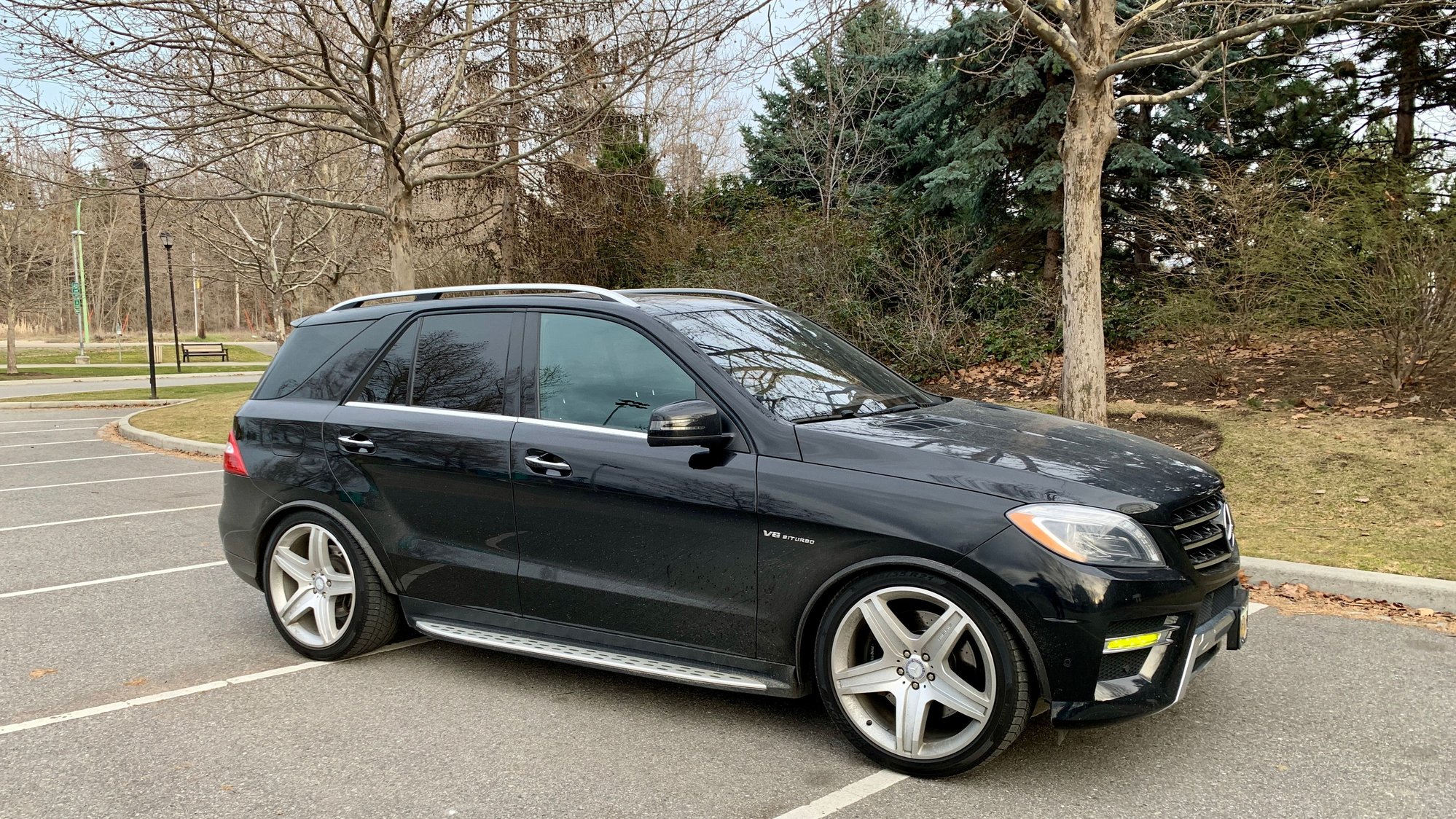

Added some fender flares to protect the paint from the wide wheels. Drove to Vancouver last week over the mountain passes and just trashed the paint on my front bumper. They use a lot of sand and gravel here on the roads. Broken windshield also… it was brand new 3 weeks ago. Guess I’ll be getting the front bumper repainted in the spring. Also my lowering links showed up today, so as soon as it warms up a bit I’ll get them installed. Not sure how much I can really lower it before the tires hit the fenders. It’s stock height in sport mode in these pics. I’m thinking maybe 3/4” in the front and 1” in the rear to level it out.

The fenders are a nice touch! are these universal flex? If so I assume they can't be painted? I ordered some GLE 63S fenders from CKM but now I wonder if I should go this route
Old Feb 22, 2022 | 10:13 PM
  #35
Doubleredrolex's Avatar
Joined: Feb 2014
Posts: 97
Likes: 18
From: Canada
2014 ML550 AMG package
Yeah they are universal flares made of soft rubber. They are the 1” wide. I got them on Amazon. I was also thinking about the GLE flares but they are expensive and have to be painted. These ones actually look pretty good and they work well, so I might keep them on for a while. They remind me of the black flares on the newer Mercedes SUV’s so they don’t really look out of place.

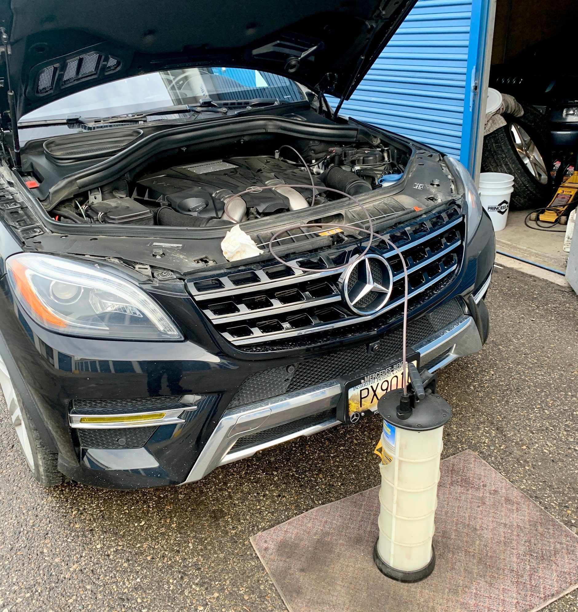

Break in oil change after 1500km. Oil was really black. No sparkles or chunks or metal so that’s good. Haha.
filled it with Castrol edge full synth 5w40 and 2 bottles of Liquimoly Ceratec.
Oil extractor. Pulled out 9.5 liters.

Mine is the extended oil capacity +800ml as per the VIN. It was aprox 9.5 maybe it was 9. Nine liters of oil plus 600ml of Ceratec went in and it’s right to the full line.

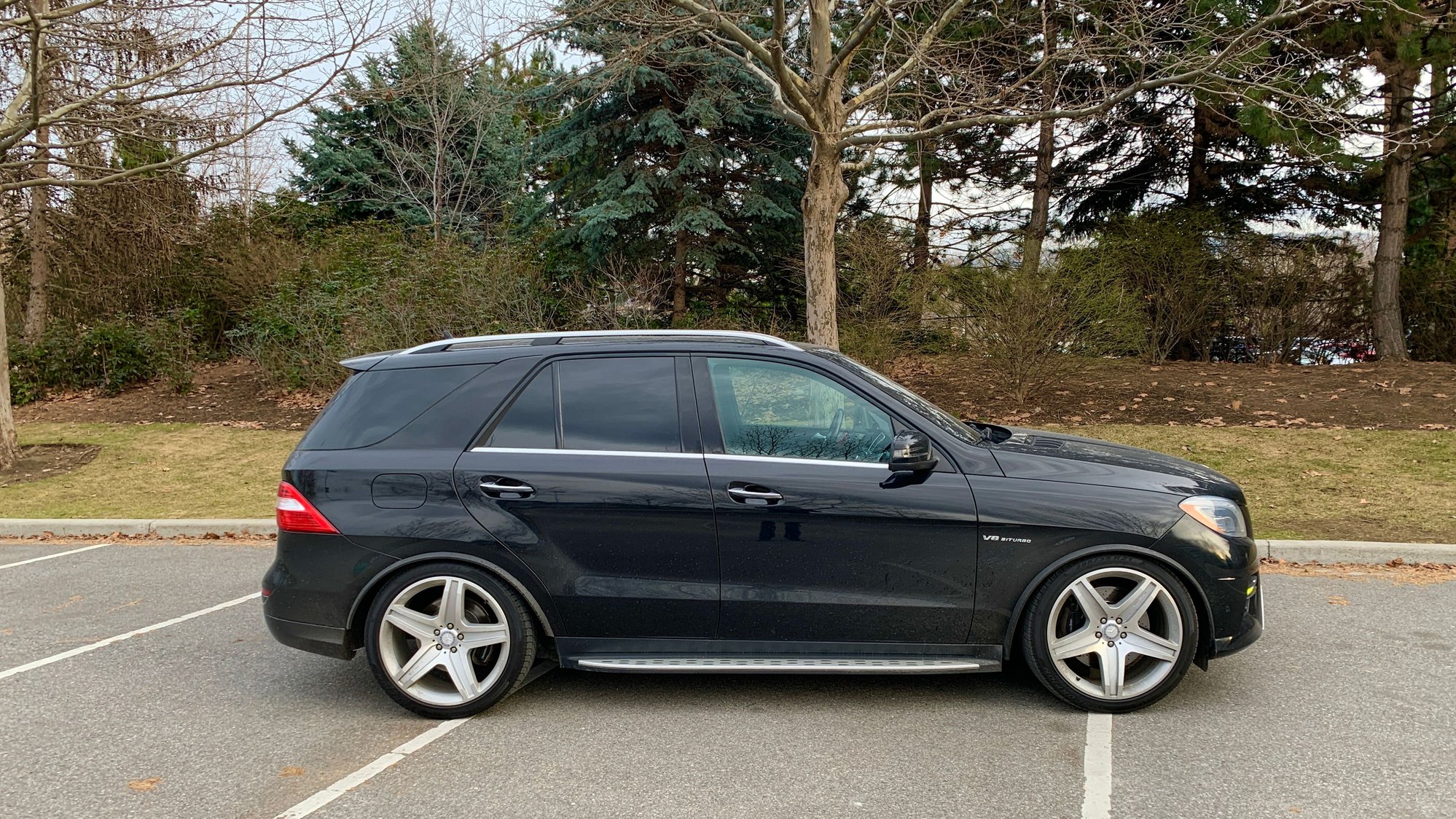

Got my lowering module today. Those wonderful canbus computer hackers from Most Wanted Mods make some cool gadgets. This lowering module is the coolest thing ever. Super easy to use. This is the -32mm front and rear “LOW” mode and it’s pretty low. This ML550 was already pretty low from the factory. I’ve got crazy negative camber now front and rear now. I’m going to adjust the rear camber bolts as far as they will go, and maybe raise the front up 10mm for now until I can investigate some options for the front camber adjustment like those Kmac bushings or whatever it is. The ride is noticeably stiffer in sport mode. Comfort mode is still smoother than sport was from factory. I’m very happy with this lowering module. Worth every penny. Sorry for the dirty ML in the pics. Didn’t feel like washing it because it’s going to rain more.
32mm down from stock
32mm down from stock.

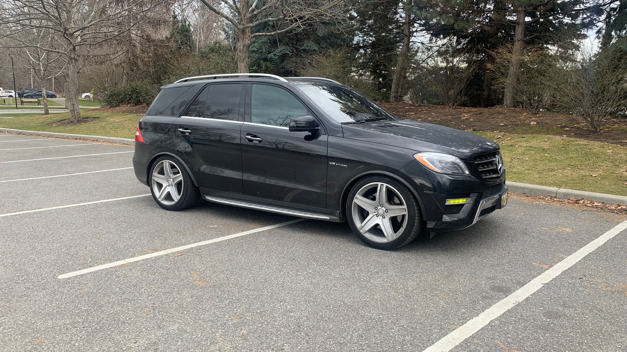

This is -30mm rear and -25mm front. More of a level stance. Not sure which I like better. It looks a little exaggerated in this pic because the ground isn’t level. I need to adjust the rear camber as soon as I have some free time. I’ll just set it so it’s the same as the front, or max out the adjusters, whichever comes first.

In the future, if you have the rubber cork for your evacuator, you can just plug the top of where you extract the oil and drain it that way. Gets more oil out from what I've heard.
Old Mar 31, 2022 | 08:11 AM
  #48
Joined: Feb 2014
Posts: 97
Likes: 18
From: Canada
you pull the oil out from the dipstick tube. It’s barely large enough to put the tube into. The only rubber seal is the tube going into the extractor and it’s like an inch and a half in diameter.
