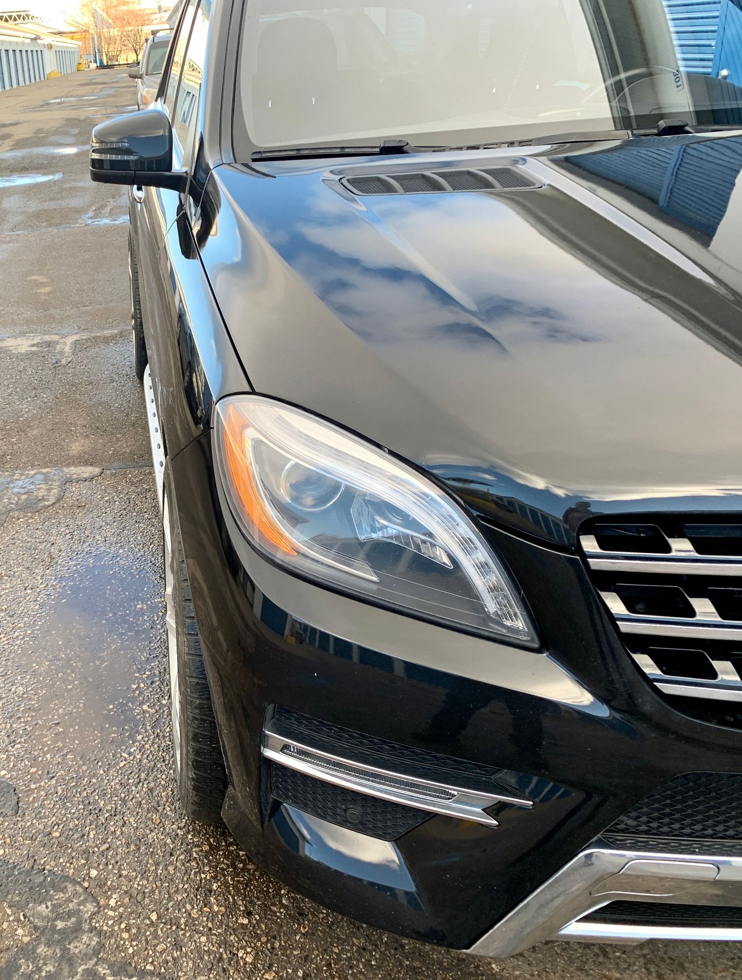

2014 ML550. All stock. Fully loaded with everything except Designo leather.
Love the HID headlights with the active curve light. They work really well.

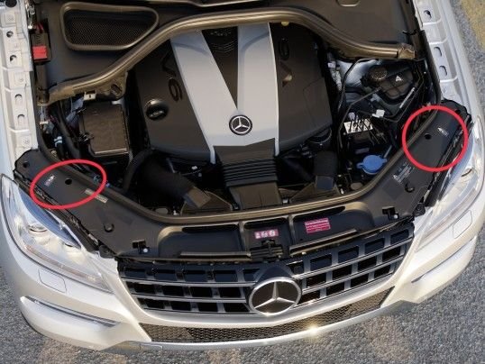

I gave my headlights 1.5 turns counter-clockwise on the adjusters to bring them up, and wow what a difference. They are aimed very low from the factory. Prob twice the light output now and nobody has flashed me yet so I think it’s about right. Two turns was too much. One turn woukd be enough also to make a big difference. Takes 2 min with a long 6mm Allen key . Super easy. I also ordered some 5000k Morimoto D1S bulbs to replace these old original yellowish bulbs I’ve got now. They seem a little too dim and considering they are 8 years old it’s prob time to replace them. The Morimoto bulbs are really good. I’ve used them before. They are also about 3x cheaper than comparable bulbs like Osram cool blue intense and about 4x cheaper than Nightbreakers. Just don’t use cheap $20 Amazon bulbs. They usually burn out quicker and can instantly destroy some OEM Valeo ballasts in Audis, Chryslers and Cadillacs.

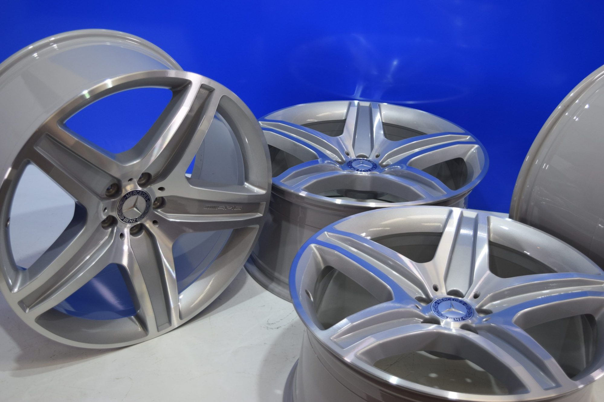

These are the wheels I’ve got for it. 21x10 with et37 from a 2011 GL63. The wheels on it now are the 20x9 AMG wheels that come with it. I’ll be using the 20” wheels for winter tires next year. These new 21’s will be my summer setup. They are at the tire shop right now getting 295/35r21 tires put on. I should have them on middle of the week hopefully. After that I’ll figure out how much I need to lower it. They are gunna be wide. It’s an aggressive offset. 10mm wider (further out) than an OEM ML63 wheel in 21x10.
Actually these are almost 20mm further out than OEM ML63 (21x10 et56) wheels. There will be quit a bit of poke. Lowering of course will help to reduce the poke to visually acceptable.
did they change the offset from the w164 ML63? My 2010 ML63 for sure had 20x10 et 46 from the factory. I assumed the w166 AMG 21x10 for the ML would be the same wheel. Interesting. I guess we will have to wait and see when I get them back from the tire shop tomorrow haha. Good thing I ordered mud flaps. I might have to do the Star lowering sooner than later because yeah it might look funny if it’s too high like you said. It’s already pretty low in sport mode so I’ve been waiting to get the tires before I start messing with the sensors.

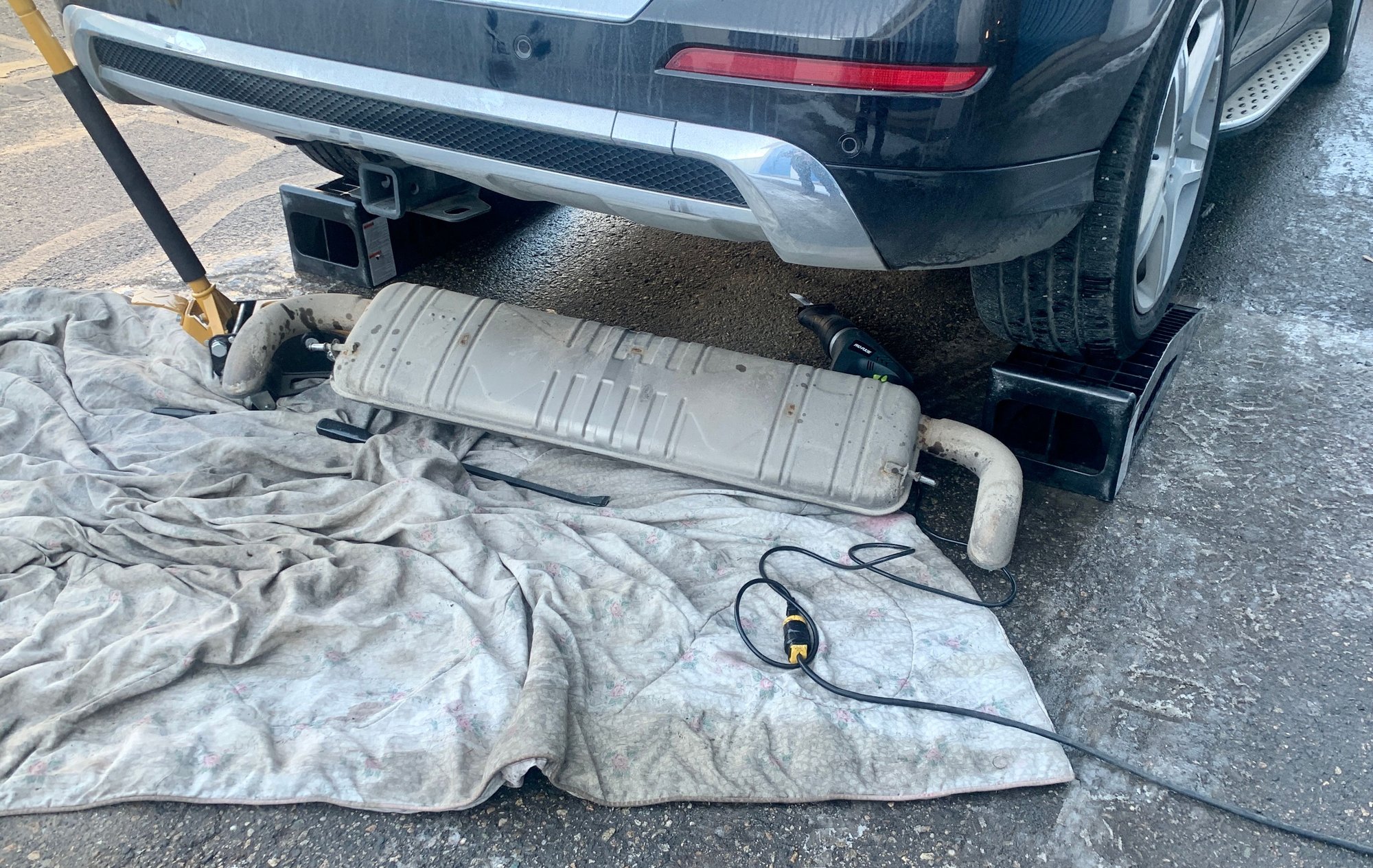

Muffler fell off all by itself I swear….. 🤷🏼‍♂️😂
Now it sounds like it should sound for a twin turbo V8.
Yes, all W166 ML63 have offset of et56 for 21x10 stock wheels. With GLE63 facelift, offset was reduced back to et46 for 21x10 because GLE63s have fender flares to "compensate".
Vs. stock 20x9 et57 wheel with 265/45-20 tire, 21x10 et37 wheel with 295/35-21 tire will be pushed out by 33mm. Because stock 20" wheel is seating too deep in the wheel well, the net "effect" will be poke of about 13mm (1/2"), because 21x10 with about et50 achieves close to 100% flush rear fitment. Front poke will be less pronounced. Usually lowering negates poke because when lowered, the top of the wheel/tire points "in".

https://www.1010tires.com/Tools/Whee...et-Calculator#
i find this website handy for calculating offsets. I’m definitely going to lower it probably an inch. I’ll get those carbon fibre AMG style fender flares if I have too. This is a w166 with the w164 ML63 version of my wheels 21x10 et46 with carbon flares. So my GL wheels will stick out 9mm further than these. Im assuming these are the ML wheels, but the concave does look deep like mine. So maybe they are GL wheels. Who knows. I’ll find out soon enough I guess. Hopefully I can put them on tomorrow.

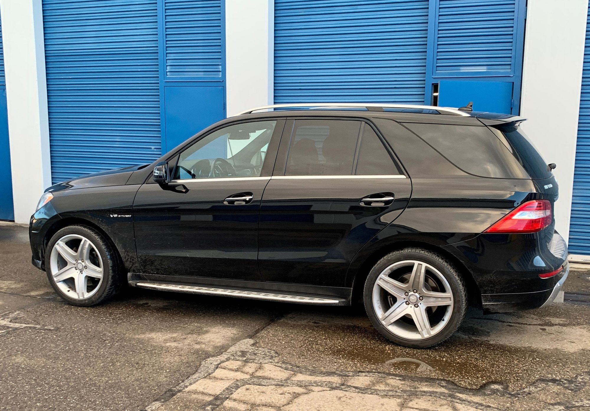

I use the same website as well. With fender flares, there is no need to worry about poke. You may not even need lowering.
Looking at the picture of your car I could not understand reference to ML550 while I'm looking at ML63... Of course I totally missed that you're in Canada and unlike the US, AMG package gets full ML63 bodywork. Yes for 63 bodywork with fender flares, high 30s offset for 10" wide wheels is non issue.
Old Feb 6, 2022 | 11:03 PM
Doubleredrolex's Avatar
Joined: Feb 2014
Posts: 97
Likes: 18
From: Canada
2014 ML550 AMG package
Yeah The only difference in Canada is that the ML63 front fenders are 1/2” wider than mine. The back is the same width. And I don’t have exhaust tips out the back like the ML63 does. But I’ll change that later in a couple years and upgrade to a GLE63 rear bumper and tail lights. Thanks for all the info. You sure know your stuff.

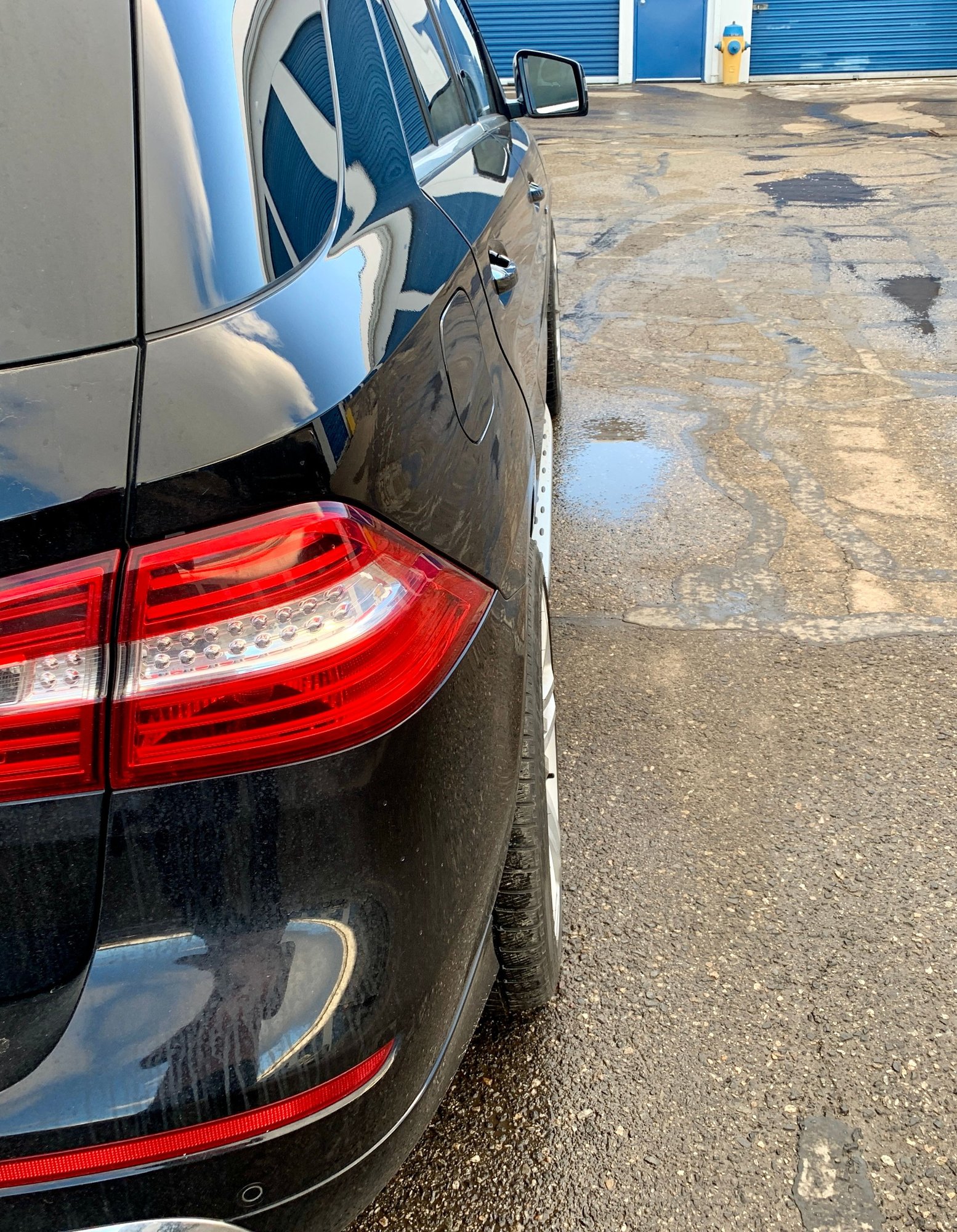

Well I got them on and they are pretty much flush with the outside of the body. Maybe 1/4” out but they look great. They don’t really stick out at all. Pretty happy with that. This is still stock ride height in Sport mode. I might bring it down and inch. Not sure yet.
21x10 et37
295/35r21 Pirelli
Old Feb 8, 2022 | 12:46 AM
Great to hear that the Morimotos are working nicely, I was considering these exact ones for my 2014 with OE bulbs. Any more detail on where I can find the light adjusters? Sounds like something I would want to do
Old Feb 8, 2022 | 01:10 AM
Joined: Feb 2014
Posts: 97
Likes: 18
From: Canada
if you open the hood and right above the headlight you will see about a 1” diameter hole in the metal radiator support bar that goes all the way across from fender to fender.
If you look down in that hole there’s a little white screw thing. That’s the headlight up and down adjustment screw. You need a long 6mm Allen key. Counter clockwise is headlight aiming up. I went exactly 1.5 turns counter clockwise and it’s perfect. I circled them in red. Don’t turn them more than a couple turns because you can derail the adjusters. Two turns max I would suggest.
