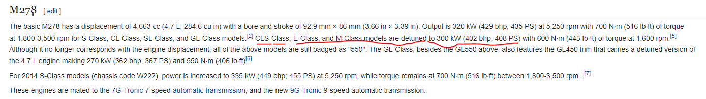

Power Output ML550 M278 Engine 300Kw & 320Kw
I've seen engine outputs for the 4.7Ltr twin turbo engine at 300kw (402 hp and 443 Ib ft) and then an upgraded number at 320Kw and 700Nm (429 hp and 516 Ib ft). Does anyone know if the engines are in fact different and what the difference is? I've read that 300kw specification is in fact MB under quoting the output in earlier models and they're all 320Kw.

That is from the Wikipedia link for the M278 https://en.wikipedia.org/wiki/Mercedes-Benz_M278_engine
