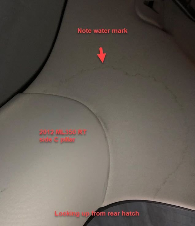

We had this issue with our 2012 ML350 Bluetec. We have not yet had the recall done. In checking out the rear of the vehicle, I did notice this water stain on the interior headliner and D-pillar on the passenger side. I am wondering if this is indicative of where water may be coming from.
Right side D-pillar water leak.
We did have the vehicle cut out once when driving the the rain last fall. Pulled over and sar for a few minutes, then it was fine and we drove off.
100%.
My guess is that kind of water leak at the top must be water coming through where two metal panels overlap. Any body work done on your vehicle?
