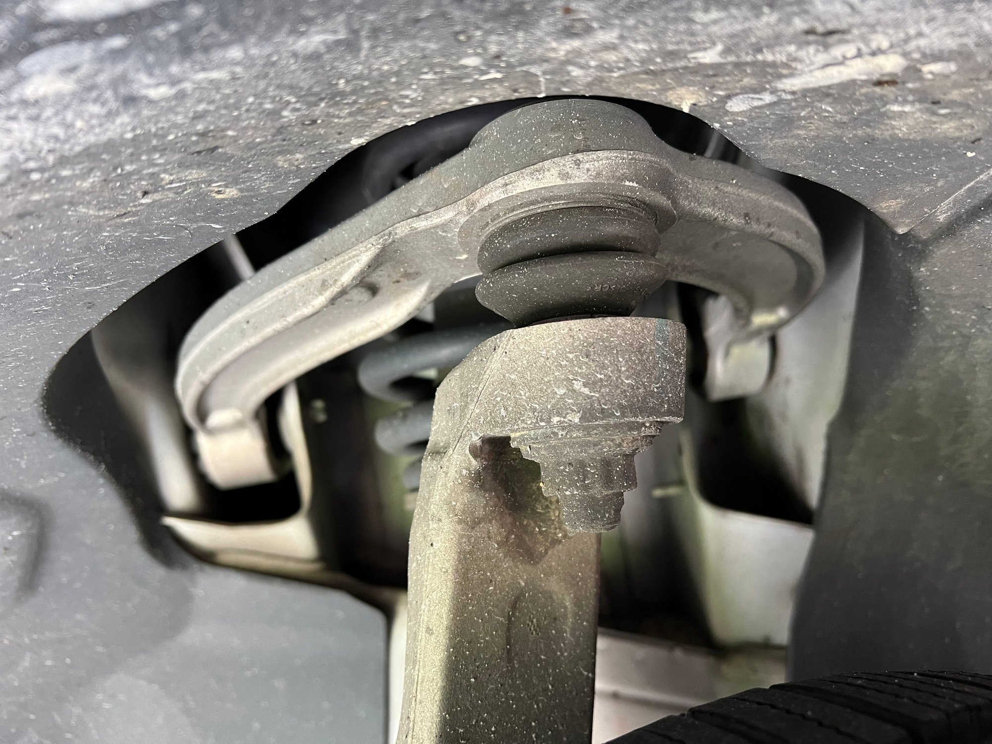

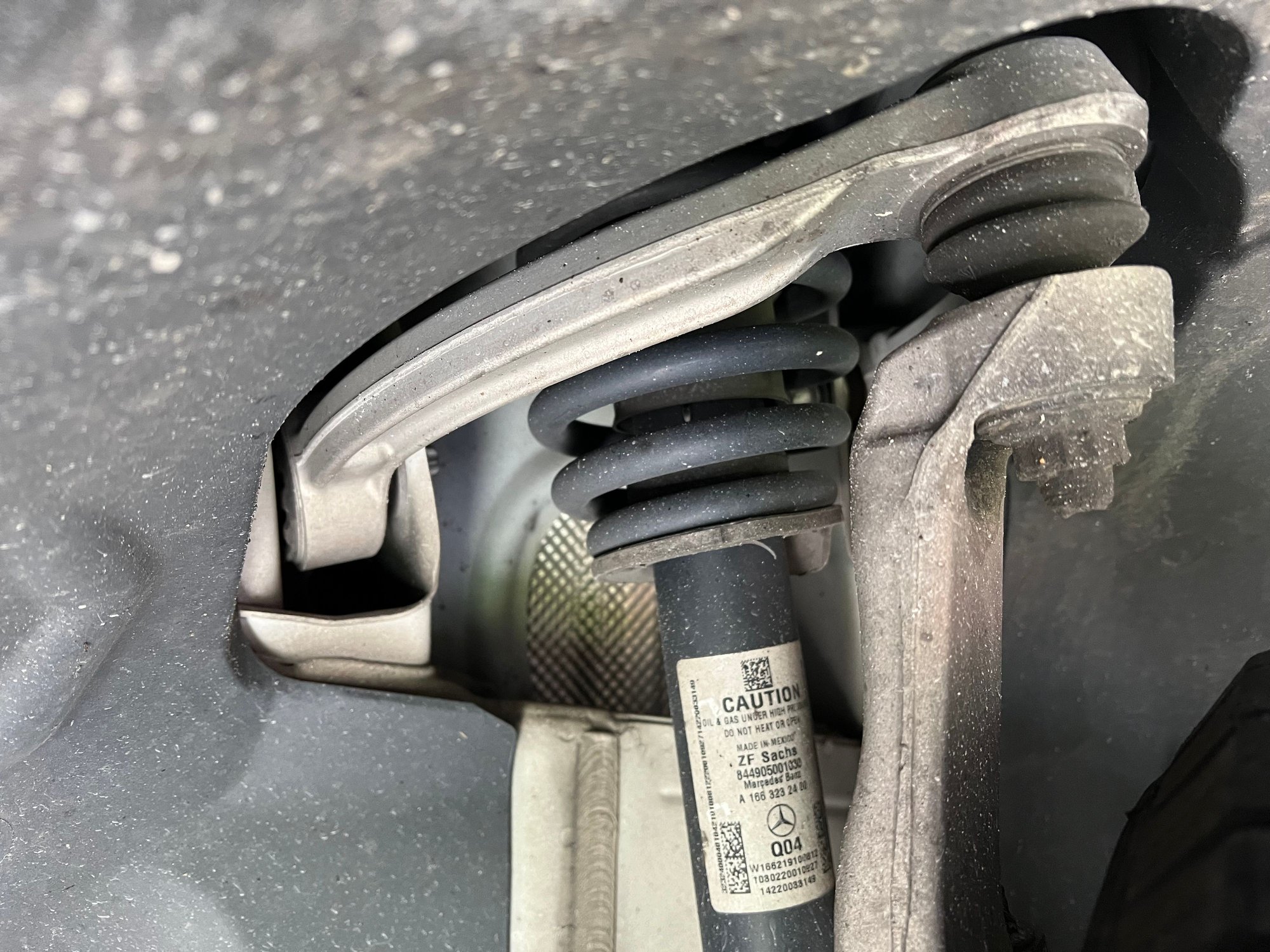

This is probably "good" news.
I took a look underneath. Looks like coil shocks to me. No air suspension.
Next, I had my wife bounce on the running board to see if I could isolate the sound. In the picture of the front suspension below, there is a large rubber piece at the apex of the wishbone. To me, it seems that the sound is coming from there, but it's hard to tell. Susan said that it might be at the legs of the wishbone.
It seems that things are in pretty good shape; nothing heinous to my eye. And hopefully it's just a minor repair.
Any thoughts on this?

Take a can of silicone spray with the straw attached, and spray some in at the bushings at the 2 inner attachment points (not the ball joint boot). Bounce it a few times to work it in and see if that helps.
Old May 14, 2023 | 11:32 AM
Leetom's Avatar
Joined: Jan 2013
Posts: 190
Likes: 76
2013 ML550 US spec. Air+Offroad pkg
Dont use petrolium products like WD40...can deteriorate the rubber. Use silicone spray. I get at Home Depot.

@Leetom , I got the spray and hit those points pretty well while at the auto parts shop. I thought it calmed things down, but after getting home and fairly slathering those two spots again -- on both left and right front -- the noise is still there. Maybe just a touch quieter, but still quite there.
To be clear, as I'm looking at the pictures above, there is a large, single, double-lipped boot sort of rubber thing at the head of the wishbone, and rubber parts on the left and right of each of the two attachment points that are inboard. I hit both of the two attachment points.
Is that correct? And I'm not to hit the large double-lipped boot? It seemed to me that this boot is where the sound is coming from.
I'm torn at this point. I'd love to avoid the dealership, if possible, but as I'm sensitive to noises, this will drive me nuts if I don't fix it or have it fixed. We audiophiles are a touchy lot.

You do not have air suspension. This is confirmed both by the photo you posted and the VIN, thanks for providing it.
The "wishbone" item you are evaluating is the upper control arm. The "inner two legs" which you lubed contain rubber pivot bushings. The double-lipped item is the upper ball joint. It is not unheard of for upper control arms to go bad; they are wear items. The dealer will know if this is the source of your issues. My gut is telling my that the stabilizer bar bushings or links might be the problem, but I am not there to see/hear and the dealer will identify this for you.

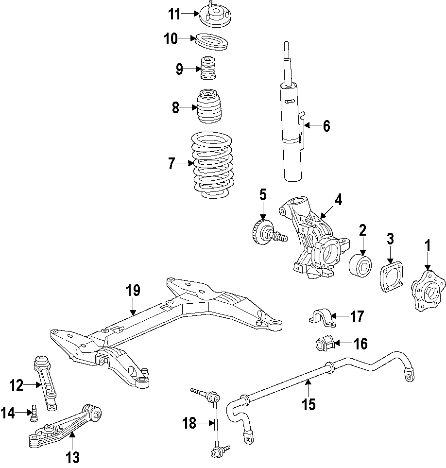

First image: Porsche 991 front MacPherson strut suspension. Note the strut is joined to the knuckle (wheel carrier, hub carrier) with two brackets or clamps. The spring is mounted to the strut. A strut delivers a kinematic function and reacts both forces and (overturning) moments.
Second image: Porsche 991 front suspension diagram from a Porsche dealer parts shopping platform.

Originally Posted by chassis
@RobH739
Well, based on your input we've decided to do the dealership. Too bad... I thought that if the silicone fixed the issue, we'd cancel the appointment and get a ride in on the local trails. I guess I'll be adulting tomorrow, instead.
My sense is that something has gone bad, and I'd rather deal with it now than on a long road trip.
This car has been pretty reliable, with the exception of a pretty bad coolant leak and a mysterious sudden-lack-of-acceleration issue that would come and go. Fortunately, neither has happened in quite some time, so I think those issues have been addressed.
Old May 14, 2023 | 06:56 PM
Leetom's Avatar
Joined: Jan 2013
Posts: 190
Likes: 76
As said above, the front folded boot is the upper ball joint. I dont believe there is any grease zerk on these to inject grease inside to the ball joint. Spraying the boot wont do anything for your squeek. If it IS the joint, it would need to be pressed out and new one pressed in. As Chassis said, may need to get a mechanic in there to pin down the squeek to figure out next move. If sway bar bushings, they are not terribly hard to replace.
