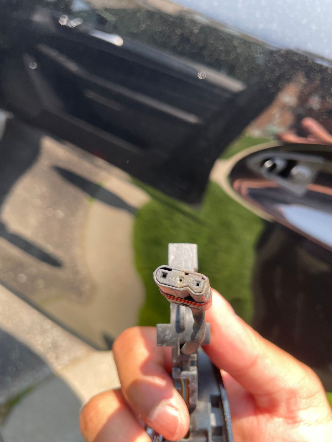

So I went ahead and removed the rear door handle, the connector had a good amount of corrosion on it.... see pic below. Tried cleaning it but no luck. Now we have a bigger issue, I swapped the driver side front handle onto the rear to narrow down the issue to the actual handle, and that worked. But now when I put the "working" front door handle back on the front door, it no longer works...

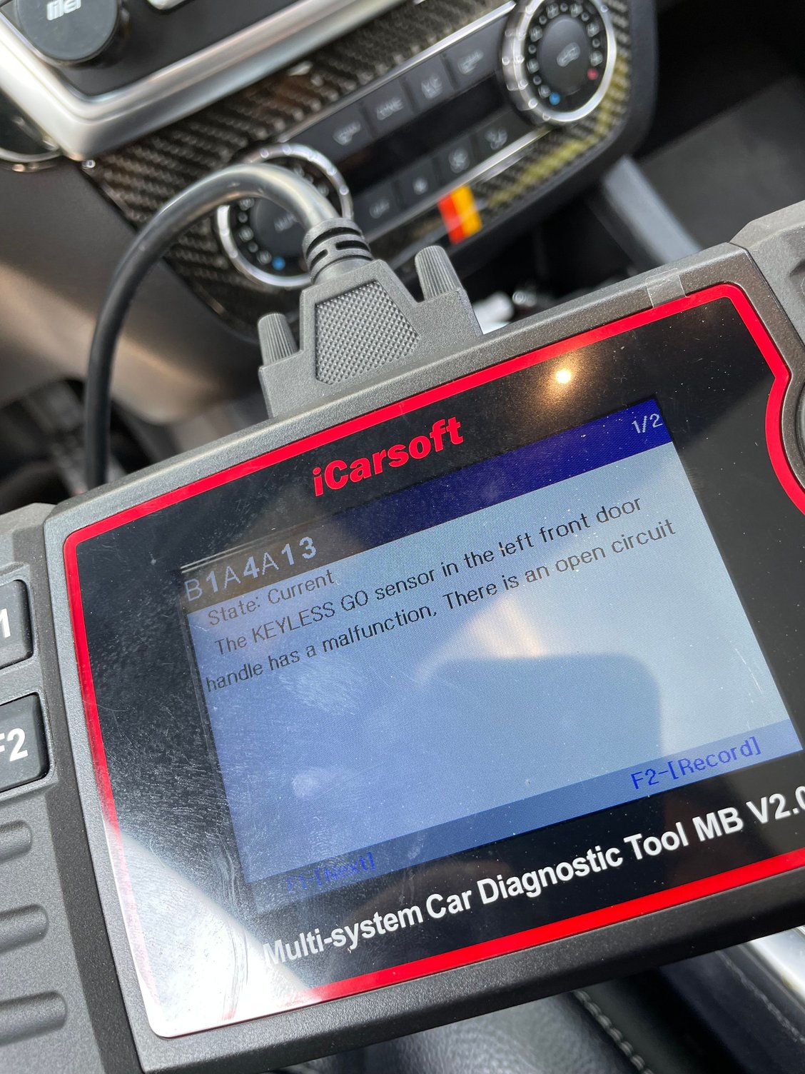

I have two codes now that say there is a door handle fault for both driver side front and rear door, did I just ruin my front door handle too....
