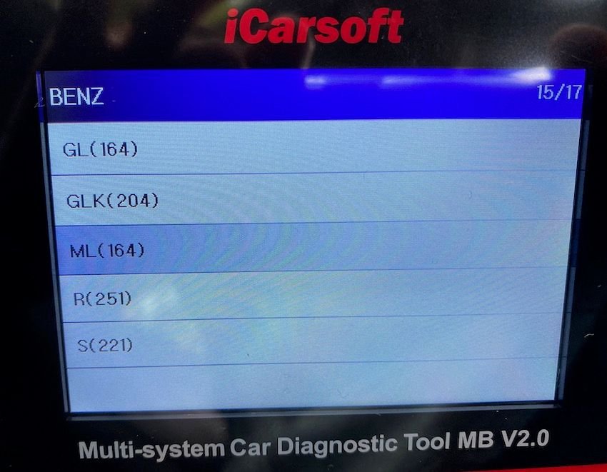

Hello. I purchased the icarsoft MB V2.0 as I’m interested in the "DPF % Full" feature that I expected to see.
Unfortunately I cannot find the DPF % Full feature. I see 11 items that do not include the DPF % Full item.
Does anyone know where or how I can access that data item?
Attached are some screen shots of what I can see.I did also expect to see a I see DPF % Full number.
I figure the numbers shown are healthy as I had the car on the open road for 4 hours and the Ash is 0 grams and I see the Soot is at 6.29 grams.
Not sure how to interpret these numbers. Comments welcome.

SO DISAPPOINTED. IF ONLY icarsoft WERE UPFRONT & RESPONSIVE.
AN UPDATE: SO DISAPPOINTED. IF ONLY ICARSOFT WERE UPFRONT & RESPONSIVE.
It's impossible to find what DPF Functions are available on the W166 ML350 before purchasing and the icarsoft. After I bought, the MB V2.0 USA Headquarters / Sales Engineer / Order Center did respond stating to update SW (I did) and send the log files (I did). Since then, icarsoft support has not responded to any of my questions about what DPF functions will not work on the W166 ML350 Bluetec.
I was recently told (locally here in Sydney) that the icarsoft MB V2.0 does not support "DPF Regeneration" OR "DPF % Full". After VIN Numbers and Version numbers the local Sydney people said: "Apologies MB V2.0 can't do DPF function for this car". It does provide a reading for Ash and Soot in Grams - but that's it. Nothing more.
Very disappointed in the tool and service from icarsoft.
ICARSOFT - YOUR WELCOME TO RESPOND AND I WOULD BE VERY HAPPY TO CHANGE MY MIND ABOUT THE PRODUCT AND SERVICE.
W166 is missing from the DPF Regeneration Page / List. Many Mercedes may be missing.

Did you ever get a solution
I fell for the same scam, they state it works in later Mercedes models, but they don't state it works on everything but w166
Talking to their support team is a dead end.

Reviving this old thread if anyone is using a iCarSoft MBII reader. I scanned my w166 this weekend and it tells me DPF is 84.43% full. Despite a menu option for it, the DPF regen doesn't seem to do anything. I'm about to go on a trip of about 7 hours, so I thought I'd monitor the DPF along the way and hope it regens.

I have the same reader and regen doesn't work. Regen should start automatically once you reach 100% and you will be able to tell either by looking at the temperatures or a slightly elevated idle (800 vs 750 rpm). Don't know about DPF cleaners but if you are in USA/Canada you should be entitled to a replacement DPF among other equipment as part of the respective Bluetec settlements.
