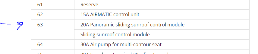

Lube + Fuse
Let me add that what kills the fuse is the high torque from high friction.
The MB roof requires maintenance in the form of lubrication.
I don't particularly know the pano roof... only sunroof with its spring-like gear drive and soft-gear motor that dislikes high friction.
