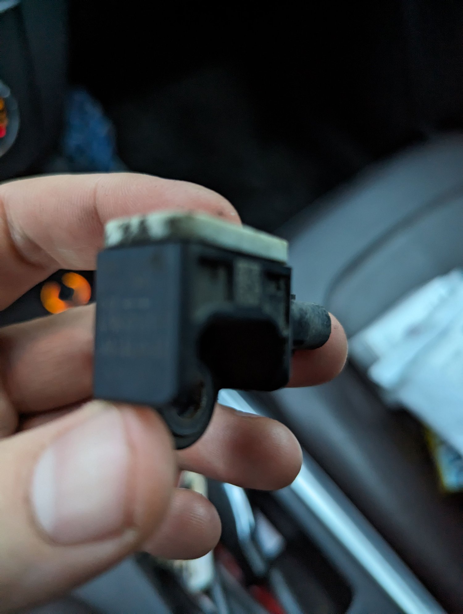

Problem #1: SRS red light appeared and is now permanently on. According to my Autel scanner, the code is for the front right impact sensor (see pictures). I ordered one from eBay with the same part number and everything. I installed it and cleared the code but the problem still persists. The wires all look good so I'm not sure what is going on.

Original/defective crash/impact sensor.

Managed to solve the SRS problem. Turns out that my old sensor was good because the problem was with the wiring. I put my suv on the lift and noticed something wrong with the wiring underneath the vehicle. The wire was heavily damaged so I changed it and cleared the SRS code. Voila! Problem fixed. My guess is that, over time, the road salts during winter and all the other crap corroded the wire (I live in eastern Ontario Canada).
If you ever get this problem, check the wiring of the crash sensor that goes underneath the suv first before ordering a new sensor!
