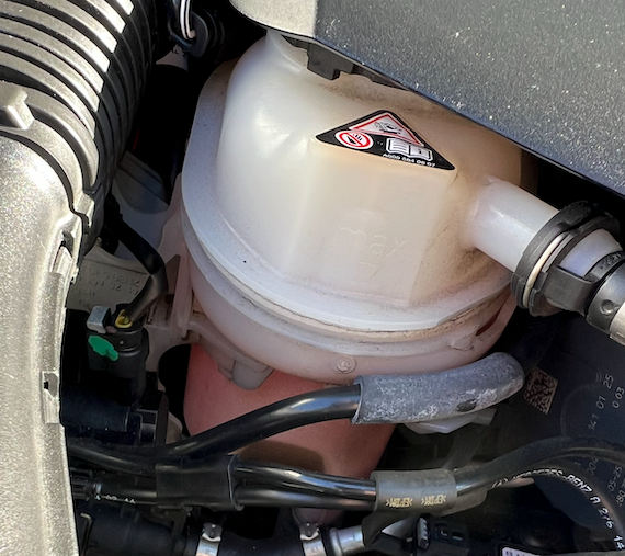

Took another look and, low and behold, we have two reservoirs! Whoda thunk that? And, in the one that has the level sensor, the coolant level is actually low.

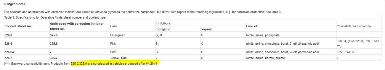

keep in mind color can be coolant brand-dependent; therefore, focus on the specs. You have a newer than 04/2014 car, so
325.6 Antifreeze or 326.6 Premixed
https://operatingfluids.mercedes-benz.com/sheet/325.6/en
https://operatingfluids.mercedes-benz.com/sheet/326.6/en
and check the table. 325.0 should no be used for car made after 04/2014 --> Your is 2015
Old Dec 22, 2023 | 04:56 PM
eddieo45's Avatar
Joined: Feb 2004
Posts: 3,122
Likes: 222
From: Milton/Westport, MA USA
me: 2015 SL400 & 2015 ML400; wife: 2022 GLC Coupe; daughter: 2017 GLC SUV
I guess I miss by 7-8 months!

Old Dec 24, 2023 | 12:02 AM
cparke's Avatar
Joined: Sep 2021
Posts: 13
2019 GLE400 (W166)
Where is the full marker?
I have a 2019 GLE400 (which is also W166 and I think is very similar or the same these older M-class models, actually the very end of the W166).
In your photo, how do you know the coolant level is low? I only see a unlabeled white level bar on the outside of the main coolant tank, but I don't know if that indicates a low level marker or full level marker. Is there really some kind of full marker inside the tank as I've read here that I can see only when I take off the cap?
As others have reported here, I am getting Low Coolant warning when the car is turned on each morning, and it goes away after some driving and stays off the rest of the day. However, coolant expansion tanks both seem full even before the morning first starting, if I am reading the white line correctly as a minimum level indicator
The MB diagnostic code for this error is in SAM module as P25567B, but unfortunately that code doesn't tell me anything different besides the what the instrument cluster is saying --- Low Coolant Level!
From what I've read here, there is no coolant level sensor of any kind in the secondary expansion tank (and the error always relates to the primary expansion tank only)? For my model, I also can't seem to find any coolant level sensor on either expansion tank, nor in the parts diagram. How can the car know the coolant level without a sensor there?
Old Dec 24, 2023 | 04:12 AM
regclown124's Avatar
Joined: Apr 2021
Posts: 16
2015 ML350
Park the car on a level surface and let it cool down completely. Slowly open the reservoir cap and look inside. Coolant should be just below the black line.
Old Dec 24, 2023 | 12:47 PM
cparke's Avatar
Joined: Sep 2021
Posts: 13
2019 GLE400 (W166)
Yes, upon realization that coolant needs to be up to the black for the tank to be considered full, and that the white bar on the outside of the coolant expansion tank is actually a MIN level marker, I added more coolant and the indicator instantly went off!
Thank you for the clarifications

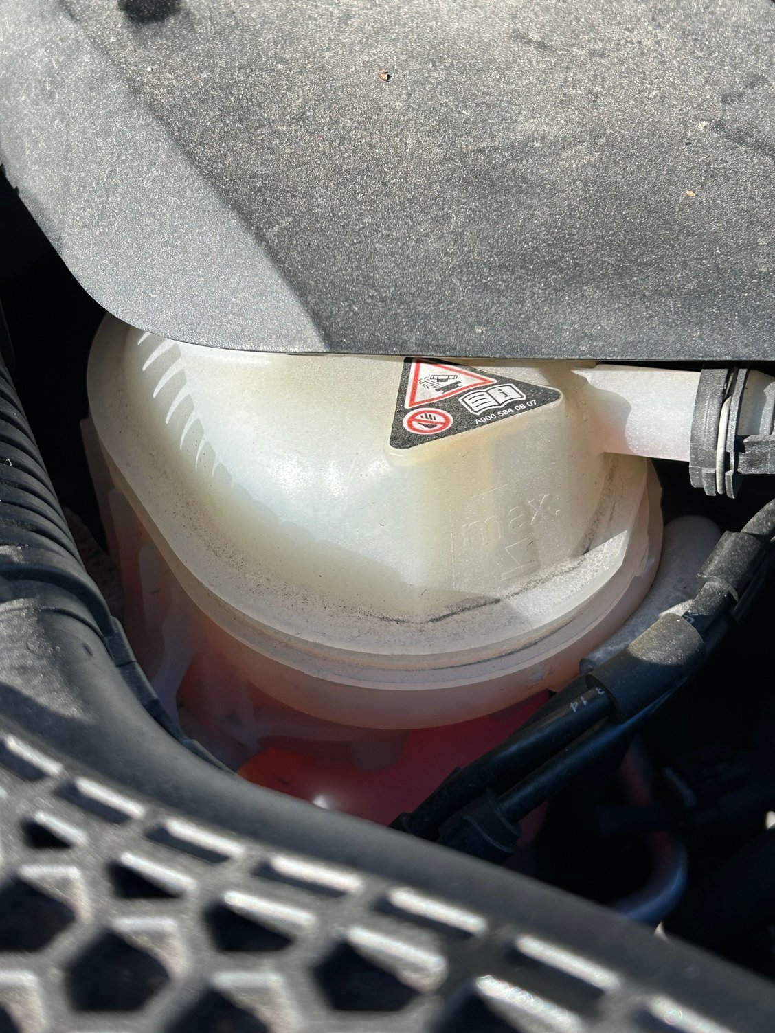

Old Jan 10, 2025 | 10:35 AM
eddieo45's Avatar
Joined: Feb 2004
Posts: 3,122
Likes: 222
mine looks different than yours but also a bit low, and likely the reason the alert has returned with the cold weather.
