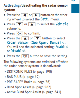

I am sure you've read the owner manual to guide you through the dashboard menus to enable these options, yes?

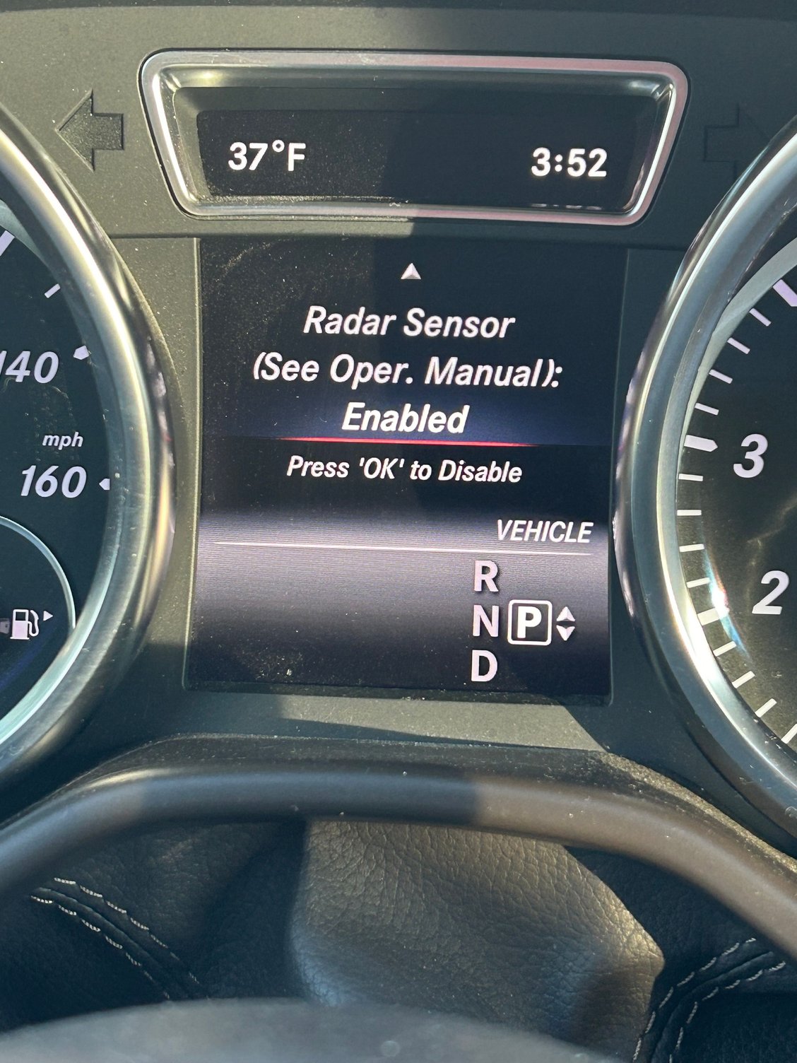

So if I don’t have pre-safe braking (I don’t have Distronic) what does Radar Sensor do? Just the blind spot??

"Blind Spot" warnings from rear side corners
The "Active BS" option allows the car to avoid collision by combining brakes + steering... I've experienced that once, very effective and welcome intervention.
