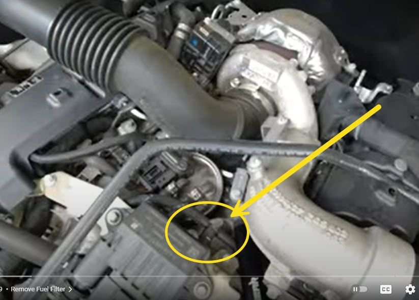

Broke this part - I believe it is part of the return fuel line on my wife's ML350 Bluetec - - I've searched diagrams for hours and cannot figure the part out. It is a T that connects the fuel lines
note - I stole the pic from a you-tube - her car isn't nearly this bad.
I also included 2 pics from a later model Sprinter which has the exact same T - but in a slightly different location.
Anyhelp finding the part would be greatly appreciated. - - Note I also saw a video with a Bluetec that had a metal T - - was wondering if that was Standard or generic

Still haven't found the exact part, but found out it is part of the Return fuel line or as Mercedes calls it the "leak oil line". I'm going ahead and replacing the entire line since I can get a Bosch one for about $45
I just dread taking those dang Air Filters off again!!!
