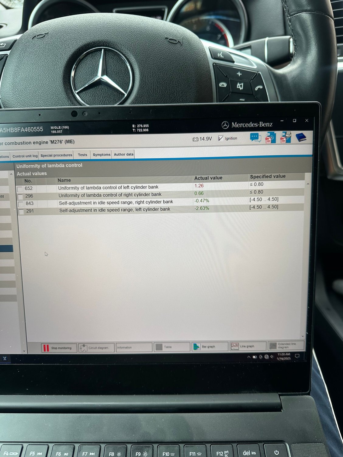

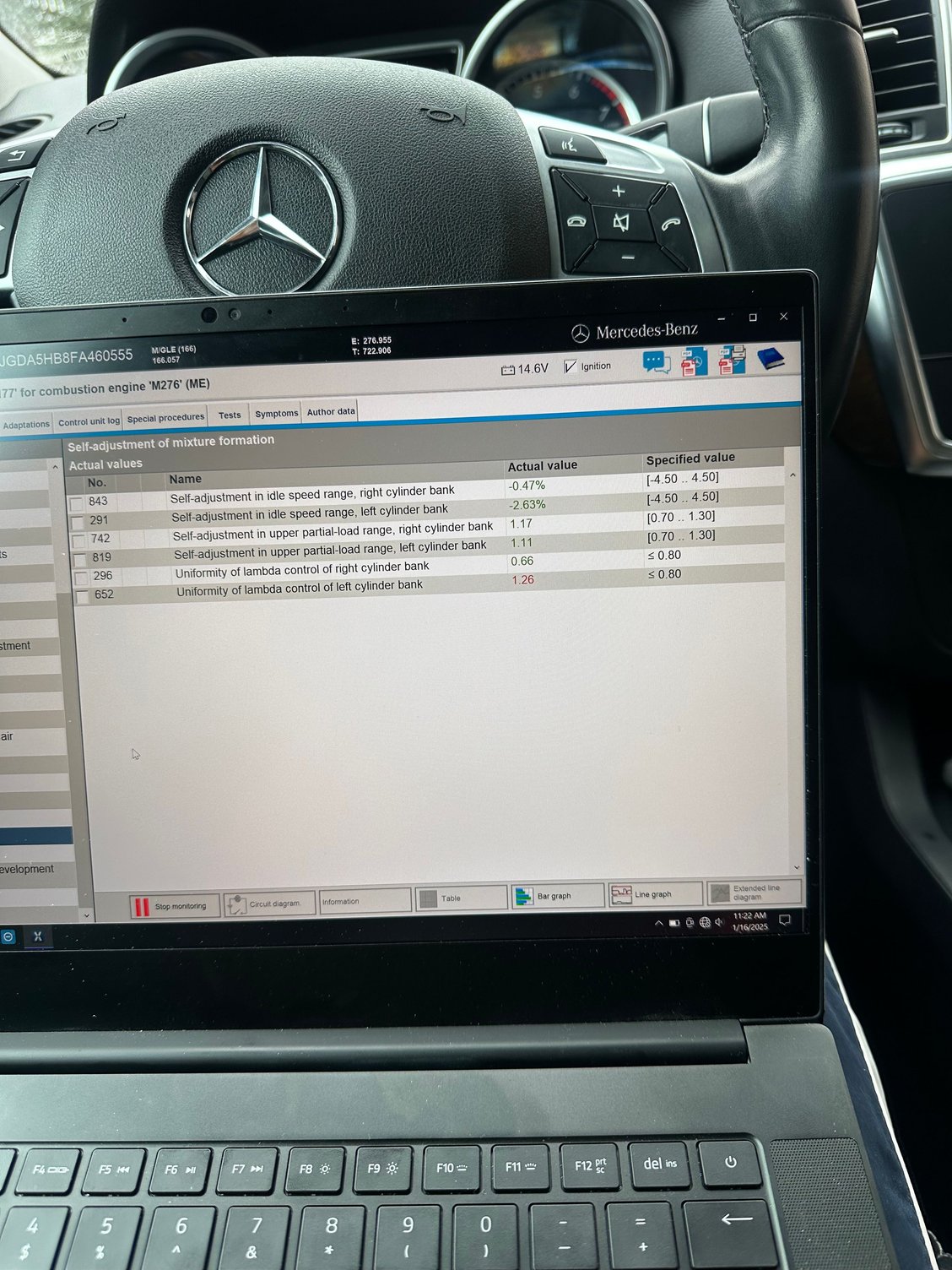

quick update guys i cleaned cam sensors and all the following sensors o2 sensors right bank and left bank cleaned the ecu connector but i started the car and misfire still stays and seems to only happen on idle i was checking smooth running of combustion engine on xentry and fault counter said misfires only happen on cylinder 5 on idle when the car is at a cold start and when driving it smoothens out one more thing that i noticed that uniformity of lambda right bank and left bank were both red but after i cleaned them the right bank became green but the uniformity on left one is still red the weird thing is that i did not even find oil on left bank lambda i found oil only on right side lambda and after cleaning it became green so conclusion i couldn’t get the car to idle normally even after cleaning so i dont know if its worth giving a try to change sensors yet now im thinking of changing the ecu i already got a replacement ecu from donor gle i just need to clone it im thinking that would fix it if it doesnt i dont know what to do next if just cleaning would fix the issue i would be changing all magnets, all camshaft position sensors but u dont want to throw money for no reason i also checked all fuses on engine none were bad i have a question for you guys can you guys help me find shop that could clone my ecu for cheap or some other way i could do it myself but im not going to dealership and giving them thousands of dollars. please let me know!

Thats where im at right now i changed all four camshaft solenoids they had very less oil in them still changed them ordered camshaft position sensors which are the ones that supplied oil into the harness gonna clean the harness and see how it goes from my research uniformity of lambda can be thrown off by camshaft position sensors im hoping its that mechanic told me my ecu is cooked got that changed too what did you end up doing with your car.
