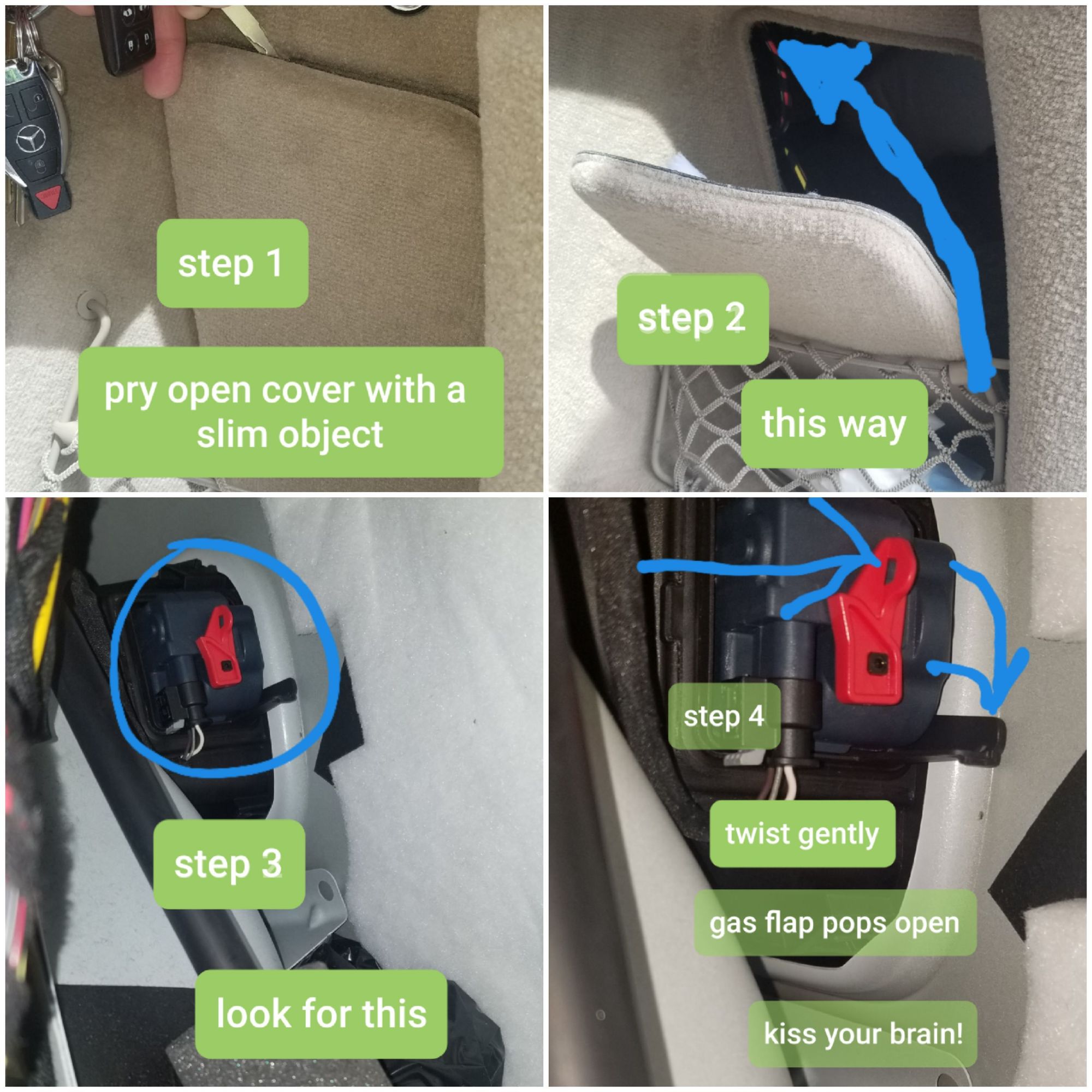

Handy manual fuel door aid
Originally Posted by gebhardtsbauerp
Hi everybody. I went to refuel this afternoon, and was surprised to find that the fuel cover door will not open. Has anyone else run into this? Key is turned off, I push the door to activate the release mechanism, I hear its usual screech, but the door doesn’t pop open. I know the circuit is energized, and I figure that the controller is working because I hear it screech. It just won’t release the latch. I began to hear the screech two years ago after I had work done to locate a leak inside the cabin. The repairman replaced the plastic shield around the gas tank refill tube (bilked the extended warranty quite a lot but didn’t solve the leak), and it squealed/screeched ever since.
So I’m about to run out of gas and can’t refill. Anybody know how to open the door manually?
ML350 W166 manual fuel door opening aid
Made this for the wife...

Thread update, and Love the graphics!
cblyseth, Thanks for the photos! You must have a great camera - they’re really clear.
THREAD UPDATE: Found the source of screech. Looks like MB used a nylon gear on the door latch, and the screech was the teeth being ground off. So now the only was to open it is manually, until I get it repaired.
