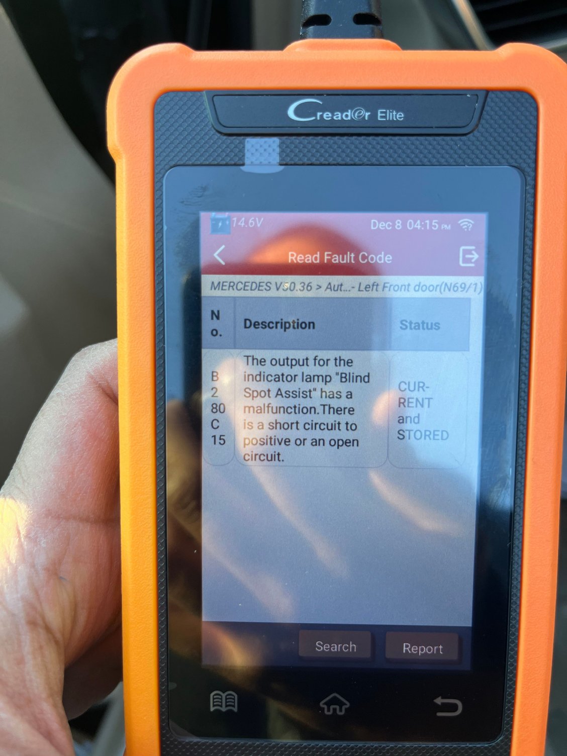

Thank much. I have included the error code below in the picture. The blind spot is not working and it says Pre-Safe is limited/inoperative. Distronic cruise control is also not working, despite me cleaning the front of the car.

From your "advanced" scanner picture I will start with the yellow/red LED from the left mirror
