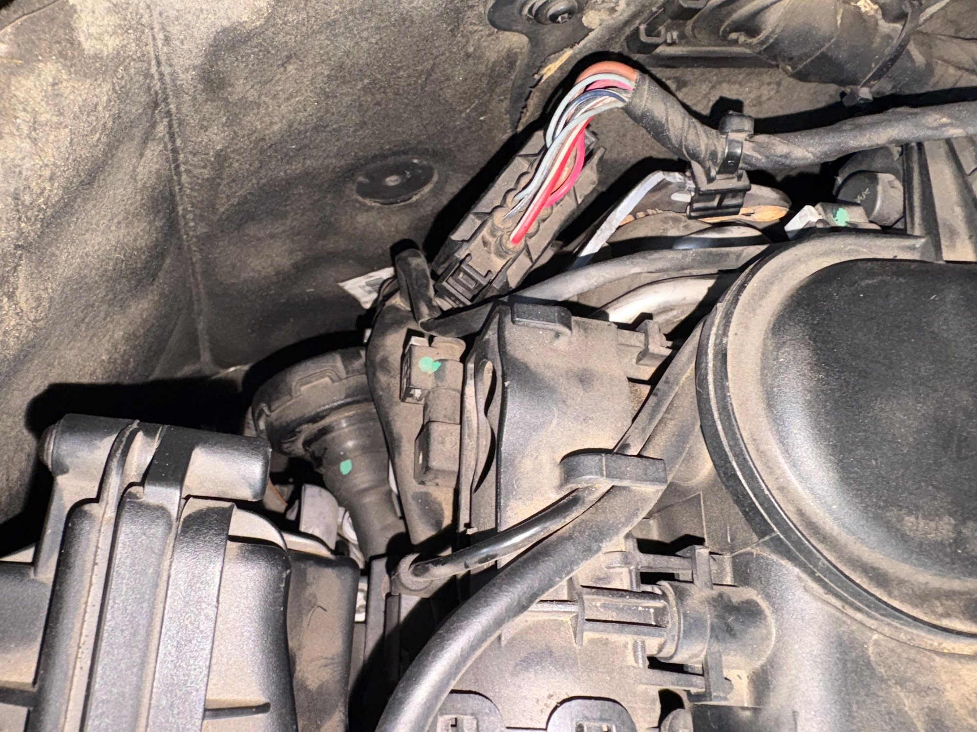

I’m trying to replace the pcv valve on my 2014 ML350. Do I have to remove the crash plate. I was expecting it to be flush to the back of the motor but not covered. I see why I was quoted $600+ at the mechanic for replacement

yes, that and a few more parts need to come off...
  1. the air filter
  2. the air intake
  3. the fuel pump + roller
  4. the PCV discharge conduit
