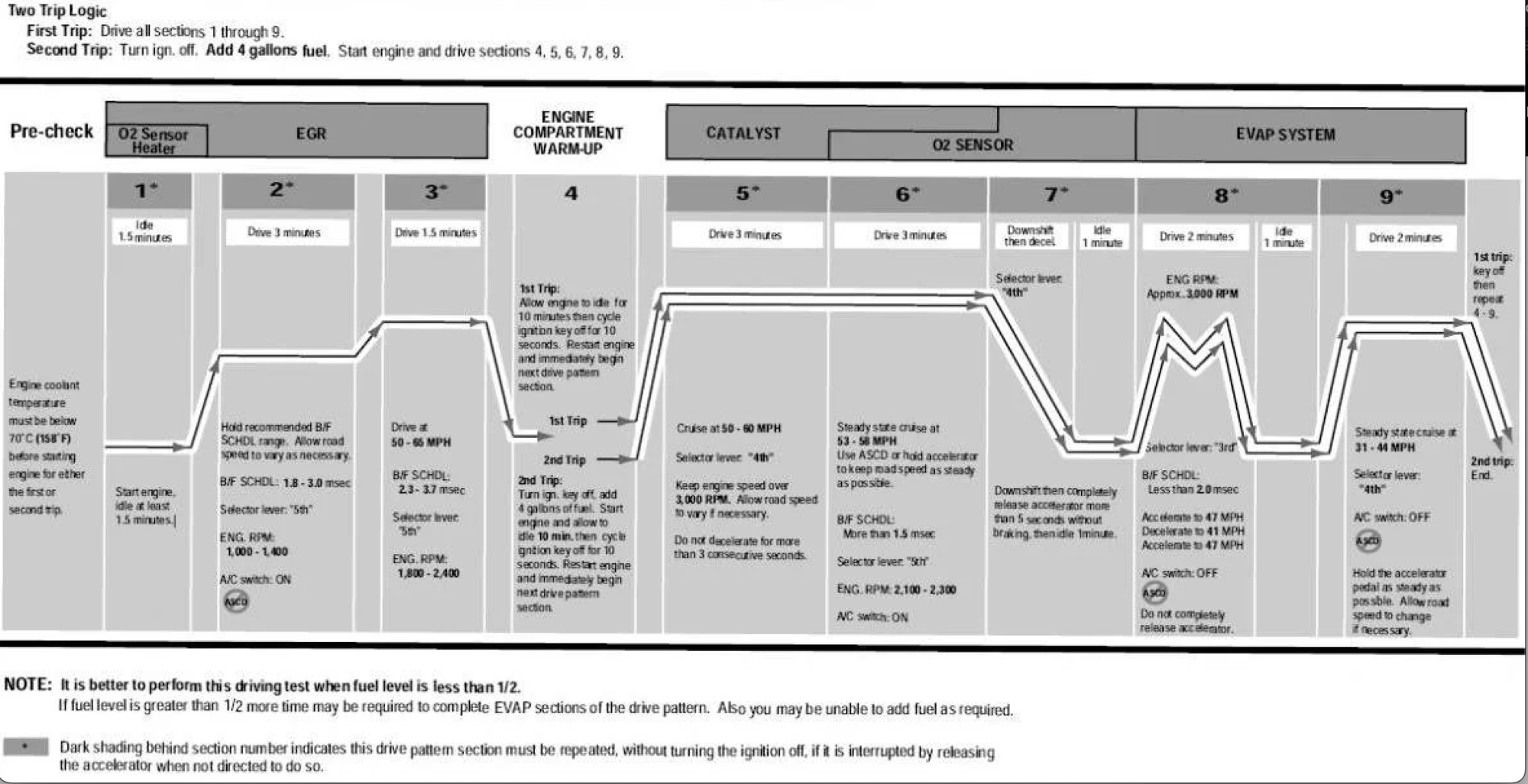

3. Got the attached Drive Cycle from wife's indy mechanic and drove it 7-8 times following the directions very closely. (Yes I realize it's for a BMW but he said it is what he uses for MB too). Every time I've done this ALL the monitors set EXCEPT O2 Sensor.

7. Oct 10: Self-replaced all four O2 sensors, ran drive cycle day after. O2 sensor check still not testing.
Spoke with MB Service manager and she said she had seen this before and replacing O2 sensors fixed it. Maybe I just need to do a few more cycles?
I've seen a few other drive cycles, one from the attached MB service bulletin that appears to be for older cars (and I did try that one before without success), and another one that is attached that I haven't performed yet. Has anyone with a W166 had any luck with these things?

1. Drive cycle performed many times (recommended by indy mech, pic with thumb in it)
2. MB Service Bulleting Drive Cycle (Done several times)
3. Unperformed drive cycle (Should I try this)
