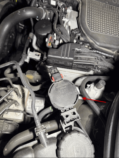

I got P0442 evap system small leak check engine light, so far, clean the gas cap and surrounding, drives few days. and the code is still remain, so I went ahead to order replacement gas cap. start drive and code still remains, do I have to clear the code or just start to drive to see what happened? Guess my next step if code is still remain is located where is the purge valve under the hood, I don't know where is it located under hood? of course I know there is a lots of possibilities, few pipes and connection and canister valve area. Attached is the photo of under hood, please anyone can help to identify where is it? also anyone can give me some advice or ideas?

just found where is the purge valve is on my 2015 ML 350 , the part number is OEM 0014760532 Vapor Canister Purge Valve for Mercedes-Benz, and there is earlier part #000-476-06-00 and 000-476-06-00-64 were back order in some MB site, and I found one at https://www.pelicanparts.com/ for $57. Attached is the location under the hood. I will update everyone once I replace it.
