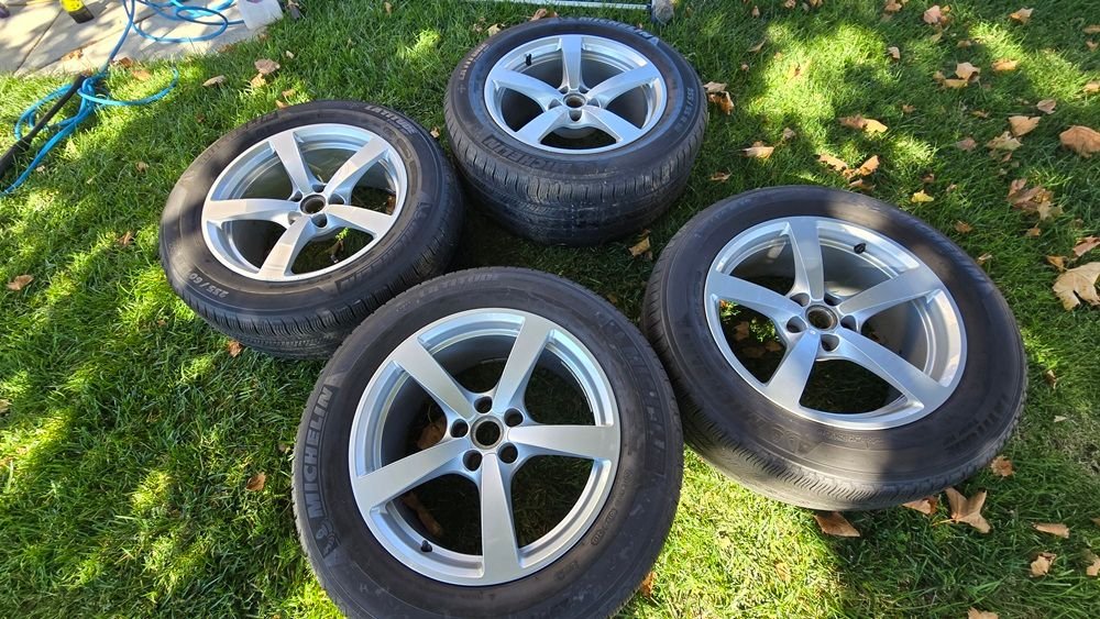

anyone do staggered wheel setups on their ML
I was looking for 5 x 112 wheels on marketplace when i came across a good deal on a wheel/tire setup.... i purchased them, took them home, cleaned an waxed them and was admiring them when i realized it was a staggered setup...front tires are 235/60-18 (29.1" dia) and rears are 255/55-18 (19.0" dia)....i read up that it's possible as long as you dont exeed 1-3% height difference...the difference is .35 percent which is within tolerance....I'm curious if anyone has done staggered setups and your experience with it....thanks...fred

I stood the tires side by side and height looks identical and the only difference was the width...

The wheels you have on your ML look way better.
check the load rating and offset before you go much further.
