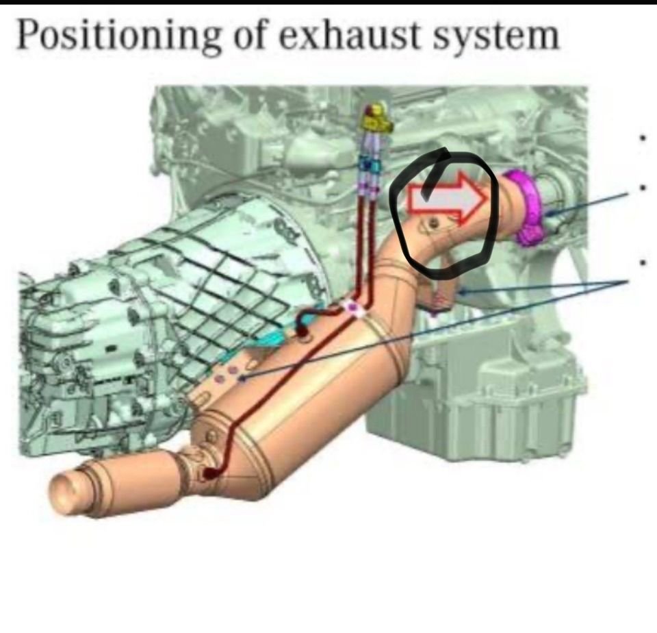

Hey guys, Been getting this code for a month now, clear it and comes back every time. Where is this sensor located on the car? I can't find any pics online for the OM651 engine

Have you looked for it yet where I suggested. If you clear it and it comes back there is an issue with it. You either need to try replacing the O2 sensor or check the wiring to it.

Try looking here on your exhaust system after the turbo.

Thanks mate found it
What a **** spot though, it's right next to the chassis leg so barely any room to fit tools plus air box is on top
I'll figure out sometime how to remove it lol

***Update*** It ended up being the O2 sensor, one of the wires was a bit torn as it had torn through the main grey casing through to the wire casings All fixed now
