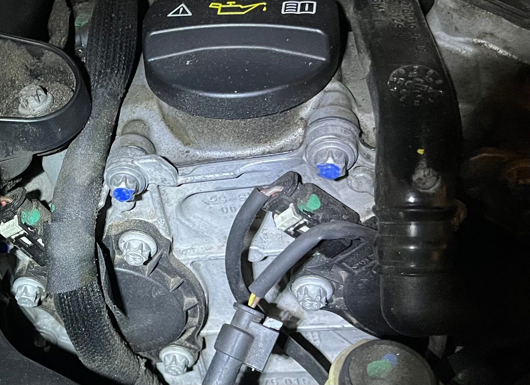

Oil in Harnesses-Fixed?
I’ve been reading about the oil in harness issue, and noticed my harnesses for camshaft solenoids and camshaft position sensors seem to have breaks in the outer jacket, near the connectors.
Did Mercedes already make changes in my 2014 ML350 to prevent this destructive phenomenon?
I don’t see how oil would get pumped through this type of harness, with the breaks in there….

Old Dec 13, 2025 | 08:44 AM
Leetom's Avatar
Joined: Jan 2013
Posts: 190
Likes: 76
2013 ML550 US spec. Air+Offroad pkg
The oil actually gets in and travels via capillary action inside the wire between strands and the insulation, not the jacket. Pull connectors off and look inside those for oil.
