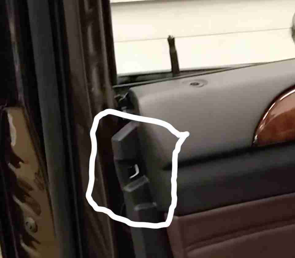

Door panel removal
What is the trick to removing this plastic plug?

It is a two piece fastener. Remove the center section, rotate it and reinsert it. When reinserting the main fastener is release allowing door panel removal. Search my posts in the GLE section, there might be WIS for this.

That did it, had to mill down some extra square stock to a loose 7mm to turn it.
But got the front 6.5" speakers changed
